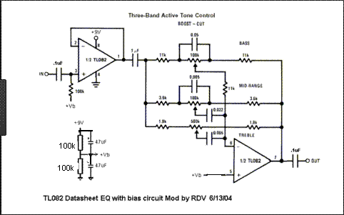

A simple baxandall application.
This same tone control is found in a lot of popular equipment. It's simple and it works great.
For single ended operation, the non-inverting (+) input will have to be connected to a"virtual" ground that is half the supply voltage. This "ground" must be QUIET because any noise will be directly injected into the signal. This can be accomplished with a few resistors and a capacitor. In and out will have to be cap coupled too.

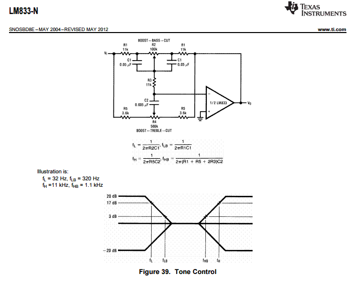

The LM833-N appears to be a neat project but I would need a little guidance on the specifics of the virtual ground. (I'm not an engineer but can follow a schematic) If I were to build one, I would be using a 12 v.d.c. LiPo battery with a voltage variance of 10.5/12.6 volts. (Hi/Lo Limits) Also, the values of the coupling capacitors..

It's easy, my dear. Put a 100K resistor in parallel to a 100µF 10 or 16V. Make a second net identical to the first. Then wire both in series, respecting the cap's polarity. Then, wire the + input of the opamp (LM833 or whichever you want o use, LM358 or any TL0x2 wil do the job. If power consumption is of primary need, thel TL272 is CMOS very low power drain. Then, the + remaining in teh series formed, to the pin 8 of the opamp, and the - to the pin 4. Please, to avoid entering DC voltages, add a 10µF non polar in series to the input, and another in series to the output.
Note also that this stage has no gain (Av = 1). I also suggest to use a buffer previous to this stage, also in this case, a quad opamp will do all the job. Here a TLC274 is also suggested.
Good luck.
Pretty much as Osvaldo says. In effect all you do is take the + input (the non inverting input) to a fixed voltage that is equal to half of the supply voltage. A simple resistive divider using say 100k resistors and with the lower resistor bypassed by a small cap (say 10uF) is all that is needed.
If battery operation is important then a FET opamp like the TL061 (dual TL062) would have low current consumption.
And don't forget to AC couple input and output as Osvaldo mentioned. That is vital.
Edit... hadn't spotted Eddies post above :checked:
Most opamps have internal regulation. Unless you need several stages DC coupled, no regulation at power lines is needed. 9V is OK for use with a 9V cell battery and then, portable.

I've just finished making this:http://www.ti.com/lit/an/sloa042/sloa042.pdf
Needed some tone ctrl to go with a pair of TDA7295 chip amps I put together to install into some old passive peavey speakers to make them more convenient.
I chose this design because i'm still lacking a lot of knowledge to always understand the schematic i'm following so wanted one I could trust to be correct. I modified it somewhat to use parts I had on hand: tl072 OP amp instead of the TLC074 specified and a completely different method for the virtual ground supply.
But the original design as shown in PDF is probably ideal for your application.
I am very happy with the performance of this circuit and it wasn't hard to complete even as a beginner
