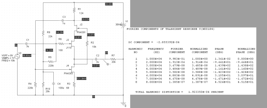

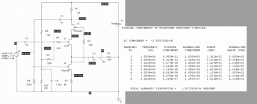

Attached is a schematic and simulation results for a simple cascoded "Fetwhite" buffer. The simulation results were surprisingly good, so I did a hack job on one of my buffer modules to try it out in my test preamp. Audible results are excellent. The unit gain buffer is also a good gain match for my overall system.

I usually like to see buffers tested with Higher source impedance and Lower output load - otherwise you might as well skip the active stuff altogether
almost anything will look good with low source Z and high Z load - I think you will find large area, low noise fet's nonlinear input C limits high freq linearity with higher source Z

Hi jcx !
You're right, it was bs to simulate like that... It's no problem for this circuit to reduce the load below 1k, but feeding it with a high impedance signal (22k in series with the v-source) distorted the signal at input with ~-72db (0.025%). Sorry for posting that... Wrenchone's circuit shows similar problems, but is better.

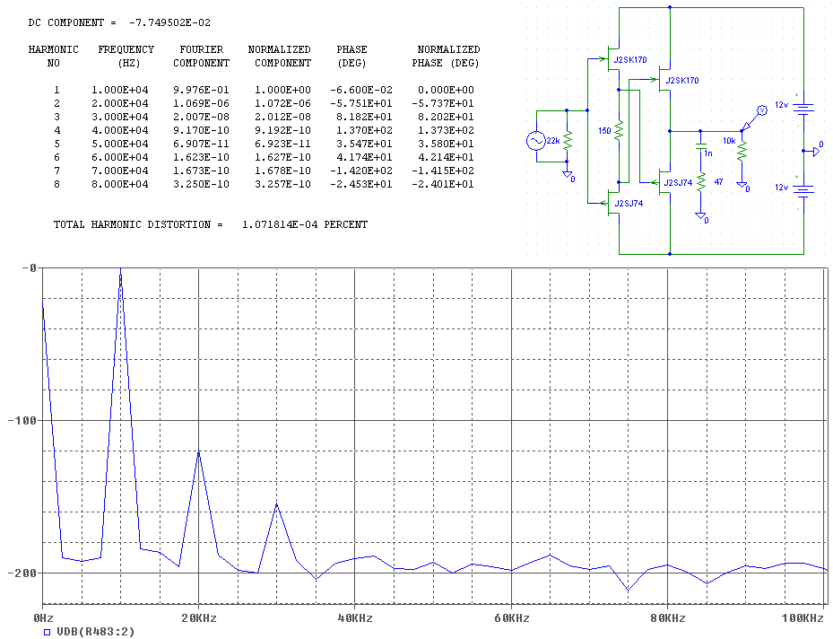

MikeB said:Okay, but this done does the job... (topology from steven)
Even with 220k source impedance, loaded with 1k, distortions at ~-132db for 10khz,1v...

It will not acheive anywhere near those numbers in real
life though.
You have 2k across 0.7V on the lower modulated CCS BJT.
So the upper bootstrap BJT is running at 0.35 mA quiescent.
This is not enough to cover the modulating +-1.4mA in the jfet
due to 1V into 1k load.
Further, in real life, these high gm jfets need more than 0.7V
S-D to work well as the cap is extremely non linear with these
small voltages across the device. IME => 3V is much better.
Thermal noise of 220k IP R is about 101dB below 1V .
Time to start verifying sims with real measurements
Terry

Terry Demol said:I really dig your follower circuit.... is that your idea??
Hi Terry, no, it is not my idea, this principle was posted by steven. It is about the active device having constant voltage AND constant current.

MikeB said:Hmm, sorry if i am annoying, but why that complex ?
Okay, mine has 4 jfets, but much less caps and resistors, and is DC-coupled. With matched jfets the dc-offset will go away.
Distortion levels are equal, 0.0001%,-120db. BW is -3db >1mhz.

wrenchone said:Attached is a schematic and simulation results for a
Last time I loooked, the White circuit had lower distortion, but the simple buffer would allow me to try a cascoded bipolar current sink instead of the JFET current sink current used here.

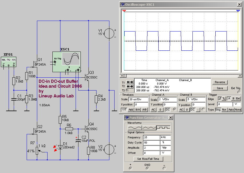

I have my own 'Super Easy Done buffer.
See my attached circuit!
This version takes total 9.5 mA supply current.
As can be seen, this setup is optimized for
Perfect 25.000 Hertz squarewave
at +/-2.0 Volt into 2k2 loading.
To achieve this the 3dB bandwidth is set to:DC to 800.000 Hertz
I will attach AC Analysis, frequency sweep & phase angle figures
in next post!
