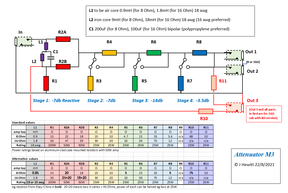

I've looked around and there are some implementations that resemble Aiken's circuit. For instance, J. Hewitt (user johnh on some sites) has a reactive load attenuator where his initial designs had 2 inductors but not the bipolar cap that Aiken's has. Does the omission of the cap make it significantly different? If so, could I use his circuit (https://www.marshallforum.com/threads/simple-attenuators-design-and-testing.98285/) and replace the front end with Aiken's circuit?
I imagine something like taking Hewitt's stages 2, 3, and 4 (for his 16ohm version since Aikens' is 16 ohm) and tacking them on after Aiken's R3 (68 ohm 5W). I assume that the resistor values of the resistive part can stay the same even though the inductor values in the reactive part are significantly different, especially L2 (1.1 mH vs 50 mH; Aiken's site has a typo where L2 is also marked as L1).
I assume that the bipolar cap does make the Aiken's circuit different/better but at the moment, my "ghetto" sensibilities tell me that a 1.1mH inductor is way cheaper than a 50mH one. Hewitt's M2 version will likely be cheaper still with only 1 inductor. "Bedroom" level, no one's recording career depends on this 🙂

I dug around and actually found an updated version of John Hewitt's attenuator. He has moved back to 2 inductors. I also include Aiken's circuit for completeness.
How close is he to Aikens? Is it now just a case of how big L2 gets?

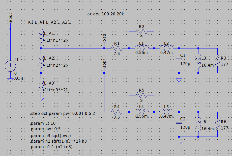

Earlier today (while looking at this thread), I realized that it's possible to distribute power between two loads (say, a good quality reactive dummy load and a loudspeaker) in any desired proportion using an autotransformer. Has anyone ever tried this? I worked out the math and whipped up an LTspice simulation. It seems to work exactly as I expected. In the ideal case, with identical loads, the impedance presented to the amplifier is identical at any attenuation setting.

That's what puzzled me. Hewitt's first versions has 2 inductors (no cap) but the largest inductor value is 1.1mH. I mistakenly compared apples to oranges, thinking that it was similar to Aiken's (2 inductors) circuit just because of the number of inductors.
So looking at Hewitt's M3 version, the inductor values are still no higher that 2mH. He's not designing for low frequency despite the inclusion of the cap.

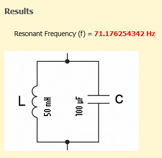

To put some numbers into it, and from https://goodcalculators.com/resonant-frequency-calculator/
for 50mH and 100uF we get:
71Hz is even lower than the lowest frequency produced by a Guitar (which is typically around 82 Hz), I guess it was chosen to cover even dropped tuning ones, and give a deep chest thumping sound in spades.

A note about J. Hewitt's M3 version. I missed the details noted in his schematic. L2 is larger the 2mH (I looked too quickly at the lower charts), it's actually 18mH for the 16 ohm version. Much bigger than his initial versions, but not close to Aiken's 50. I'm sure he has his design goals. No disrespect intended.
There are a few others: Suhr Reactive Load, Fryette Power Station/Load, and Fractal Audio X-load. There's some data here and a few more curves here.only Aiken (that I know of) loads amp the same way as a speaker does
So I guess my autotransformer idea would probably be prohibitively expensive to make.As of the multi-tapped transformer Marshall attenuator, it works fine, it "reflects" speaker impedance towards input, but that transformer is expensive too.

I just noticed this thread, which has some discussion about my attenuator designs. So I thought I'd join in.
Aiken is a key reference and I learnt a lot from his designs. His circuit is a load box, from which you take a signal for active reamping. It needs to replicate both the treble rise and the bass resonance if it is to be accurate. But to do that and then follow through to a passive output instead of active while also maintaining tone needs some further insights. I found that the key was to put the reactive impedance partly in series and partly in parallel with the load. It's also important to maintain not only accurate impedance as seen by the amp, but also output impedance as seen by the speaker. Most passive designs don't do this.
I have 3 designs that are referred to in this tgread:
M, with two coils, together replicating just the treble rise. Two coils are used so the inductance can be part in series and part in parallel to ongoing resistive stages.
M2. With a single treble coil, now feeding a delta configuration to get the series-parallel arrangement. The performance is virtually the same as M, but the maths to design it was a tad trickier.
Neither M or M2 creates a specific bass resonance for the amp to see. But, because the attenuator has a high but controlled output impedance, the resonance is created by the real speaker. This is different to the typical reamping unit, where the speaker is fed by a low impedance active stage, so is highly damped and all tone must be generated before.
Many dozens of M2 attenuators have now been built and are well liked. Recorded and listening tests have confirmed that the absence of an explicit bass resonance circuit makes negligible difference. The speaker makes it itself.
But, the amp doesn't see it, so in principle, there can be certain overdriven bass harmonics that are not generated, even though the basic tone is good.
If should be noted that bass resonance is only significant if very low notes are played, around low A. Its not nearly as important amp to tone as the treble rise.
