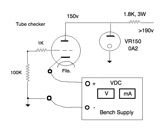

I have a few bench supplies, 15v at 4A or 30v at 2A. Typical bench supplies, with a digital read out of voltage and current. So how could a couple of these be used as a basic valve tester - not transconductance but just DC conditions? And test only triode conditions?
My first thought is to use a glow tube for 150v DC anode voltage. And then use a 100K grid leak + 1K stopper on the grid. One bench supply can be used for the filament voltage, that's easy. So what remains is how to measure voltage/current at the DC operating point?
Can this be done by connecting a bench supply between cathode and ground? You'd set a positive voltage on the cathode at the operating point you want, and then hopefully just read out the current on the meter?
Does this work? Any drawbacks? Any other ideas using bench supplies as above?

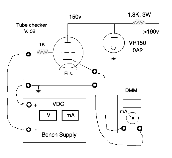

Here's diagram to make it clearer......
I'll get the operating points from the tube data sheets on Frank's site.
I'm using a nominal 150v which should give a general idea with most tubes.
I intend to test mainly smaller tubes, so current of approx. 5 to 10mA
Yes that will work fine. If your >190V is a bench supply, no regulator tube is necessary, just adjust the supply to 150V or whatever other voltage you want.
I would put the other supply in the grid, not the cathode. Just for simplicity. The way you have it shown, every time you adjust the cathode supply you change the Vak.
And careful to turn on the grid/cathode supply before the anode supply.
Yes that will work fine. If your >190V is a bench supply, no regulator tube is necessary, just adjust the supply to 150V or whatever other voltage you want. I would put the other supply in the grid, not the cathode. Just for simplicity. The way you have it shown, every time you adjust the cathode supply you change the Vak. And careful to turn on the grid/cathode supply before the anode supply.
Indeed - need to turn on the bias voltage before switching on the HT. No - I don't have a bench supply over 30v.
It hadn't struck me that the cathode voltage changes the Vak. That could be factored into the operating point, a bit tedious. But if the bias voltage is small it wouldn't make much difference to a quick and dirty test. If you bias the grid, however, how will you get a read-out of the current? A small resistor in the cathode connected to a DMM or what?

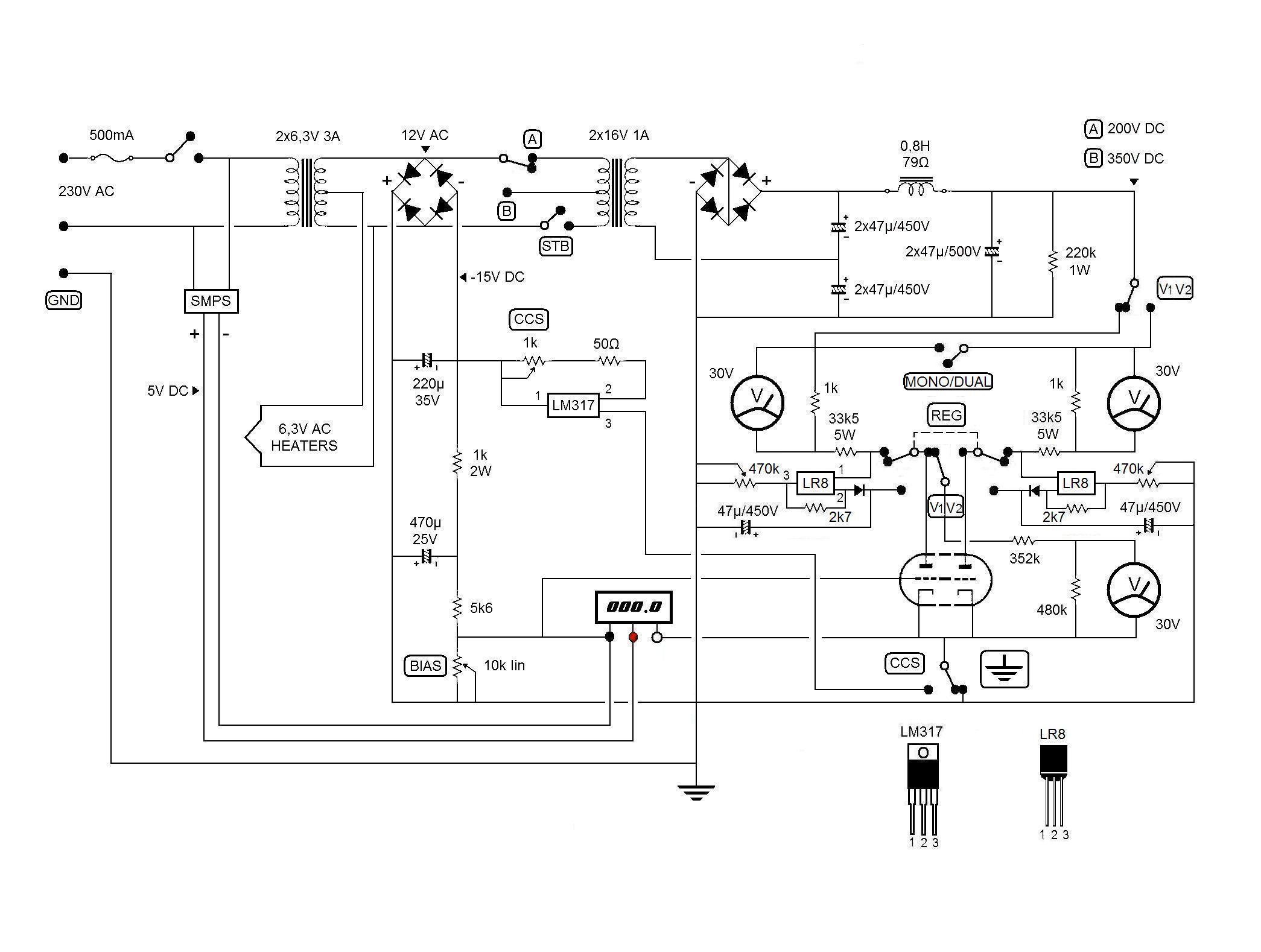

This is the setup I use to determine the DC conditions of any tube. The bench supply can source a regulated voltage of 200V - 325V. There is also a 6.3V filament supply. I use a small scrap chassis for the tube under test fitted with an assortment of sockets. So for a triode under test, I am interested in learning what plate voltage and current will be for any given bias point.
Since I have several direct coupled amps, the plate voltage is important since it will bias the following tube. Naturally, you could also compare the operating points of the tube under test with the tube manual expected values.
So if the tube is diode biased, for instance, there will be a 10r resistor in series with the diode to measure current. I would set the plate voltage to the that required to bias the following tube (there is no need for a load, but if the plate voltage is to be less than 200V I need to use a resistor load to bring the plate voltage to the correct value) and then read the current. So I would be matching the tubes for a specific current in this example with the plate voltage and bias fixed.
Naturally, one could vary any of the operating point conditions e.g., bias, current or voltage to compare to the tube manual operating conditions.

It hadn't struck me that the cathode voltage changes the Vak.That could be factored into the operating point, a bit tedious. But if the bias voltage is small it wouldn't make much difference to a quick and dirty test. If you bias the grid, however, how will you get a read-out of the current? A small resistor in the cathode connected to a DMM or what?
Simply an ammeter (DMM) between cathode and ground. That's what they do. Measure current. Just connect it securely.
You don't want to rely on the ammeter on a bench supply anyway, unless you calibrate it. The accuracy would be questionable unless it's a high end instrument grade supply.
