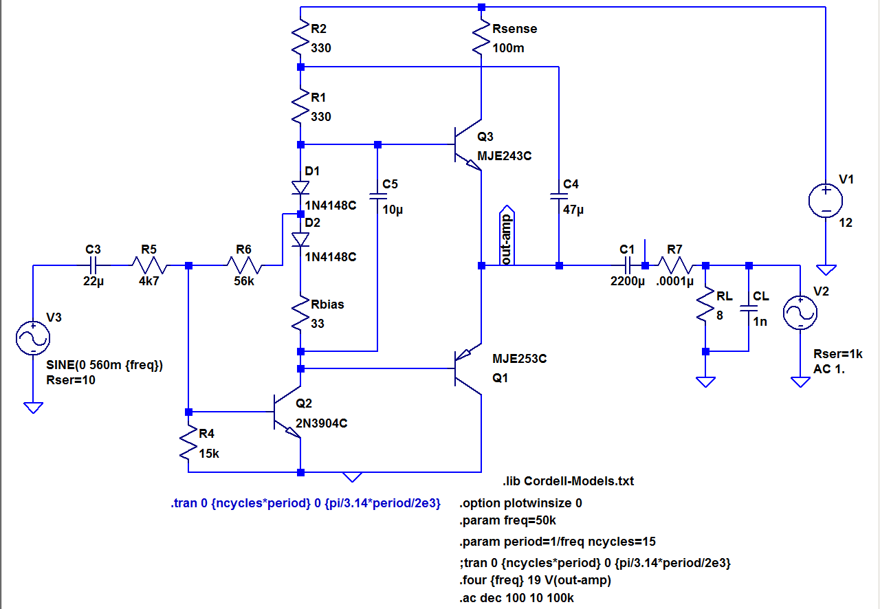

The second video is a typical three-transistor circuit with errors. Power supply 12 v. Power 2W.

"With errors" indeed. Like, how many mistakes can one make in a schematic involving less than 10 components?The second video is a typical three-transistor circuit with errors. Power supply 12 v. Power 2W.
DIY Amplifier simple 2SA1943 and 2SC5200 Transistor Extremely Powerful Using Output Capacitors - YouTube
D1 & D2 are the wrong way round.
Q1 collector connects at the wrong end of D2.
Only local feedback is provided, but simulation reckons connecting the feedback resistor at the output would make distortion slightly worse - go figure.
None of the transistor types are still made by their original manufacturers, so what you get may vary.
Here's something like this in slightly fancified. As shown, simulation indicates that it manages almost 1 W / 8 ohm at a 1% THD limit (about 2 W or so max). Output transistors require heatsinking, and silpads or mica washers if mounted on a common heatsink. For stereo, a power supply capable of at least 1 A @ 12 V is required.
An amp like this is better than nothing... but even a single transistor more would give a disproportionate upgrade in performance, as demonstrated by the JLH. We live in a time where silicon is cheap but heatsinking and power supplies are expensive.

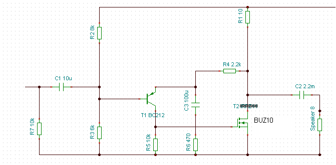

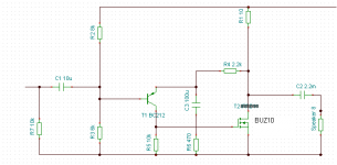

- Simplest Transistor amp possible
