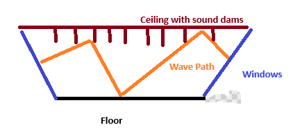

- To address standing waves my idea is for the exterior walls to be inclined outwards, like an inverted pyramid, with approximately 30 degrees of inclination.
---This should eliminate standing waves between parallel walls, as they are not parallel
---Any standing waves must involve the ceiling, and the ceiling joists will be exposed as sound traps and provided with damping material

I'm working on it now. It's been a few years since I used CARA, but it's coming back.
Started with a 1000 sq foot cottage, all one room. Actually it's 93 sq meters, because CARA works in metric. I made the room all golden ratios L-W-H to give it a fighting chance. The first room has wood floors, gypsum board walls and ceilings, with full glass walls on the short sides. Everything is parallel. Of course it's awful with reflections everywhere and lumpy frequency response.
Now I'm working on a room of the same width and height, but the glass walls slope out 30 degrees. I've also put carpet on the floor, beams on the ceiling, some acoustic foam panels here and there and two book shelves. Just angling the glass makes a huge difference, but adding absorption and scattering helps too. Reflections are much more diffuse and room modes and frequency response has smoothed out. Amazing for a room with two glass walls.
I'll try to get the reflection animations and graphs posted here. BTW, do you have room dimensions in mind?

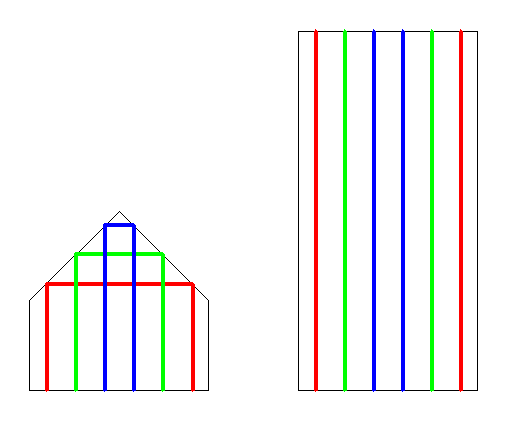

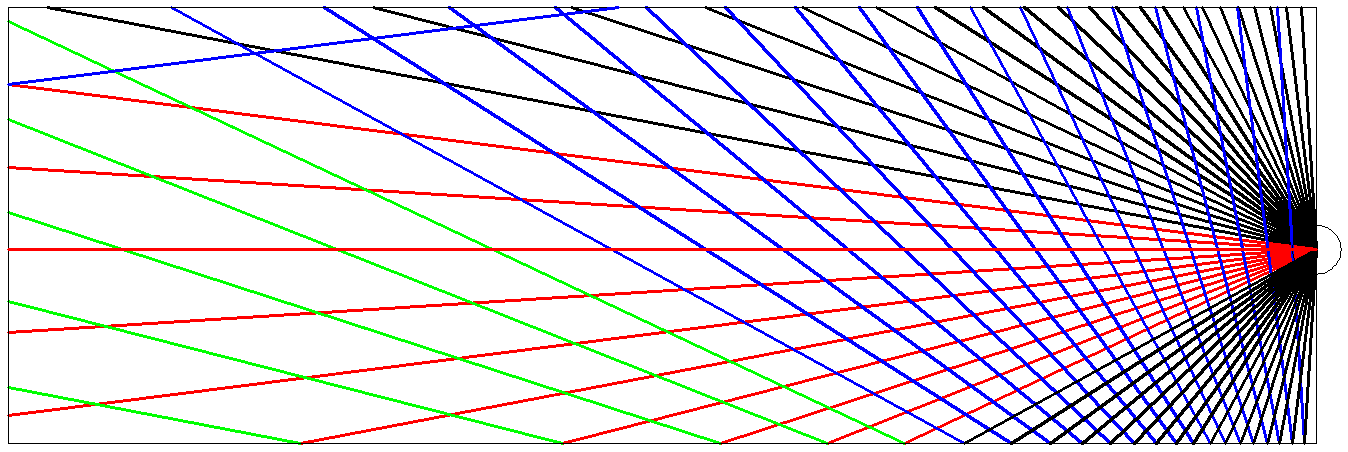

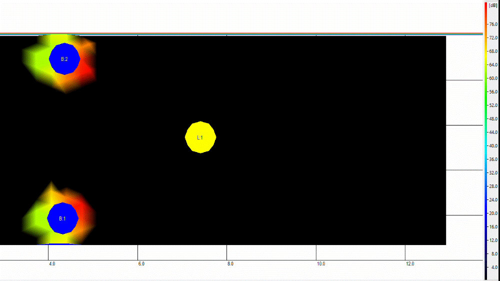

OK, I'll do a model of a room like that. Below is animation of a Dirac pulse in a room with tilted glass room with carpet, bookcases, ceiling beams and acoustic foam on sections of the wall and ceiling. It's hard to get these to play on the page, but I'll see what can be done.
ANGLED GLASS ENDS WITH ROOM TREATMENT
In a rectangular room, the majority will hit the ceiling before the second reflection. The remaining in this example reaches the back wall before the second reflection where by this time they are diffuse and delayed sufficiently to begin making a positive contribution.but if the waves are directed to absorbent materials I should enjoy some damping?

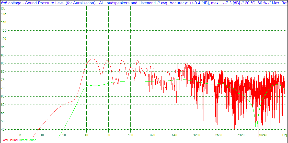

OK, here are some results, I hope that you can make sense of them. I modeled 3 similar rooms
Room with no walls:
Treated room with sloped glass walls:

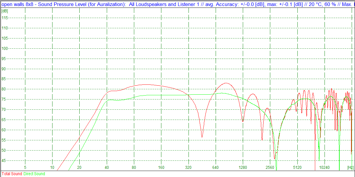

Graphics: First the frequency response of each room.
No Walls.
The Glass Box
Treated room with sloped glass walls.
In the No Walls super dry room we can see that CARA has simulated the comb filtering caused by the stereo setup. This causes a dull sound.
You can read more about that here: https://www.diyaudio.com/community/threads/fixing-the-stereo-phantom-center.277519/post-4398895
In the two rooms with reflections, those reflections fill in the dips caused by comb filtering between two speakers and a head. Of course the reflections have their own problems.
GlassBox.
Treated room with sloped glass.

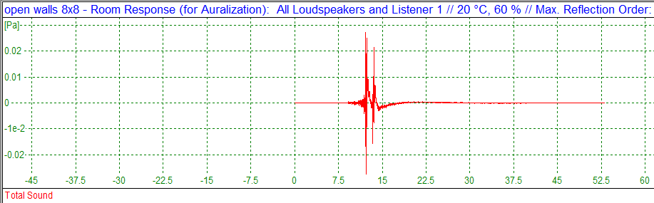

The impulses show us what the reverb looks like over time. The impulses do not start at zero because we see the time of flight from speaker to ear. I don't know why there is a rough double impulse, it might be the model of the ELAC 516 speaker used in the sims. The impulse looks almost the same looking at a single speaker.
EDIT: The second big impulse is floor bounce. In a room with no floor, that second impulse goes away and so does the combing.

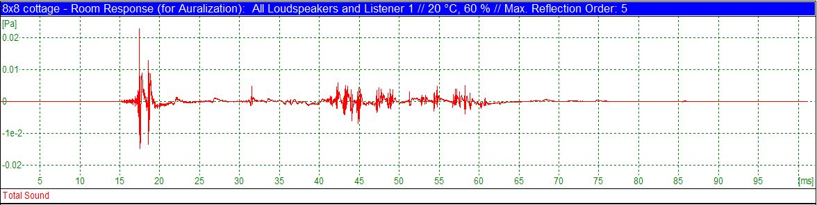

We see how bad the glass box room is, all hard parallel surfaces meaning many, many reflections . The treated and sloped glass room is better, but there is still some reverb there as seen starting at 40ms.
These impulses were used to make the sound files in the next post.
- 8x8 meters with no walls of ceiling. Carpet on floor. This "room" is ultra dry, no reverb.

- 8x8 meter floorplan with glass walls that slope outward from the floor at a 30 degree angle. Carpet floor and wood beams on ceiling. A lot of acoustic foam in the ceiling.

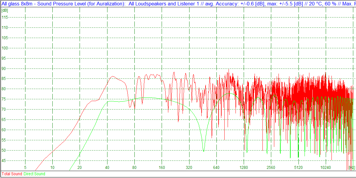

No Walls.
The Glass Box

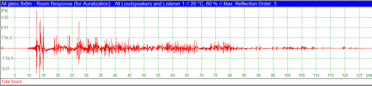

Impulse responses of the rooms.
No walls.GlassBox.
