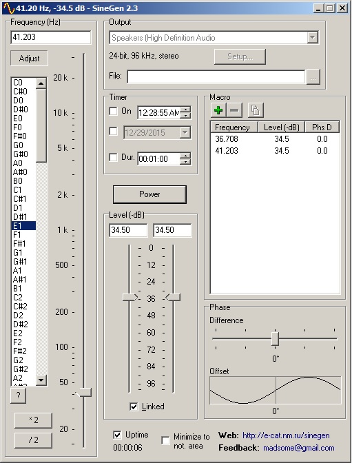

I use SineGen 2.3. Its a Windows PC app that generates sine waves via the PC/Laptop sound card. Use the line out as the audio source for testing.
I've had it for several years and doesn't seem to exist on the apps referenced web page. A google search seems to find a different product of the same name.
It doesn't install. SineGen.exe will execute no matter where its located with just a double click. I keep the app in the folder with my DIY info.
Send me a PM with your email and I can forward a copy to you.
