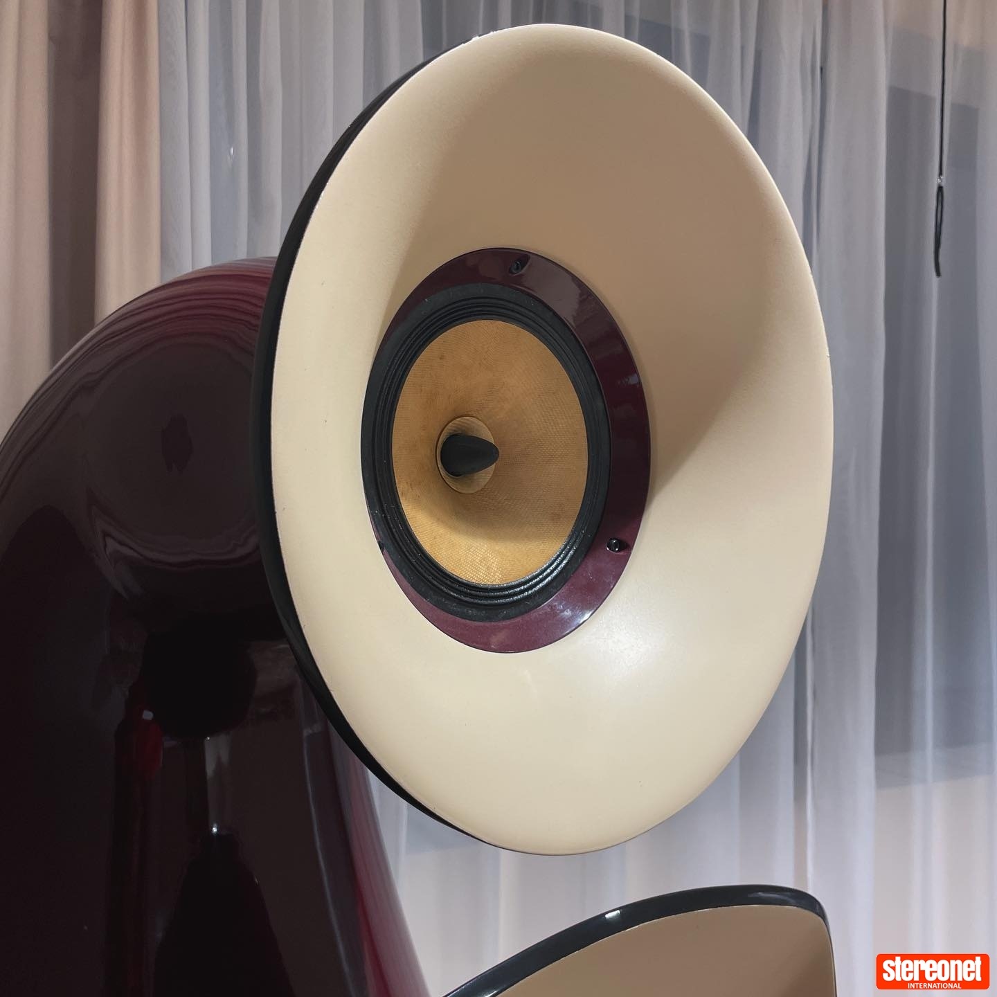

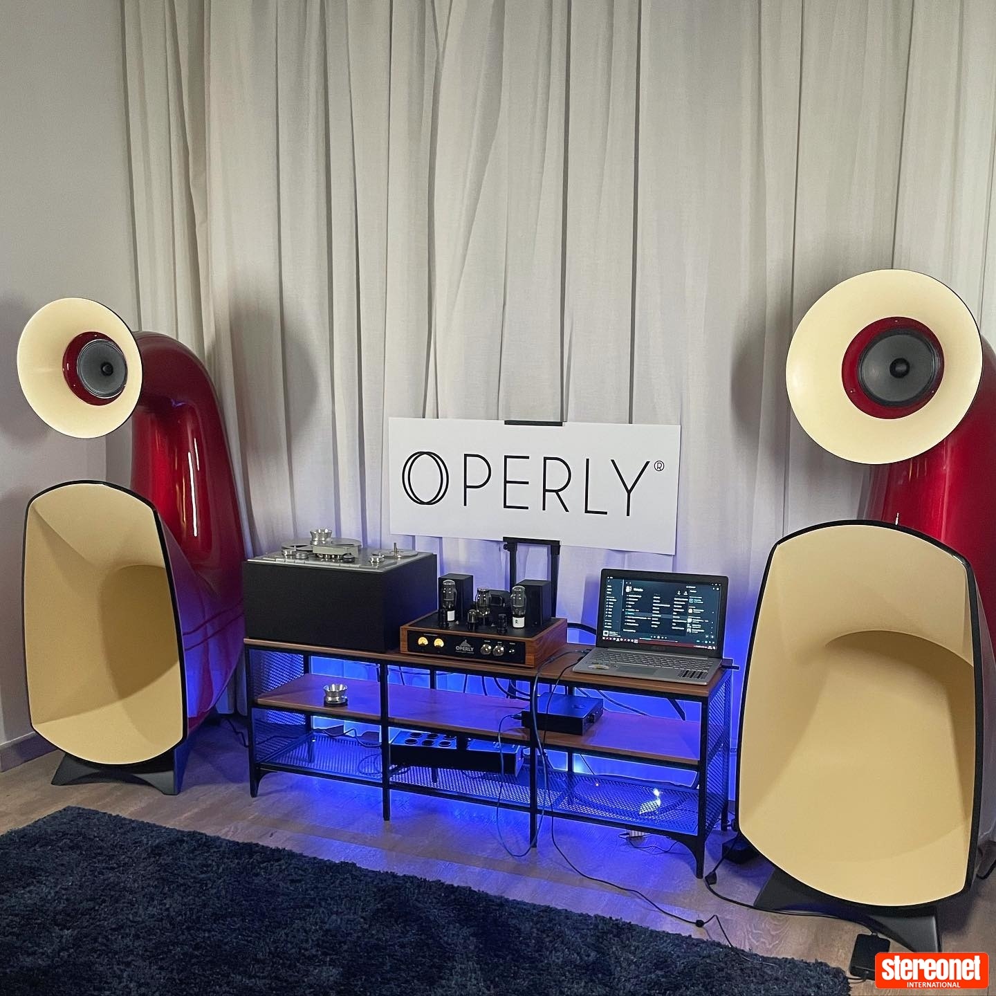

https://www.stereonet.com/uk/news/operly-intelligence-iii-horn-speakers-now-available67Kg/speaker 572 x L 590 x 800mm (WxHxD) vaccume formed 15mm high quality fiberglass monocoque body
You don't want to know what they cost!
@planet10 @Scottmoose @nandappe etc How about a few Front/Back DIY designs?
Right now I'm looking at that and seeing multiple areas of the design that I'd have reservations about.

41.5 Hz at 100 dB/W sensitivity? I Don't Think So. I'd believe 70 Hz, not much lower. Plus the "front horn" is more like a waveguide effective from maybe 500 Hz to 2-3 kHz, above which the speaker's directivity becomes narrower than the waveguide's included angle.

God you have to laugh at the wanna be Hi End manufactures the terminology they use proves their idiots. Monocoque body is something we are used to exotic car makers like Ferrari & Lamborghini saying to describe something factual in the automotive industry. Monocoque is just a fancy french word basically describing how the chassis & body together create rigidity. This term being used now by this speaker manufacture is hilarious and insulting at the same time. Lets be honest this speaker looks cheap why? because fiberglass is cheap. You can use whatever exotic words you want to describe these and it's not going to change the fact they are extremely ugly and extremely cheap looking. $450.00 would be way to much to pay for 8" full range in one of the worlds ugliest horns. The first pic the 8" look like visaton bg 200 the second pic the full range look like a Chinese brand sold on Aliexpress. I am sorry for sounding pissed but this is whats wrong with the world people making a product that is truly cheap and truly under performing and then trying to use exotic words to make people think they are special and then asking $45.000 to be honest this is immoral and should be illegal. I feel sorry for anyone with a low enough IQ to actually buy these no wonder the entire world is going down the toilet !!!!!Operly Intelligence III Horn Speakers

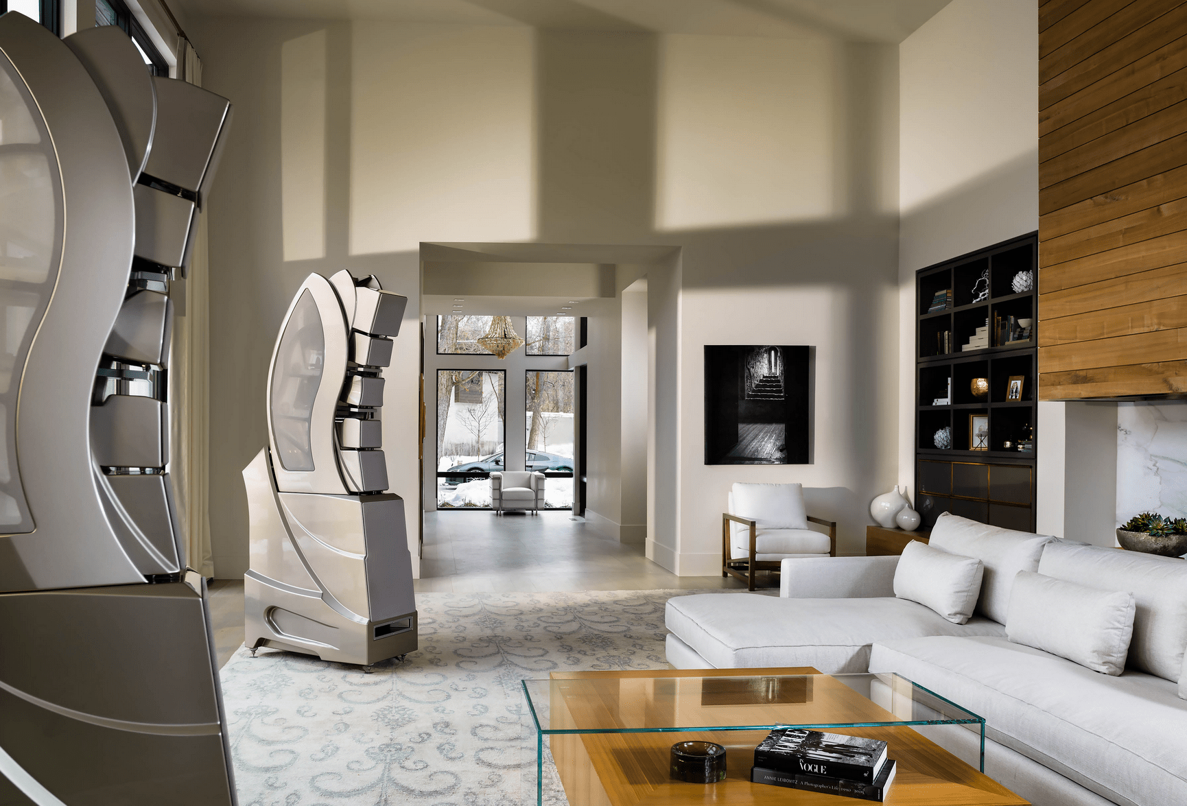

Come to think of it, I suspect that's probably where some of this stuff would sound best. Those Wilson Master Chronosonics for instance. Beautifully built (high end theodolite time, I'll give them that). But you can picture the scene. You get up, circa 0253hrs, with severe case of needing cheese, choitzo and tiger-bread. You stumble down the railless stairs, avoid tripping over the sleeping dobermann, and proceed in weaving pattern through the lounge on the way to the kitchen, then half-way there, realise you are about to be taken down by a pair of mechanical triffids, without even having time to commend your soul to God.
They're coming for us...

Every time I spot a Wilson extravaganza I can see the wavefronts bouncing off all the protuberances. About the only thing they did right wrt diffraction is flush-mount the drivers, but with all the shelves, ledges, and sharp edges they're using a teaspoon to bail the Titanic. It's like the designers (I hesitate to call them engineers) never ran across a copy of Olson's Acoustical Engineering. The Grateful freakin' Dead's engineering team were onto that book fifty years ago.
