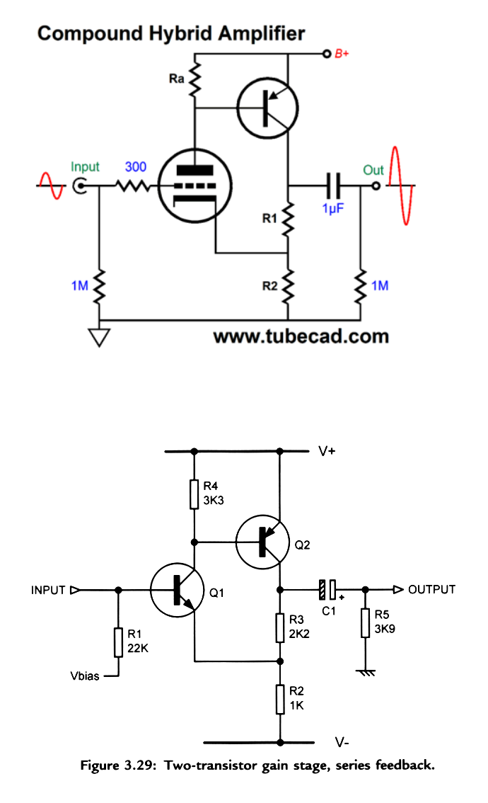

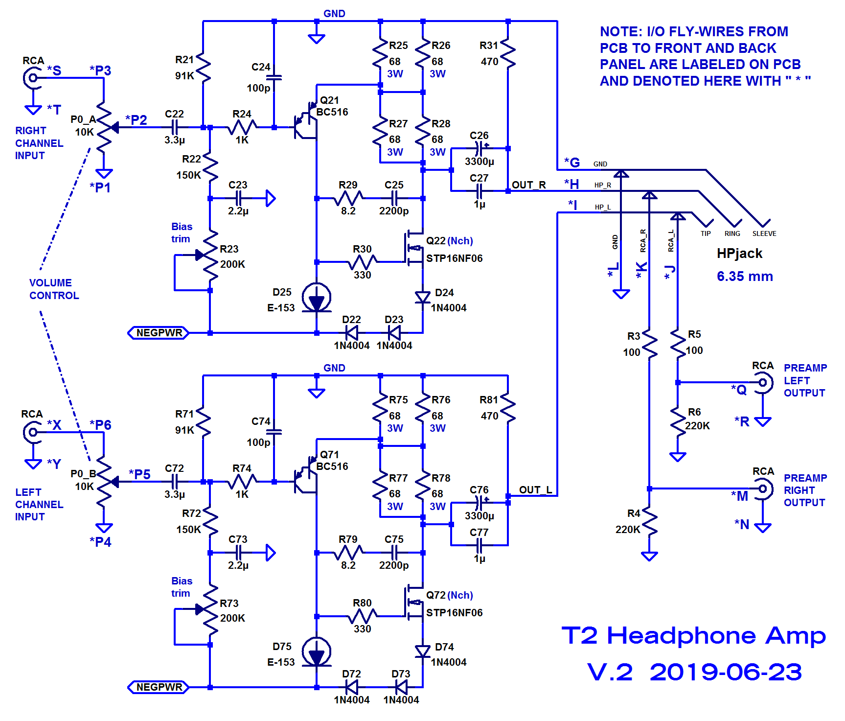

Amplification is performed by a two transistor circuit, which is not an especially new idea in itself. Two device amplifiers have been aroung a long time, in hybrid tube+transistor circuits (Fig 2 top) and in all-BJT circuits (Fig 2 bottom (from D.Self)), to name two examples. The T2 headphone amp simply scales up the output stage bias current to 150 milliamps, and uses high wattage power resistors as the "collector load" of the output stage.

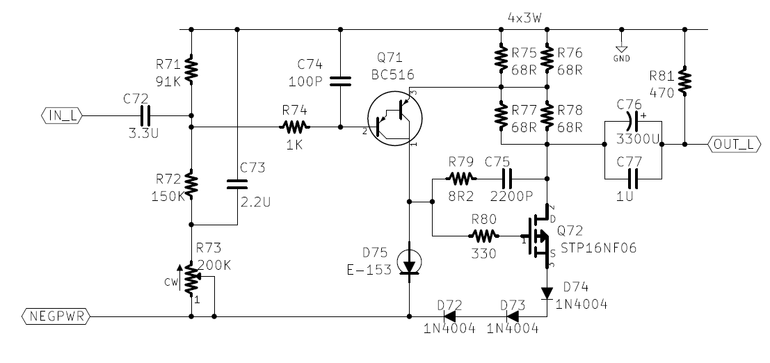

Figure 3 shows the business part of the T2 amplifier circuit. The polarities of the two amplifying devices have been reversed; the input transistor is now P-type and the output transistor is N-type. This lets us exploit a serious advantage of Nchannel MOSFETS: they are majority carrier semiconductor devices, whose gain is proportional to electron surface mobility. Pchannels' gain is proportional to the surface mobility of holes. Since electron surface mobility is about 2-3X higher than hole surface mobility, Nchannels have about 2-3X greater gain (per unit area, per unit capacitance) than Pchannels. All we have to do is flip the power supply upside down, and we get 2-3X higher gain. An easy decision! T2 uses a positive-ground, negative-supply arrangement, with the supply rail "NEGPWR" at approximately -22 volts DC. (BTW positive-ground was common in germanium transistor circuits back in the 1950s and 60s.)
The input signal is applied to the base of input transistor Q71 through coupling capacitor C72 and RFI filter R74-C74. Since the input signal is referenced to ground (by definition!), the base of Q71 is referenced to ground. The positive-ground arrangement means the emitter of Q71 is also referenced to ground, so the base-to-emitter voltage across Q71 is quite immune to supply variations, and PSRR of this stage is high.
Q71 is loaded by a constant current source whose manufacturer calls it a "current regulating diode", D75. This drives the gate of output transistor Q72. Q72 operates at 150 mA of bias current, set by potentiometer R73. Its load is a 12 watt, 68 ohm resistor which is synthesized by a series-parallel arrangement of four 68 ohm, 3 watt resistors. Total dissipation in these resistors is < 2 watts, whereas their aggregate rating is 12 watts, so a conservative margin of safety is in effect. Nevertheless the resistors do get fairly warm when powered up.
Negative feedback from the output stage to the input stage is arranged by connecting the emitter of Q71 to the midpoint tap of R75-R78. This sets the amplifier's overall gain to +6.0 dB, which ensures the volume control pot will be cranked up past 25% of rotation, just about always. Typically, channel to channel tracking in pots is worst at low rotation, but improves as you crank the knob up higher and higher.
Diodes D72-D74 elevate the source voltage of MOSFET Q72, which in turn elevates its gate voltage. This biases current source D75 to its sweet spot on the I-V curve for best operation, comfortably above the "knee voltage Vk" discussed on the E-153's datasheet.
An amplifier with a single ended power supply needs an AC coupled input and output; capacitors C72 and C76+77 provide these. C72 and C77 are a high quality film types. Go ahead and calculate the low frequency rolloff corner frequencies introduced by AC coupling; they are far below the audio band.
Some may not agree that the T2 circuit can be called a two transistor amplifier. For one thing, darlington "transistor" Q71 is, in reality, an integrated circuit with two transistors on the same die. And for another, it feels like cheating to call D75 a diode and not a transistor. Even though D75 has only two terminals, even though it cannot provide voltage gain, current gain, or power gain, D75 just seems like it needs to be called a transistor. To those who feel this way, I gently reply: you may be right. However I really like the name T2 and I plan to keep using it. Feel free to call it by another name (T2++ ??) if you prefer.

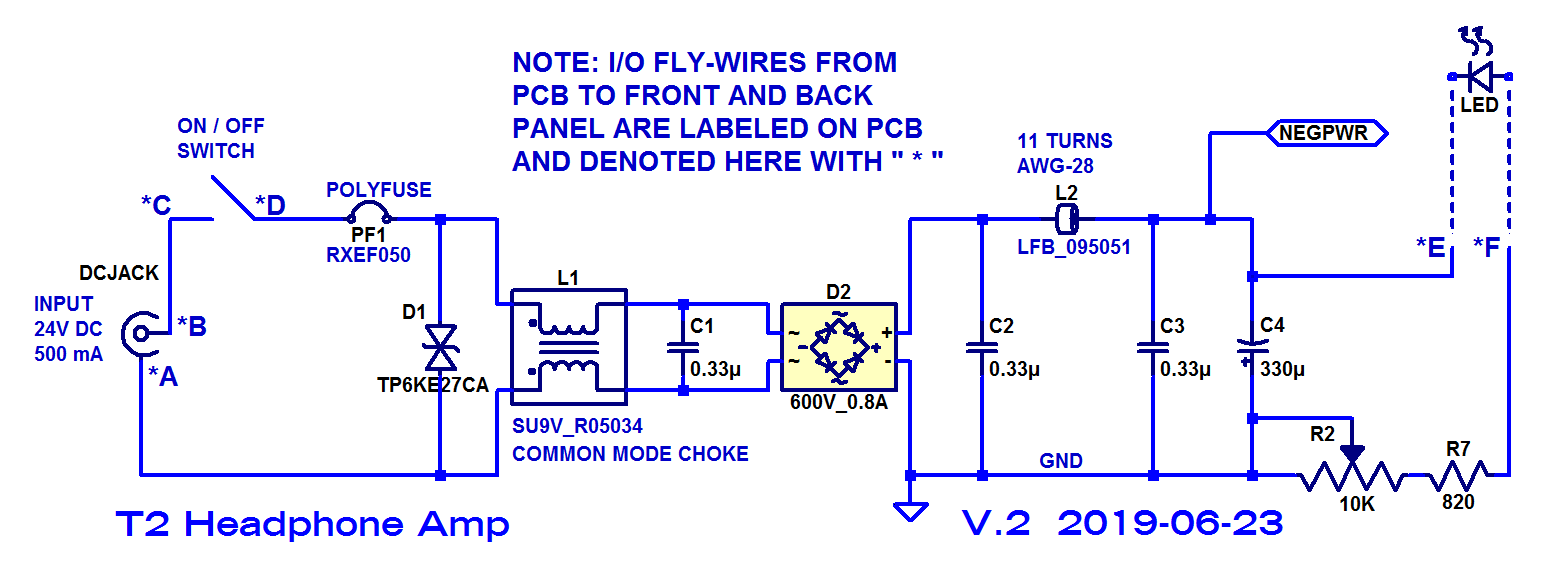

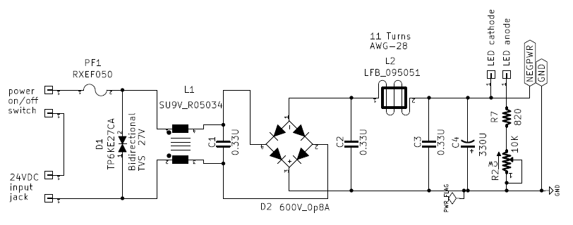

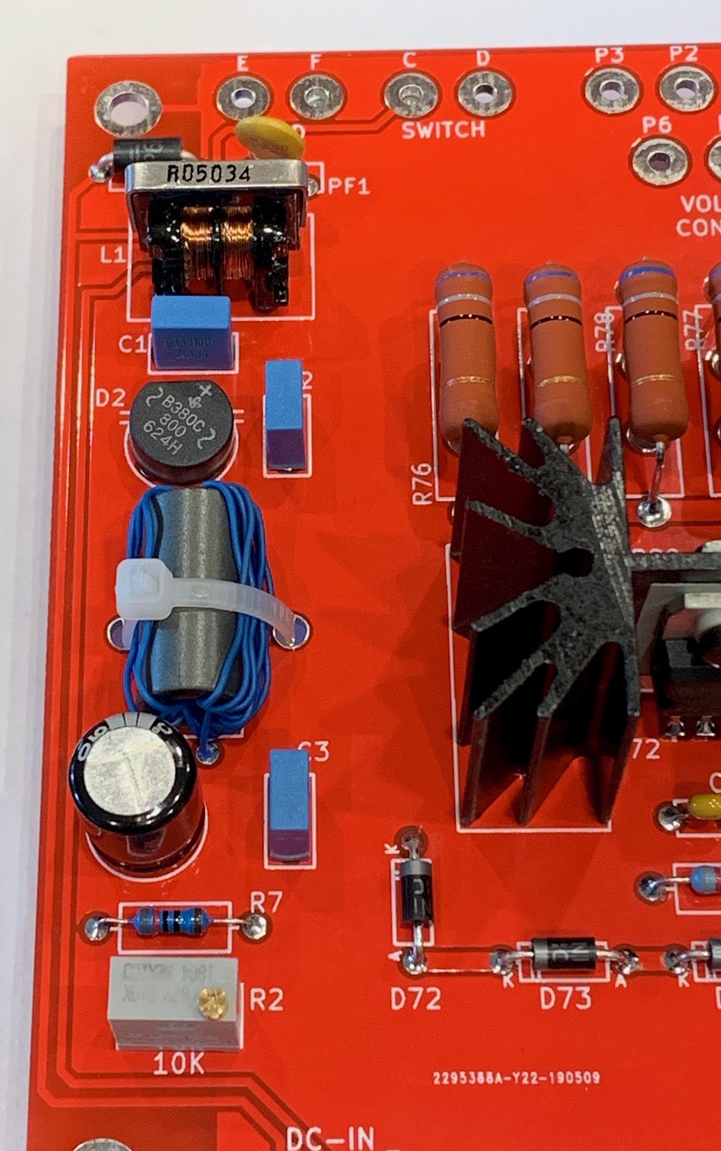

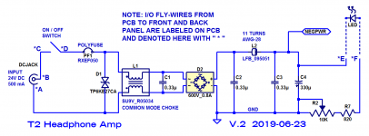

24V DC from the wall wart is applied to the power supply filter circuits shown in Figure 4. A resettable PolyFuse protects against short circuits, and a bidirectional TVS (Transient Voltage Suppressor) diode protects against overvoltage. High frequency spikes and hash from the SMPS are removed by a ferrite core, Common Mode Choke "L1", working in conjuction with capacitor C1. Bridge rectifier D2 allows the use of either polarity DC plug on the wall wart; the amplifier doesn't know and doesn't care whether it is center-positive or center-negative. The supply is filtered again by L2-C4, to further reduce high frequency noise.

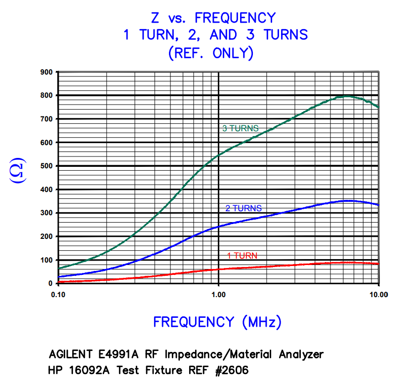

Component L2 is a ferrite core from Laird Performance Materials, specially engineered to attenuate switch mode power supply noise in the frequency range between 100 kHz and 10 MHz. I've snipped out a graph from Laird's datasheet and presented it below as Figure 5. Notice that attenuation increases as the square of the number of turns on the core. Laird anticipated that customers would use big thick wires carrying great big currents, so at most three wire turns through the center hole would fit. But T2 draws less than 400mA, meaning we can use wires even thinner than AWG-28, which allows at least eleven turns through the Laird core. Mentally extrapolate Figure 5 to eleven turns: Cowabunga! That's a lot of attenuation.
Potentiometer R2 and fixed resistor R7 are current limiters which allow builders to continuously vary the brightness of the power-on LED, as high or as low as they wish. Perhaps I should say, as bright or as dim as their spouses wish.

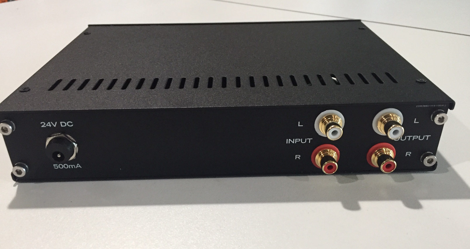

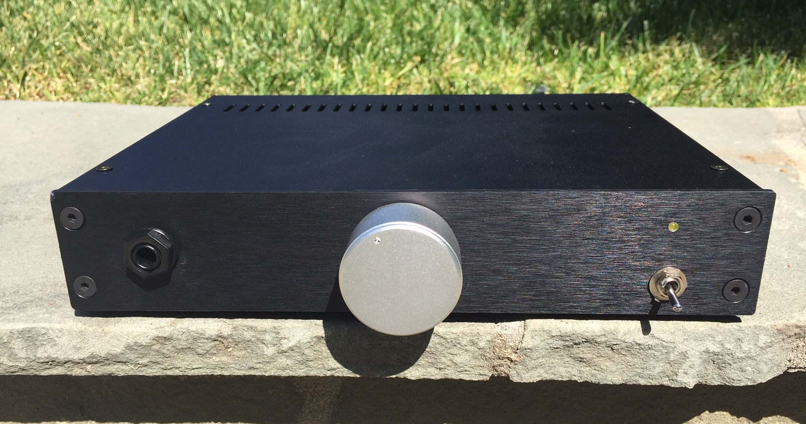

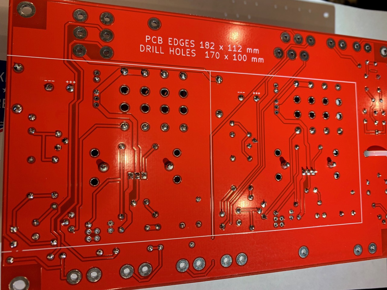

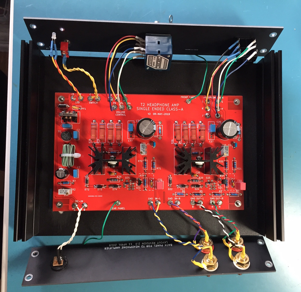

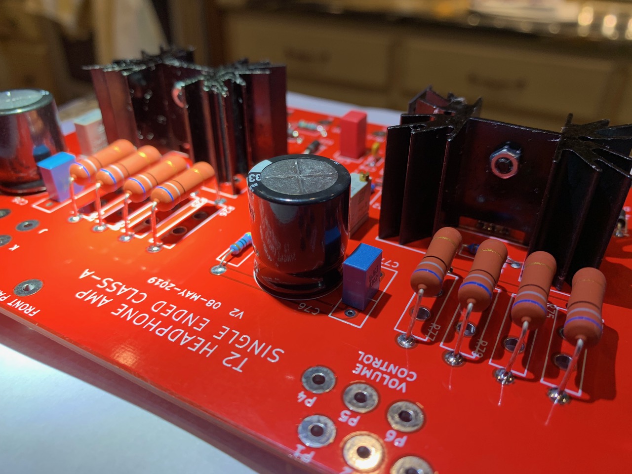

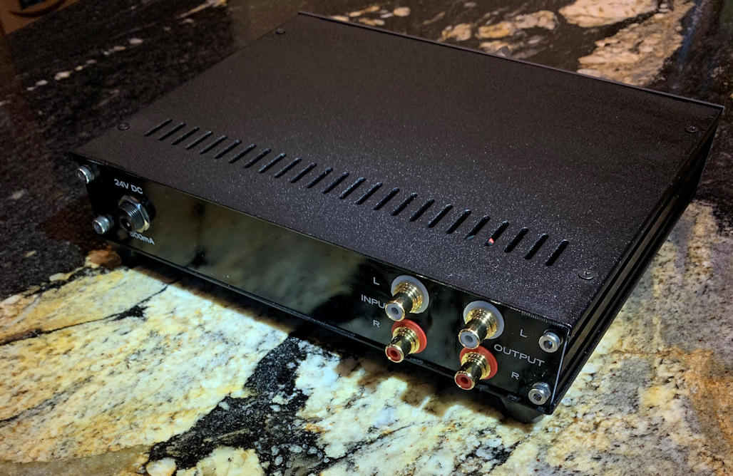

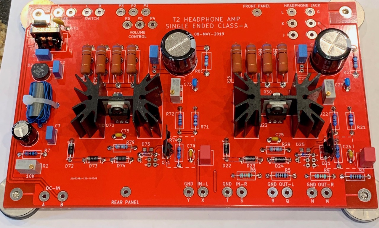

Figure 6 shows the T2 PCB bolted into a 1U Galaxy chassis from the diyAudio store. The front panel, at the top of the photo, holds the power-on LED, the power switch, the volume control potentiometer, and the headphone jack. The back panel, at the bottom of the photo, holds the DC input jack (wall wart connector), the stereo input RCA jacks, and the output RCA jacks. Close scrutiny of the photo also observes green grounding wires which connect to the front panel and to the rear panel. These implement a solid metal Faraday cage surrounding the T2 amp on all six sides, shielding it from external noise and hum. Don't try to build T2 without an all-metal grounded enclosure (Faraday cage)! The risk of audible hum is too great. Not visible in the photo is the electrical connection between the metal body of the ALPS RK27 potentiometer, and the Faraday cage. This incorporates the pot itself into the Faraday cage. Thank the mechanical designers at ALPS for including a metal alignment peg which also serves as a ground connection point.

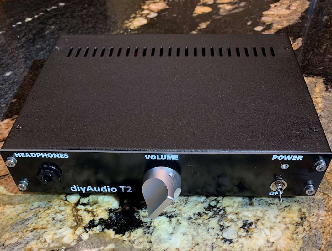

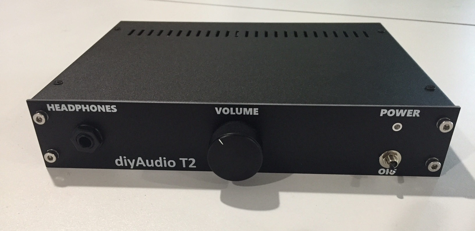

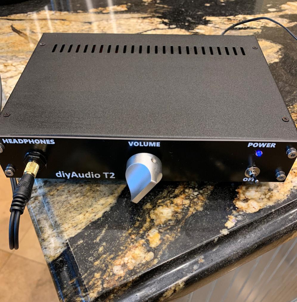

Figure 7 shows a fully assembled T2 using the blank front and back Aluminum panels that ship from the diyAudio store. I drilled them myself on my $200 tabletop drill press from Amazon. There are no labels but really, why do you NEED labels? It's blazingly obvious that the 1/4" hole on the left is the headphone jack, the knob in the center is the volume control, and the switch + LED on the right are the power on/off control. The rear panel is another story of course; you do need to indicate which RCAs are inputs and which are outputs. And you do need to indicate which are Left and which are Right. Some builders may not care whether the labels on the rear panel are "beautiful" or not, since they are not visible during normal use. Any labels at all, no matter how ugly, would be adequate. Other builders would be offended at the idea of permitting any ugliness at all, anywhere on the build, whether visible or not.
Figures 8 and 9 show a T2 using the low cost front and back panels made by a PCB fabrication house. I designed these as plain ordinary PCBs, including the correct size drill holes for the jack, the pot, the switch, RCAs, etc., and also including the Faraday cage conductors on both copper layers. I selected "matte black" color, and ordered them from a low cost fab house in China. The boards came back drilled and plated beautifully, with acceptable quality silkscreen markings.

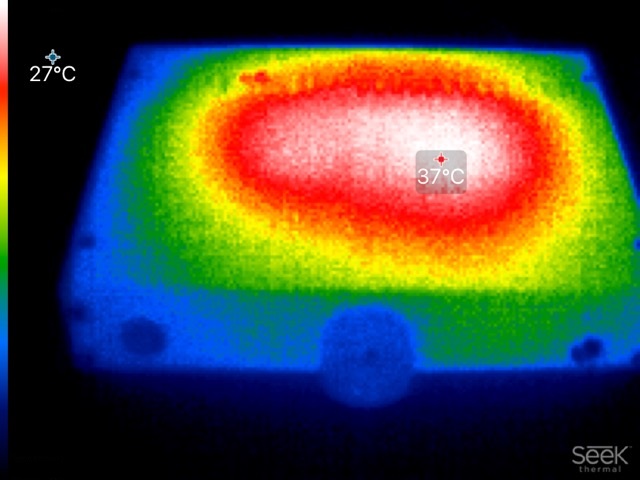

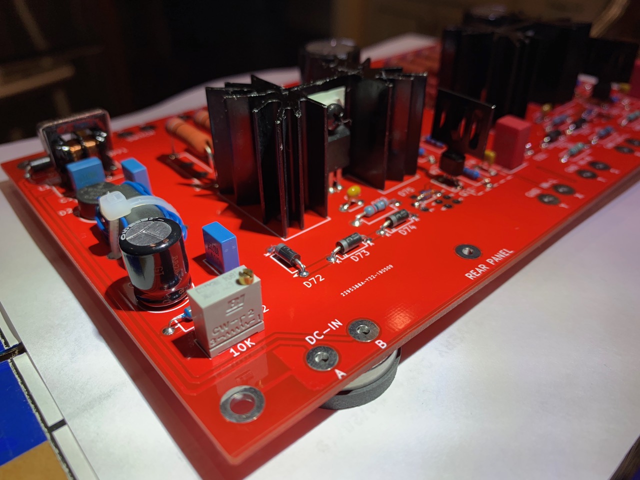

Updated (for clarity) Schematics --

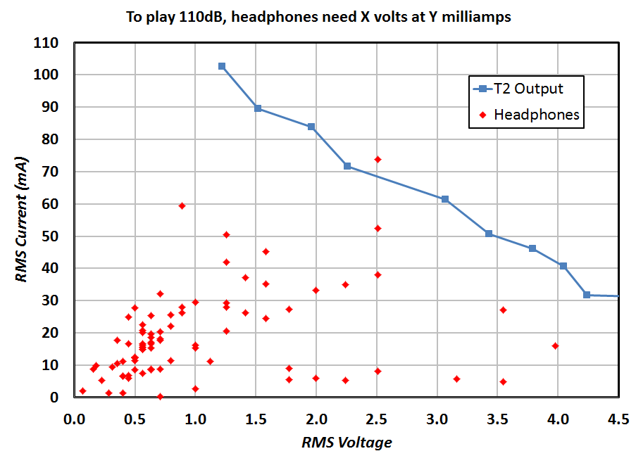

I made a few measurements on T2 today, examining output drive capability. I began with this excellent table of headphone data from the head-fi.org website: link
They tabulate the voltage and current (AC RMS) needed to make each pair of hedphones produce 110 dB SPL, which is very loud. I like this approach because it gets rid of intermediate variables like sensitivity, impedance, and so forth. The voltage & current data tells you exactly what you want to know: how to drive each of the 83 pairs of headphones to maximum volume.
I've charted their data on the scatter plot below. Each red diamond is one datapoint from head-fi's table. Overlaid on the plot is measured data from the T2 headphone amplifier, plotted in blue. The blue line shows where T2's output just barely begins clipping: for X output voltage, T2 clips when output current exceeds Y milliamps. 80 of the 83 headphones in Head-Fi.org's table, fall below the blue line. Which means that T2 will drive all 80 of them to 110dB SPL or louder. The ones T2 cannot push to 110dB are:
HiFiMan HE-4, HiFiMan HE-6, HiFiMan H3-500
whose drive requiremnts border on the insane. T2 is not insane and it cannot drive them to 110dB SPL. Sorry.
I also measured T2's output impedance today. With the input grounded, we inject an AC current into T2's output, and measure the resulting AC voltage. Computing the ratio (Voltage/Current) gives the output impedance. It's Ohm's Law. When the injected current was 13.3 milliamps AC, I measured T2's output voltage to be 19.0 millivolts. Their ratio is T2's output impedance: 1.43 ohms.

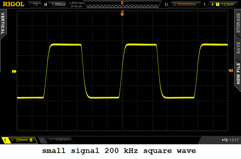

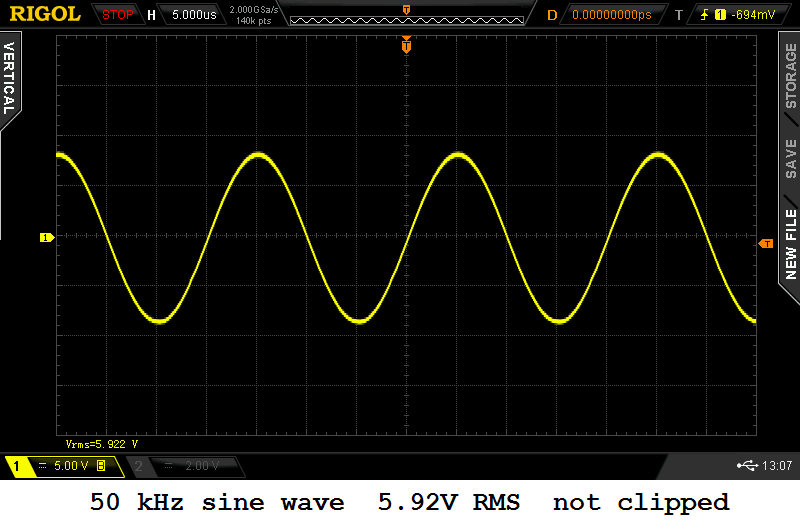

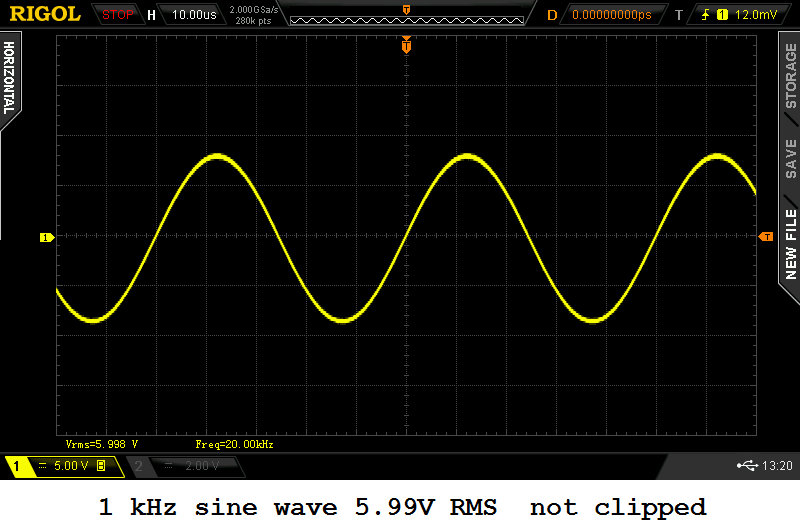

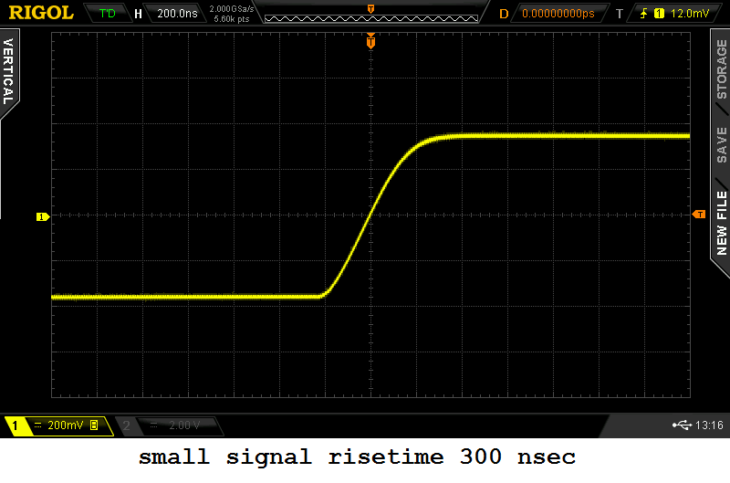

Finally, there are a few oscilloscope measurements attached below.
Max amplitude before clipping, with a 22K ohm load, is about 6V RMS. At both 1 kHz and 50 kHz.
Small signal square wave testing at 200 kHz, shows thoroughly damped rising and falling edges with no ringing.
Rise time is 300 nsec, corresponding to a closed loop bandwidth of 1.1 Megahertz (at a gain of +6 dB)

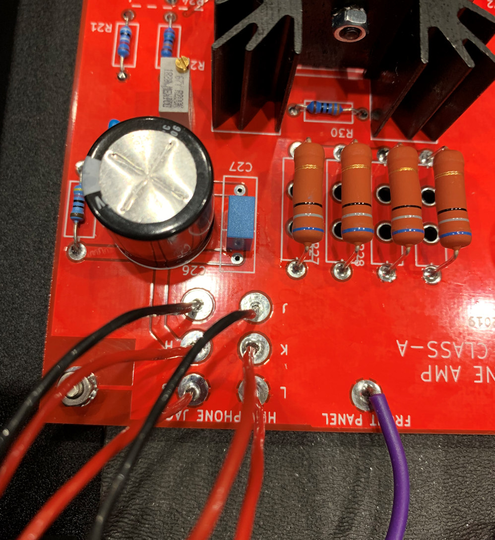

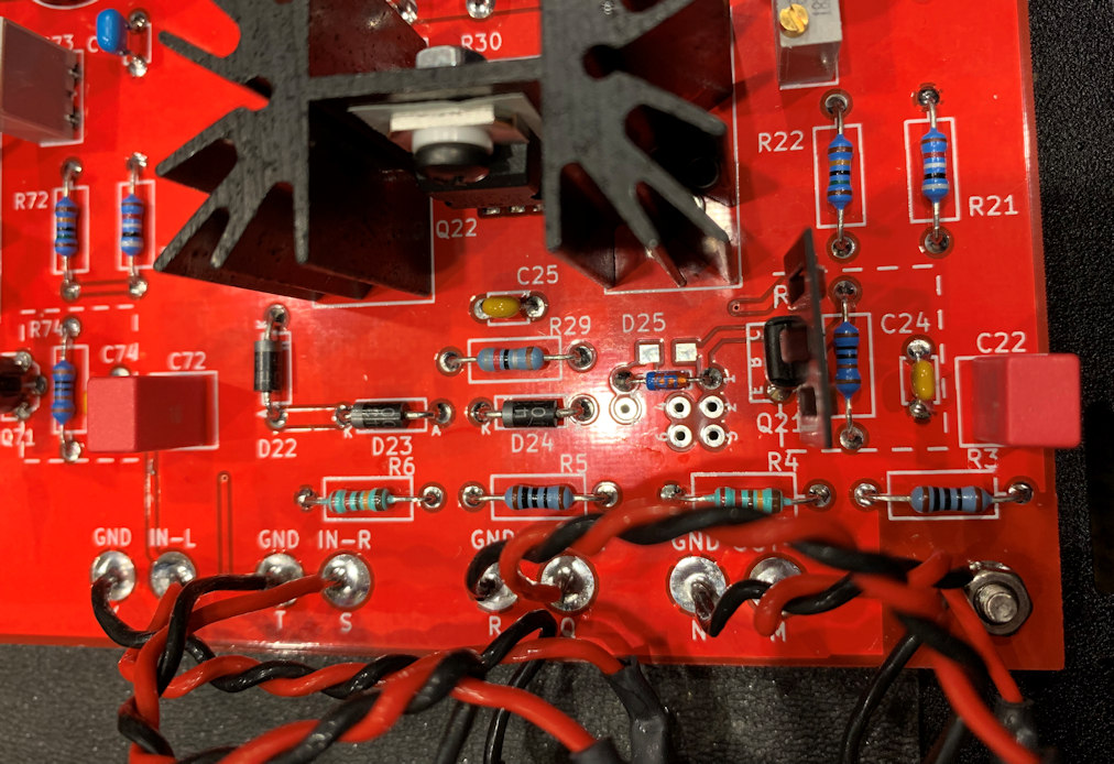

Another place holder. More goodies coming.

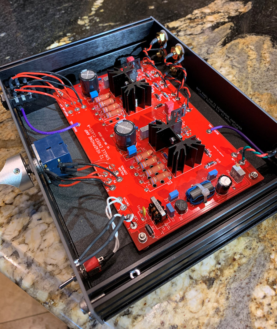

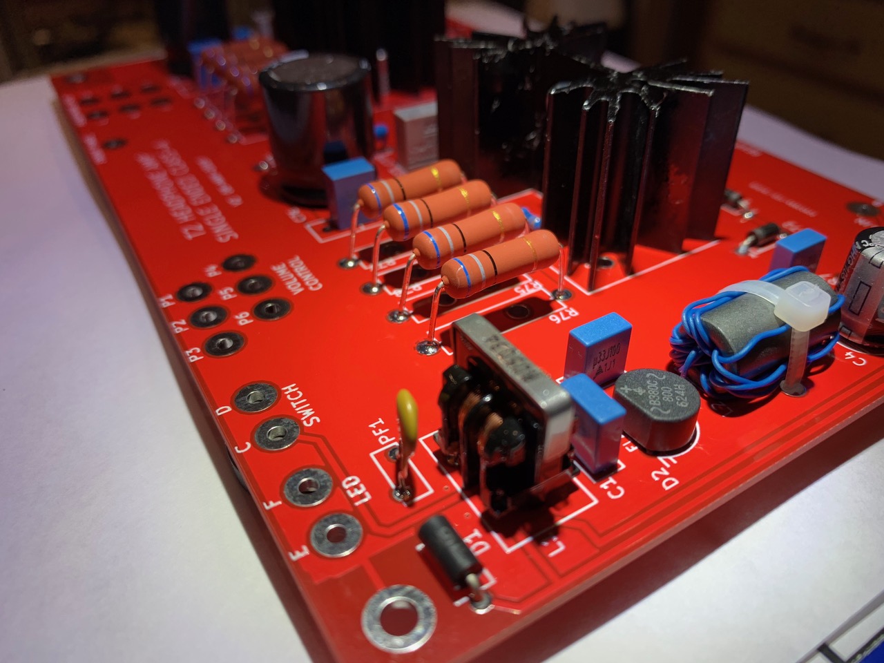

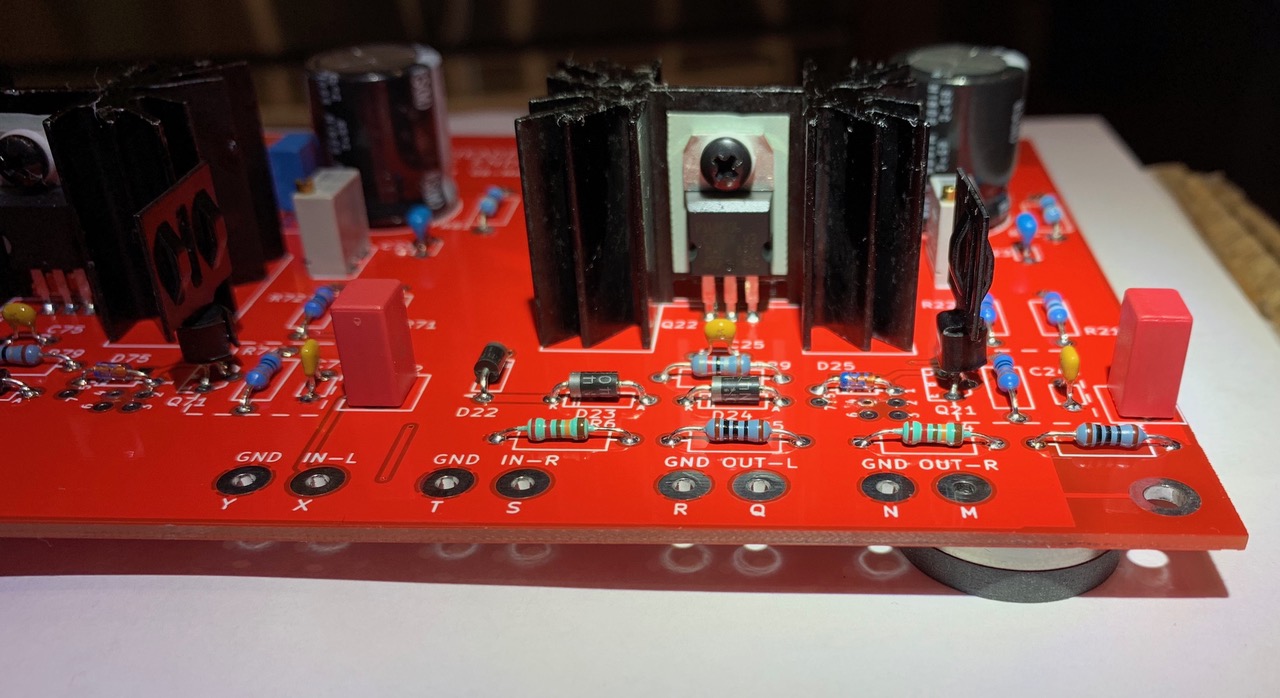

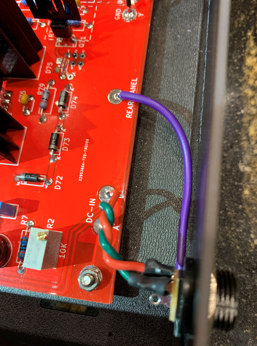

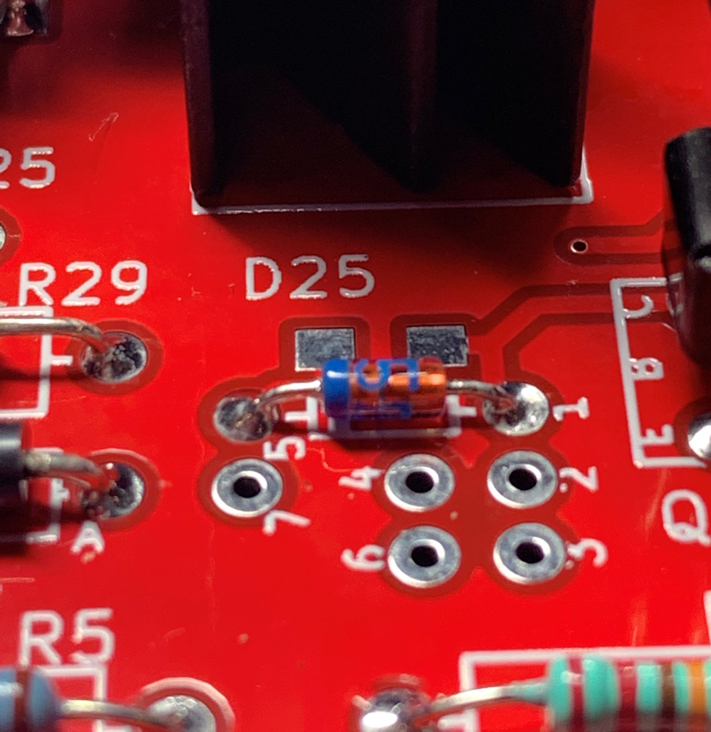

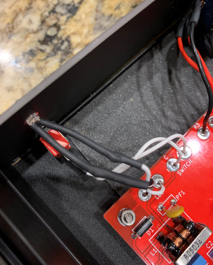

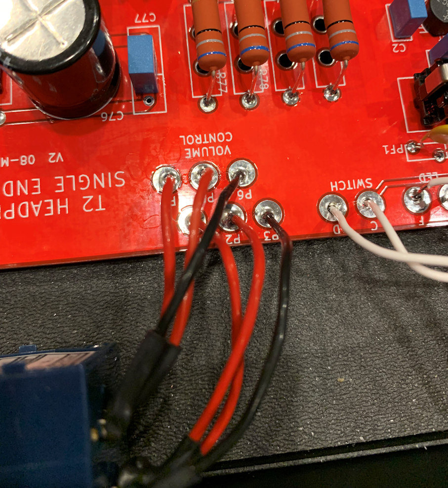

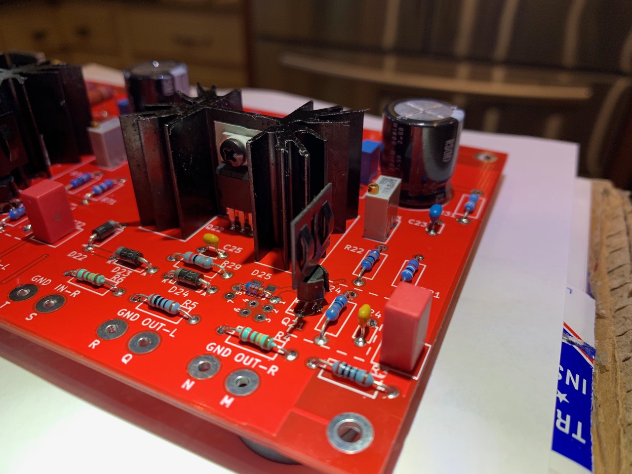

Absolutely fantastic project!
Here is a populated Mouser cart to build the T2 - Mouser Electronics
I'll have photos and insights to add to the thread soon.

Nice project and looks like an ideal build for someone looking for a complete ready to go project with shipping cart and case.
I think the DCA Headphone Amp satisfies almost all your criteria except premade front and rear panels. But I find that $30 CNC all alum HP amp cases on EBay/Aliex work with minimal mods or fuss.
xrk971 Desktop Class A (DCA) Headphone Amp
To be all through hole requires use of TO92 JFET instead of BF862. But those are the only SMT and not hard to solder.
145mA bias is possible with change to source resistance but it runs nominally at 125mA which is plenty.

With so many turns through your L2 I can't help but think you're saturating it. How much current is the circuit taking (I see you said its under 400mA but how much under) ?
Here is the full line catalog from Laird Performance Materials pdf link. The exact Laird part used in the T2 circuit is listed (a) on the schematic; and also (b) in the Bill Of Materials.
The curves and graphs and explanations in the catalog, may help you decide whether any ferrite bead designed for EMI suppression, might ever undergo "saturation" when subject to DC current flow {as in the second stage of the T2 power supply filter}. If saturation can occur, at what number of amp-turns does saturation become a problem for EMI suppression beads? Surely Laird customers would want to know, and surely Laird would provide this information.
In the catalogue you linked, they do say this :
WHEN POSSIBLE, INSTALL A CABLE CORE OVER WIRES IN A COMMON MODE CONFIGURATION
(Out and back lines inside the same ferrite cable core). A differential cable pair inside the same core will make the ferrite core a
common mode choke that is not susceptible to saturation from very high currents.
So they're at least admitting the possibility, right?
I couldn't find any data in there about where the core might saturate but its possible to go back to first principles to work it out.
28 Gauge wire stripping / sourcing
The AWG-28 wire which I sent to the two Beta Testers, to wind T2's power supply choke "L2", was taken from CAT-6 ethernet cables. It's teflon insulated, silver plated, stranded wire. Very high quality stuff!
But, not so easy to strip off the insulation. Teflon outside + stranded inside == difficulty for many $15 wire stripper tools. Sometimes these tools cut the wire instead of stripping it. Sometimes they cut 30% of the strands while removing the insulation. Sometimes they stretch and deform, but don't actually remove, the insulation.
Old baxtards like me, who use plain ordinary diagonal cutting pliers to strip wires manually "by feel" (i.e. after lots of practice and lots of mistakes), will have no special difficulty with stranded CAT-6 wire. And anyone can get pretty good at it by a bit of practice. Strip one of these wires 20-30 times, and notice what works & what doesn't. What gives nice clean strips with no cut strands? How does it feel in your hands, when you're doing it right? Remember that feeling.
Another way to go, of course, is to use solid core AWG-28 wire. Low cost wire stripping tools perform beautifully on this stuff. Remember that hobbyists used to build their prototypes with Wire Wrap (30-AWG solid core wire) and they had no trouble stripping it, at all. So, if you don't want to learn Wire Stripping By Feel, solid core AWG-28 is a viable option. Plus it makes excellent hookup wire for preamps, line stages, headphone amps, and other projects that don't pump ten watts into eight ohms. I bought this kit of ten different colored spools of 28 gauge solid core wire, from Remington Industries. Its insulation is a little thicker than the stranded CAT-6 wire, so you may not be able to not get a full eleven turns through the L2 core. But that's the tradeoff you make in order to have easy wire stripping.
https://www.remingtonindustries.com...wire-28-awg-stranded-kit-10-colors-25-length/
Shipping inside the US was very quick, I received it 3 days after ordering. If you live somewhere else in the world, scout around for a local source. I hope you are able to find similar quality at similar prices. If not, you still have the option to learn Wire Stripping By Feel. Then buy CAT-6 ethernet cables locally, they're cheap everywhere.
Finally, I should mention that it only takes 3 minutes to wind eleven turns around the L2 core. If you wind the choke and then have a mishap when stripping the ends, so what? You've lost $0.01 worth of wire and 3 minutes of your life. Unwind and discard the old wire, and try it again. 3 more minutes. Then strip it again and have better success!
Good stuff! Here is another similar possibility, on Amazon:
28 AWG silicon stranded
28 AWG (and they also have 26 and 30 AWG available, it appears) 5-color silicon-insulated wire for $16, with the "free" prime shipping. I use 26 AWG silicon wire for hookup in one of my projects here and just love the stuff. Flexible as a wet noodle. 🙂
The silicon insulation cuts well too with standard (well, Greenlee stainless 1917-SS cutters, a little better than Walmart 😛) wire cutters. The silicon is often fairly high temp too, won't shrink back when soldered. I've never bought this brand before. I wonder how the thickness of the insulation stacks up to the PVC though - would 11 turns still fit in the core? Hmmm.
Also - click on the "compare with similar items" below the description, that brings of several more brands of similar.
Just a thought! Going to be a fun project. 🙂
That silicone insulation wire is great stuff. It is used for super high current (tens of amps) DC motors in RC cars and helicopters. The flexibility is provided by the very small diameter strands of wire and the soft silicone which is heat resistant. I use it for flying leads to off board mounted power MOSFETs and BJTs. Usually 16ga or 18ga for the multi amp applications. This allows flexibility in mounting transistors on a heatsink at a different location than the PCB.
Very good work, Mark! 🙂
Why would anyone want to design/construct an amplifier that uses a big ole' nasty 3300uF output coupling capacitor??😕
If it's not a DC-coupled output design, I'm not personally interested in it, but other members here may not give it any consideration whatsoever.
I see you have heatsinks on the TO-92 devices.
I assume this is because your are operating them near their maximum dissipation and potentially helps keep them from self-destructing?
Gee-gosh golly - what a blindingly original concept. I don't think I've seen anything remotely like this...
Except perhaps here...
Simple Single-Ended Headphone Amp
