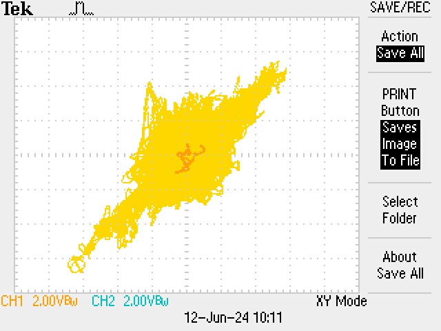

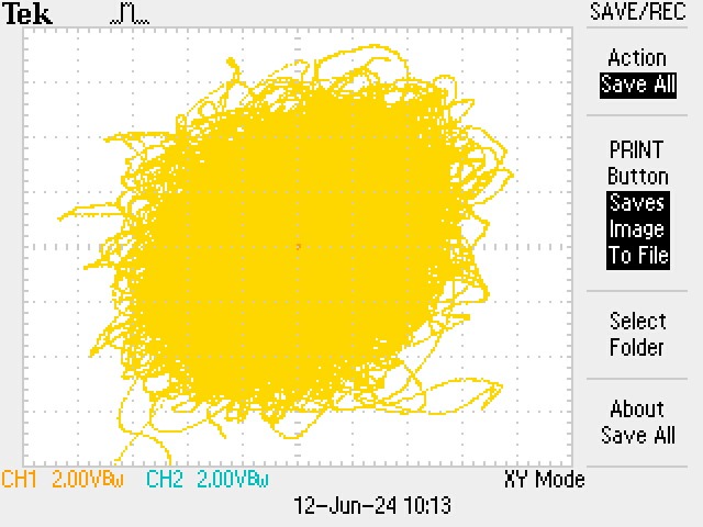

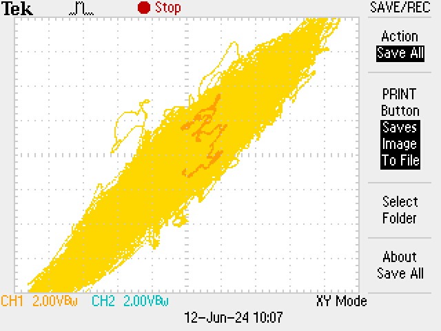

XY pictures of the channel separation of Stereo Music CDs, to show how little some stereo CDs are,
and how good other CDs are.
TEK0026.JPG Very Little channel separation Kurt Elling "Night Moves", cut # 1 song = album title
TEK0027.JPG Lots of channel separation Walton: Belshazzer's Feast, cut # 5 "Thus in Babylon" Naxos
TEK0025.JPG Medium channel separation
You can see the difference in channel separation.
And, the sound difference is easily heard. TEK0027 was used in group listening sessions. Someone commented that the recording had real good separation.
Get the Naxos CD listed above, and check out the sound of the channel separation (you will be pleasantly surprised at the spaciousness).
As always, Have Fun!
