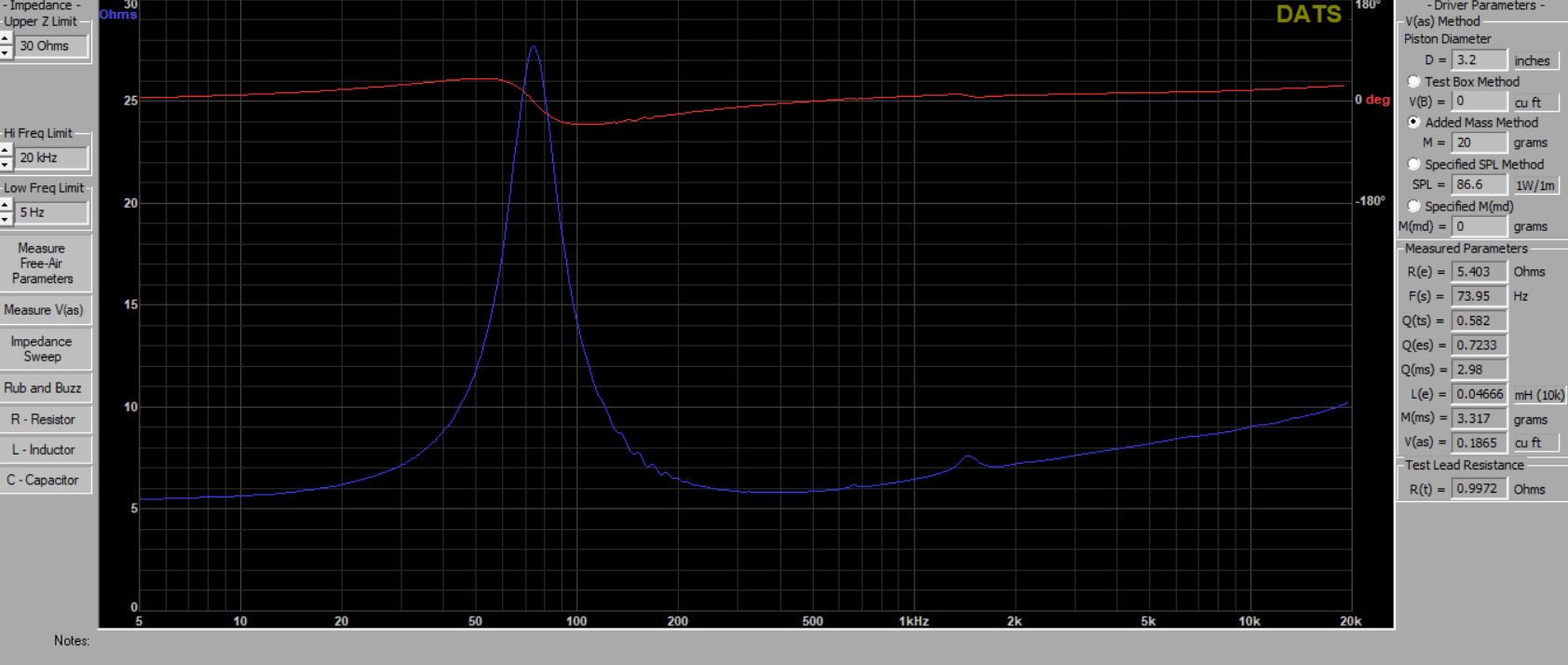

I received my Pluvia 7HD driver, did a bit of break in, measured the T/S parameters and proceeded to design a test box for it. After measuring and thinking about everything, it just wasn't possible to build anything flat enough. The Pluvia is a fairly deep driver for a small 4" so the thinnest I could possibly get a box was about 3 1/2" and that would have put the back of the driver right up against the back of the speaker box, and of course made it next to impossible to get a good sound.
Here is a pic of the measured T/S parameters and the impedance.

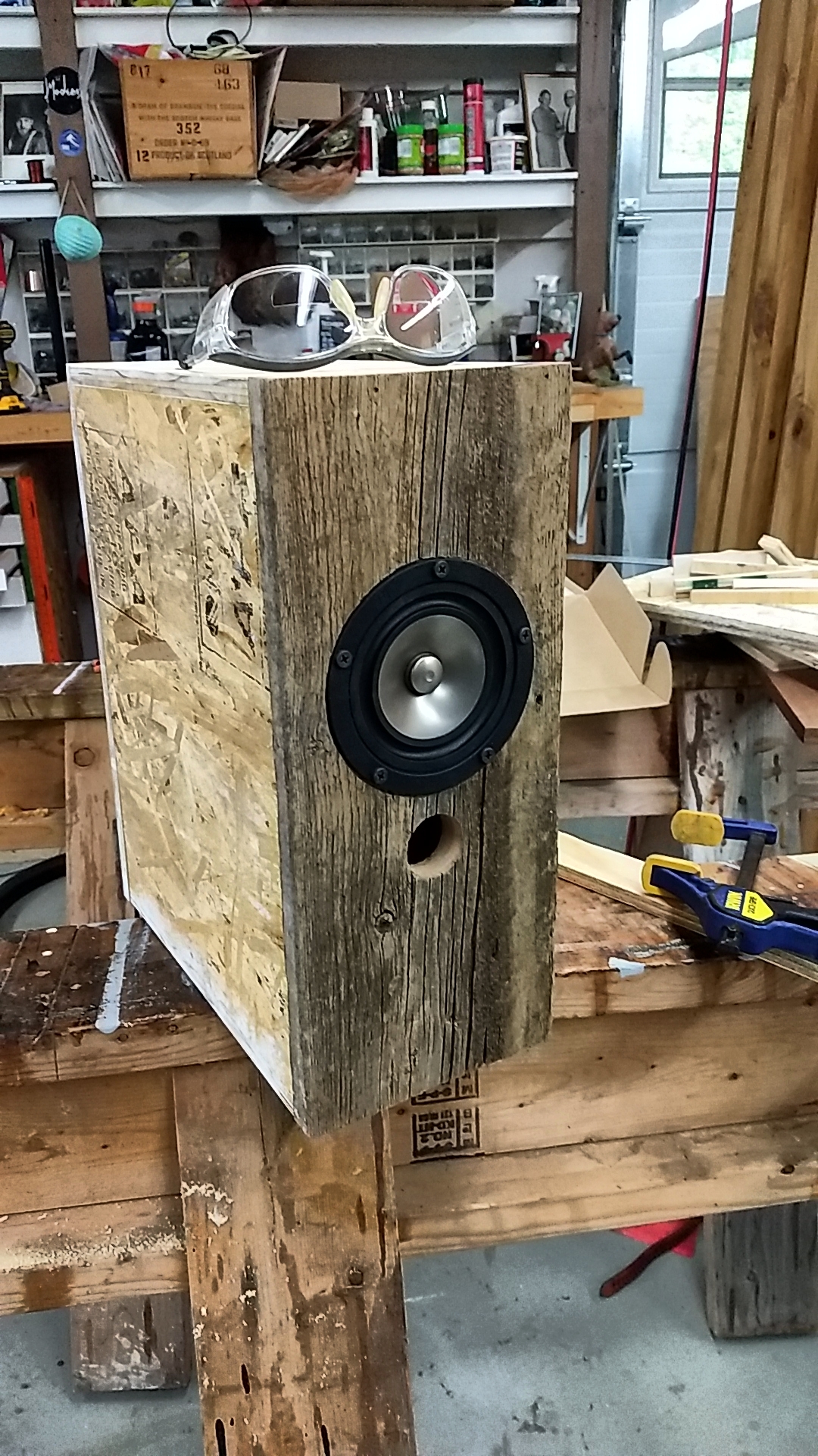

In looking at my space, I decided to cut out the sheetrock on either side of the center stud and build two boxes. If I did that, the boxes could also be used as small stereo speakers should they not work out as well as I hoped for center channel use. Instead of purchasing the 2nd Pluvia, I just wanted to build the first one as a test to see how it sounds and to test fit it into the hole.
The room is a rustic room and I had a piece of barn wood in my shop that was perfect (enough left over for the 2nd box too). Since the rest of the box will be hidden behind the wall, it can be built out of anything. Again, I had scraps in my shop I could use.

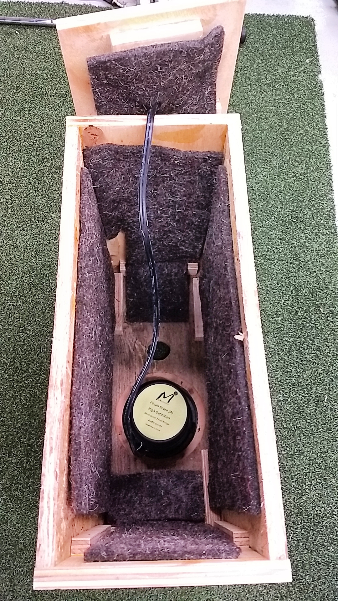

In designing the box, it turned out that a standard bass reflex box could be built with a port that was only the thickness of the front panel, so I didn't need to put a port tube in it. Here is a pic of the box and inside before I added stuffing, which is just a bit of polyfill.

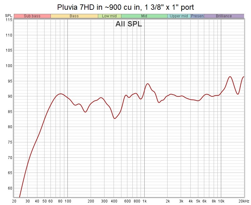

After assembly I took some measurements. Here is a frequency response graph with psychoacoustic smoothing. This is the straight measurement without windowing in my shop.
and a frequency response from the close measurement + the port measurement + the in room measurement above 800hz.
Fairly close to design parameters, you can see the baffle effects around 1K in both graphs, the rest looks pretty much like the models predicted. Since I'm going to mount this flush to the wall the baffle step will largely be diminished. The dip after the baffle step, which is around 1.6Khz, and the peak at around 13K are both similar to the published graph from MarkAudio.
Subjective listening to the speaker, it's pretty good. You can hear the 1Khz peak a bit, the 13Khz peak is not noticeable for old guys like me 🙂 The low frequency hump provides a pretty good "room curve" so it's quite pleasant to listen to.

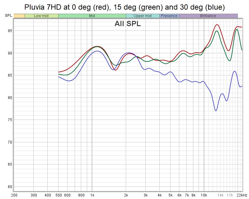

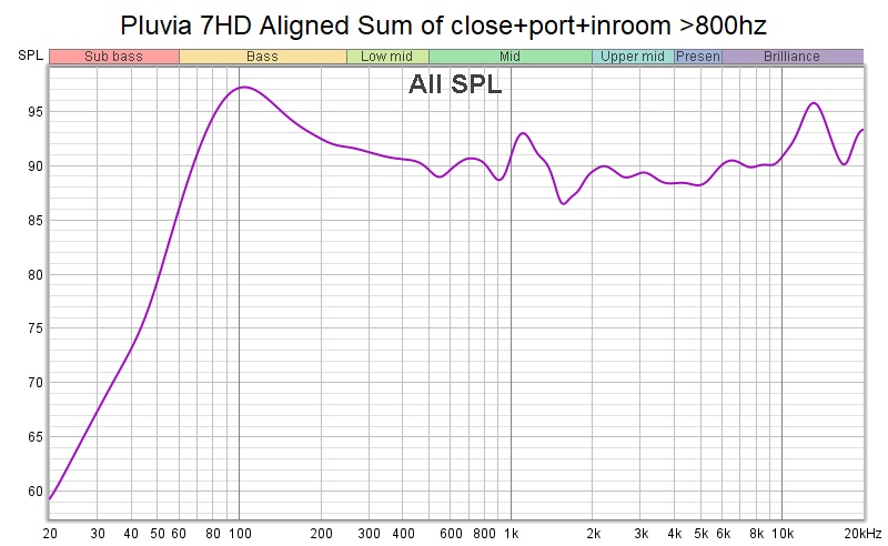

For off axis performance, which is key in my use of it as a center channel, I did the measurements with the speaker on it's side as that's the orientation for center channel use. Here is a graph of 0 degrees, 15 degrees, and 30 degrees.
This is a bit disappointing. I need to go back and remeasure to make sure something wasn't amiss with the 30 degree measurement. That big dip at 13K probably won't hurt the center channel too much as it's focused on voice. But the drop from 2.5K to 10K is much more concerning.
