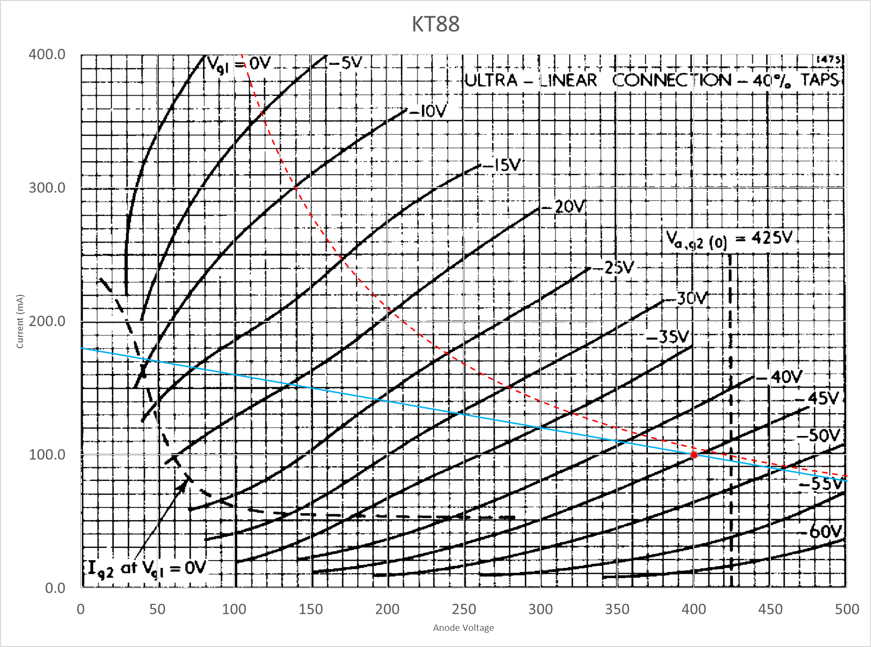

I am interested to hear about any user experiences or advice regarding output transformer impedance and B+ combinations for KT88 singled ended ultralinear operation.
My current amp is running EL34's with a 5k transformer right on the limit, with 412V across the tube and 60mA bias. I am very happy with the performance.
For the next amp I was contemplating running KT88's with a 5k transformer, about 400V across the tube and 100mA. However, looking at the KT88 datasheet it seems this tube might be most comfortable with 2.5 to 3k and 250V-300V across the tube.
I'm intending to run local cathode feedback on the output stage.
Interested to hear what you're all running.
Also can someone please explain the significance of the dashed lines on the curves below? I take it 425V is the highest voltage I can run across the tube and ther other one is presumably showing the grid 2 dissipation limit under some conditions I don't fully understand.

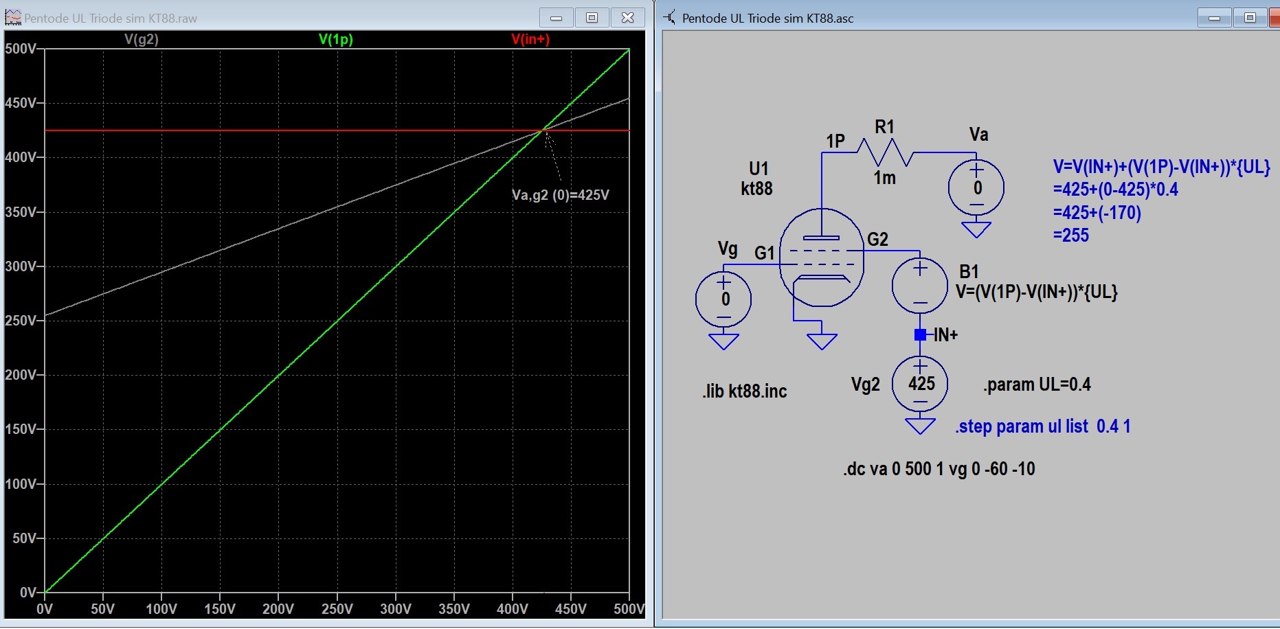

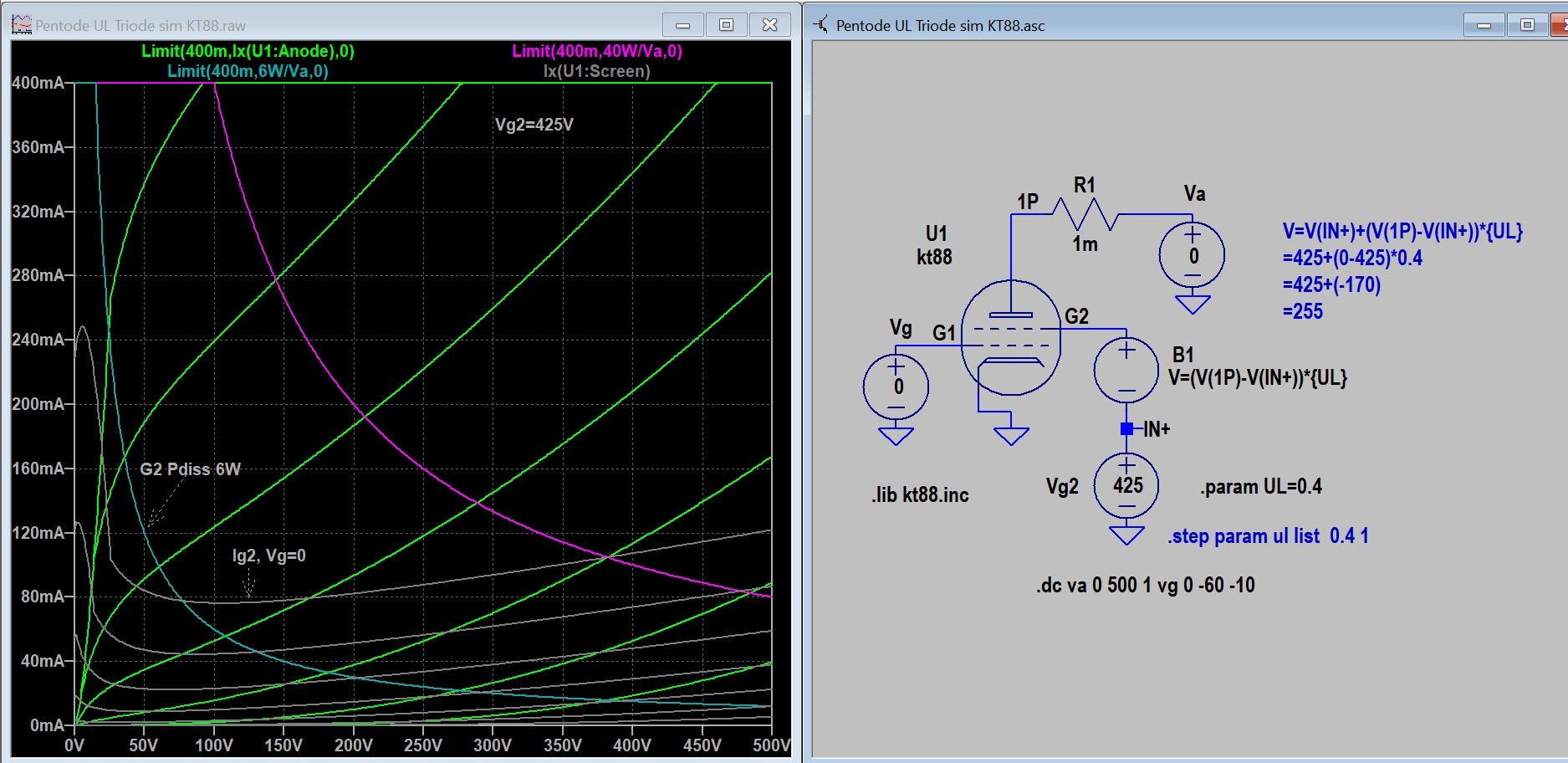

I attached 2 snapshots see what you can make of them. The screen voltage can be equal but not more than anode voltage , provided the total screen dissipation (under DC and AC condition) is not exceeded, so if Vg2 is 425V the screen current is about 11mA. Reduce cathode current will reduce screen/anode current proportionally (when Vg2 is same as Va) so they are both within dissipation limit.
I try to sim UL mode SE, OT impedance can be as low as 1.6K but the gain drops, increase distortion by 0.5%, power out reduced by 2 (6-4) Watts, but damping factor improved.

Thanks Koonw, that makes sense.I attached 2 snapshots see what you can make of them. The screen voltage can be equal but not more than anode voltage , provided the total screen dissipation (under DC and AC condition) is not exceeded, so if Vg2 is 425V the screen current is about 11mA. Reduce cathode current will reduce screen/anode current proportionally (when Vg2 is same as Va) so they are both within dissipation limit.

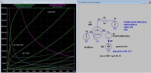

I wish I could use LT spice that well! Any chance you can share the ASC files here?

Sure they're attached here. Remove ext .txt and open plot in correspinding simulation.Thanks Koonw, that makes sense.

Thanks for that Koonw, will give them a go.Sure they're attached here. Remove ext .txt and open plot in correspinding simulation.

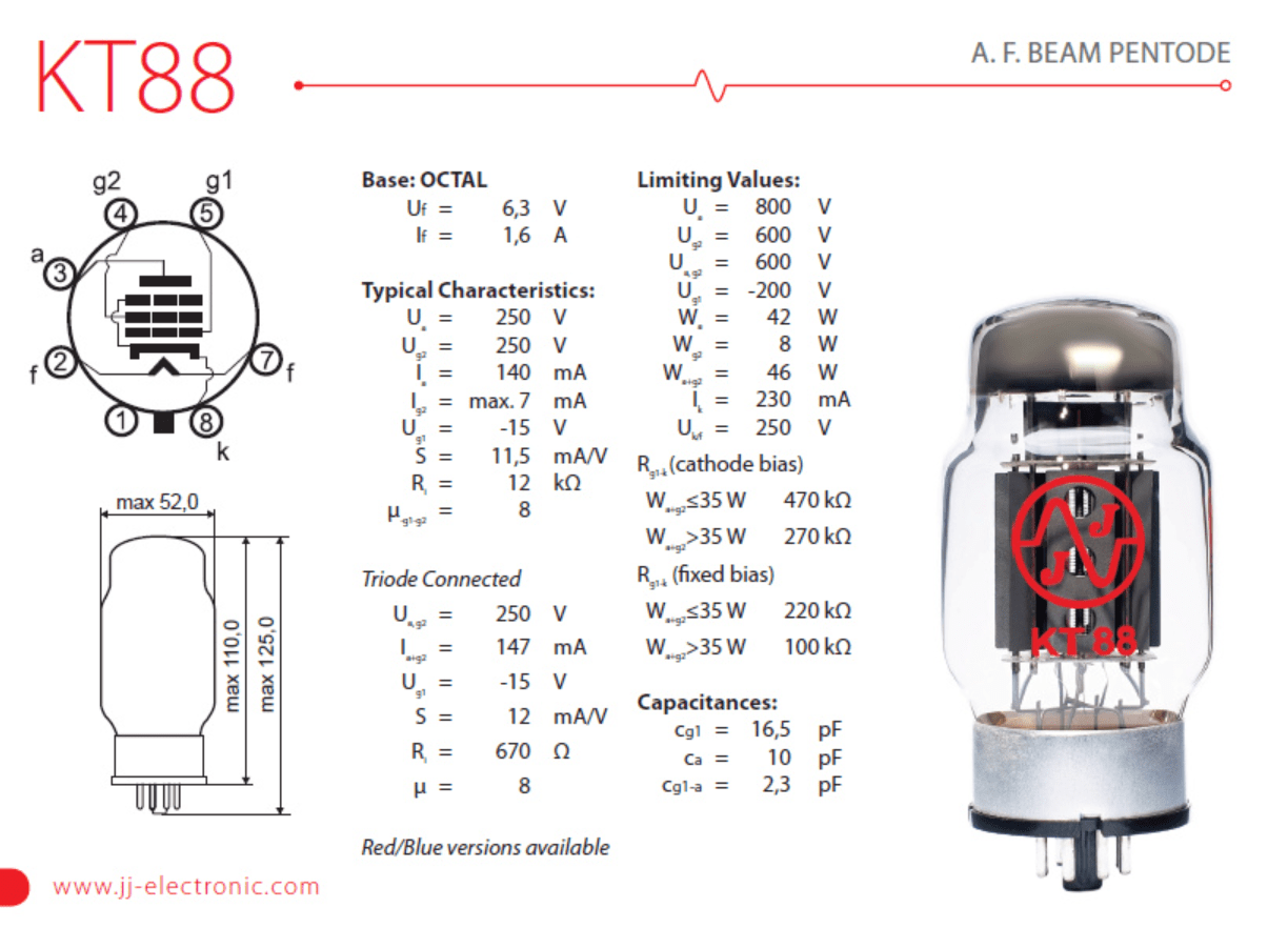

That's 40W or 114% over the tube's rating for a KT88. I've run KT88SE at 80ma with 410V across the tube into a 5K load and it sounded great.For the next amp I was contemplating running KT88's with a 5k transformer, about 400V across the tube and 100mA.
Thanks Steph,That's 40W or 114% over the tube's rating for a KT88. I've run KT88SE at 80ma with 410V across the tube into a 5K load and it sounded great.
The absolute maximum dissipation is 42W but I see the genalex datasheet does list a design maximum of 35. In that case I'll run it at 33-34 or so. Still tossing up the exact voltage and OPT configuration, it's tempting to try going for more output power this time and run some feedback....just to see what it's like. Hmmm....

Well if you want to get picky, it's 41.2W... I was just pointing out it will likely red plate at what you intended to run it at.Thanks Steph,

Yep, I agree. As I said I missed the recommmended design maximum of 35W on the genalex datasheet - the JJ one I had been using doesn't mention it as pe below...Well if you want to get picky, it's 41.2W... I was just pointing out it will likely red plate at what you intended to run it at.
Actually....looking at it again are you sure it can't do 42W? It even provides grid resistor values for use over 35W....I think?
Different manufacturers have (slightly) different absolute ratings. There are also three different ratings confusing many. The last common practise beofre the demise of mass produced tubes was to use the absolute maximum ratings which is approx 10% above the design center rating. If you want longevity then you might want to stay close to the design center rating.
