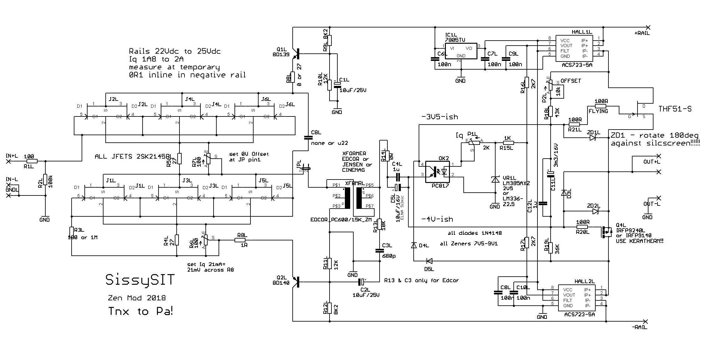

as I wrote , SissySIT ( in fist time called SUFI-SIT , but then I realized that too much seriousness is ..... too serious

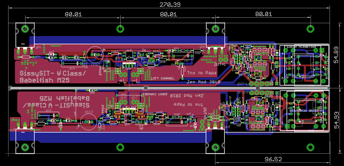

) is practically THF51-S Tokin SIT nested in Babelfish M25 circuit (even pcb) , with necessary change in some parts values .
so , schm and last/final pcb iteration are these :
(observe that I finally decided to match my pcbs to DiyAudio UMS ...... taking in account Jason's and 6L6's stance - better keeping things less complicated , than asking for few more taps in existing UMS..... so , besides SissySIT being Sissy , ZM is Mighty Sissy , doing things to save Greedy Boyz from some drilling/tapping efforts)
Everything started with collective brainstorming in Most Greedy Boy, of them all... or (there is no) DEFiSIT of Papa's Koans thread , and resulting prototype posted in #618 , Most Greedy Boy, of them all... or (there is no) DEFiSIT of Papa's Koans
Tnx to all Greedy Boyz involved ........

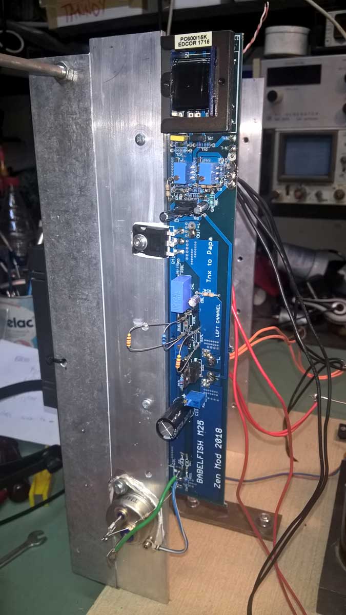

few general notes:
- yes , it is Poor Man's iteration of SIT-3
-yes, same pcb for Babelfish M25 and SissySIT , skipping/adding few parts for each and using few different parts values for each
-yes,you can choose what to use in circuit - Edcor, Jensen , or Cinemag ; see complicated xformer area - footprint/pads included for all 3 of them

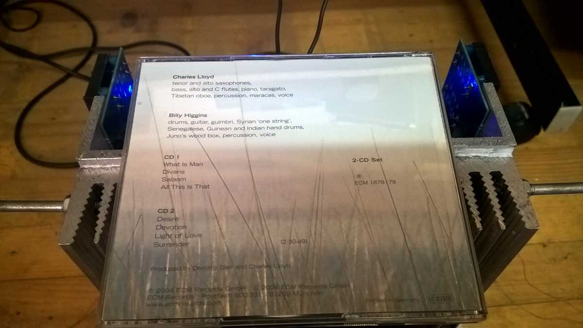

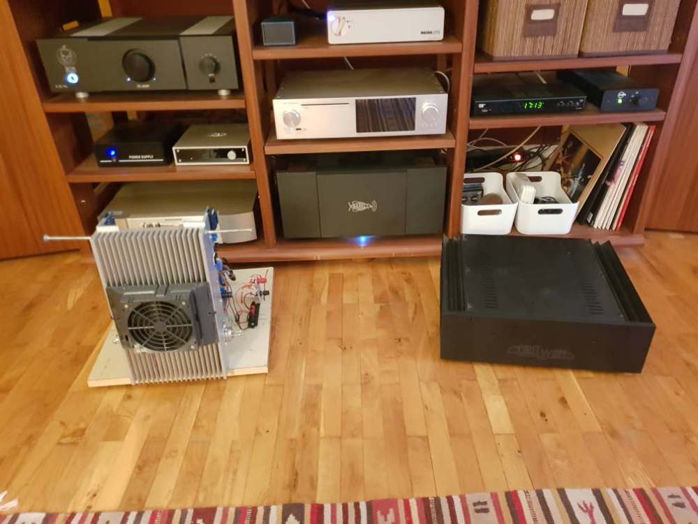

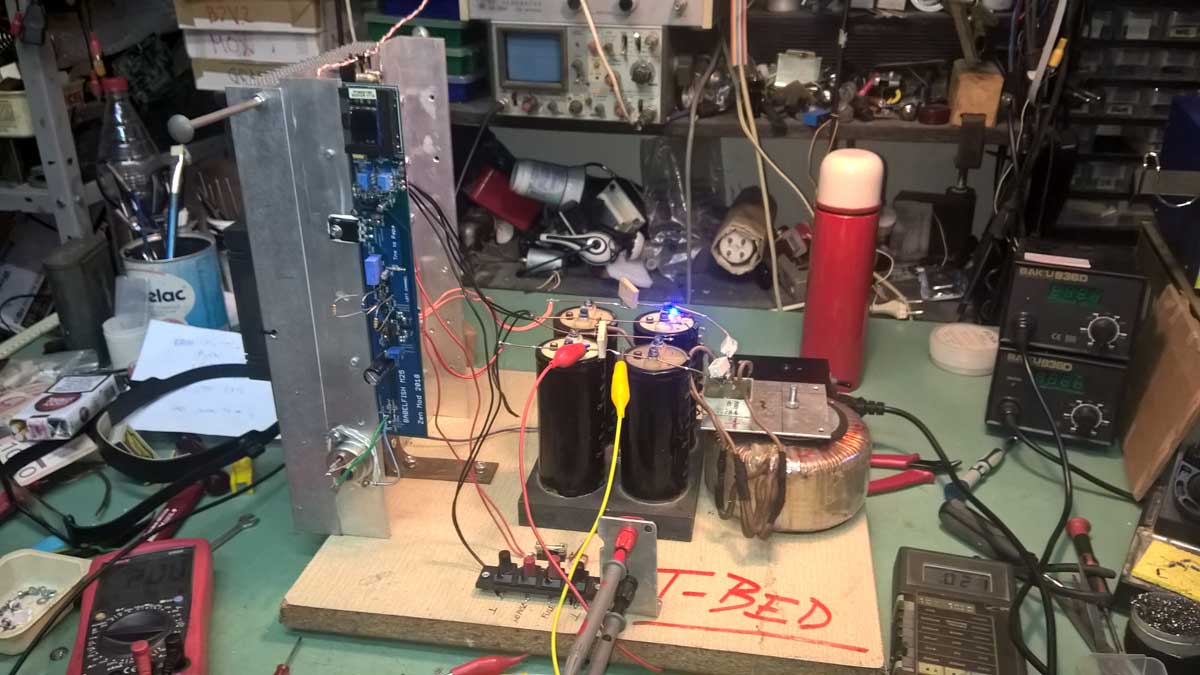

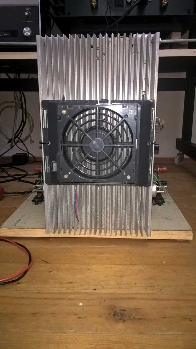

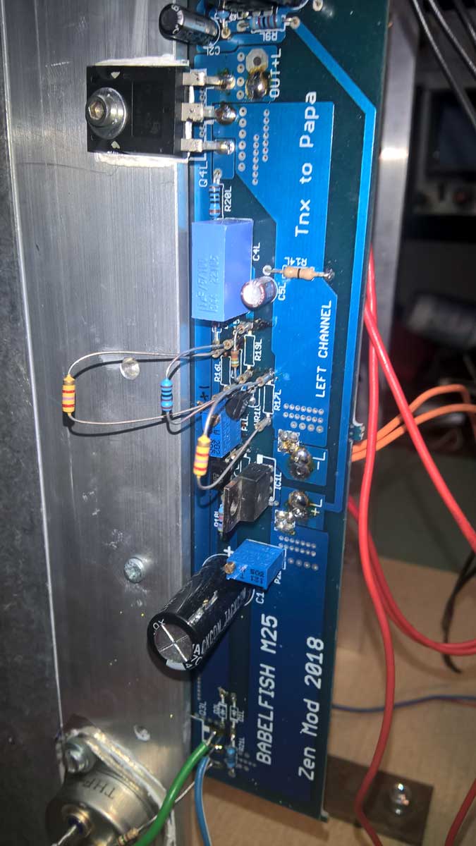

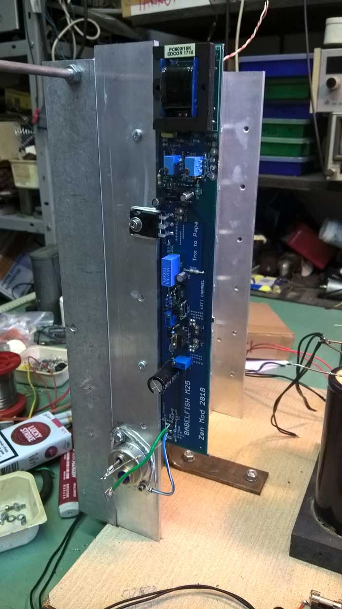

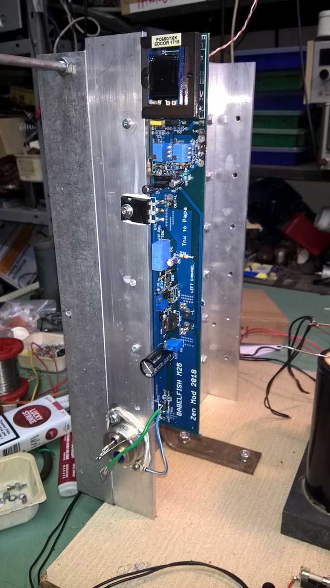

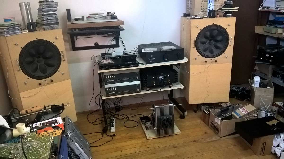

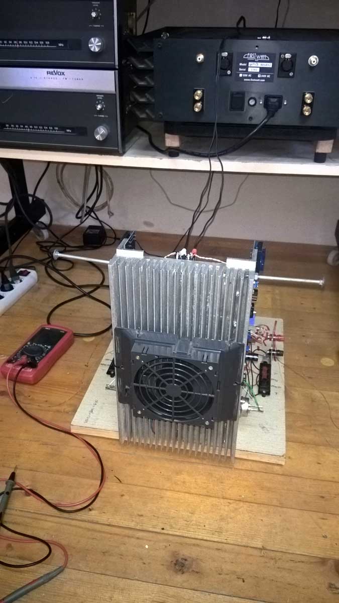

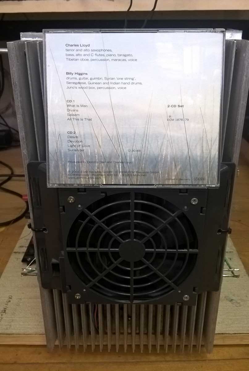

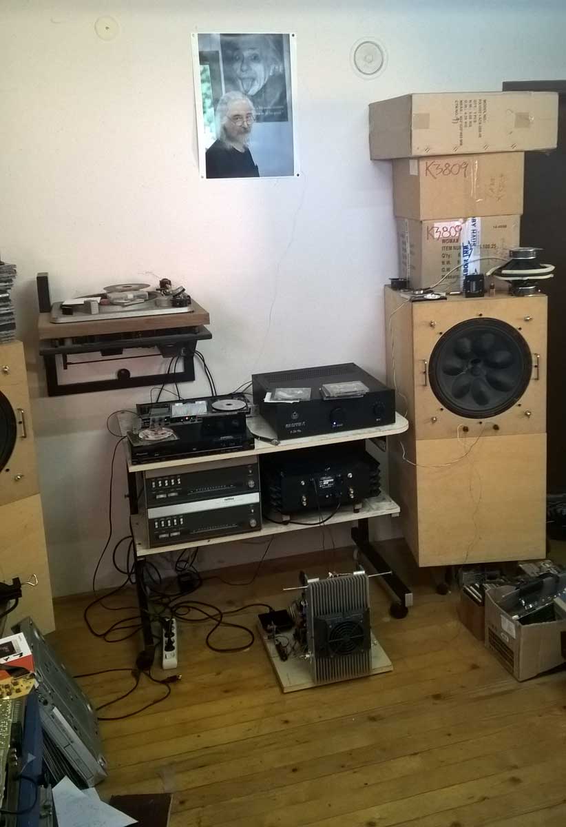

now , to keep this post more interested , placed few pics of my dear T-Bed (from previous thread) :

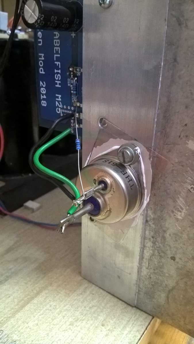

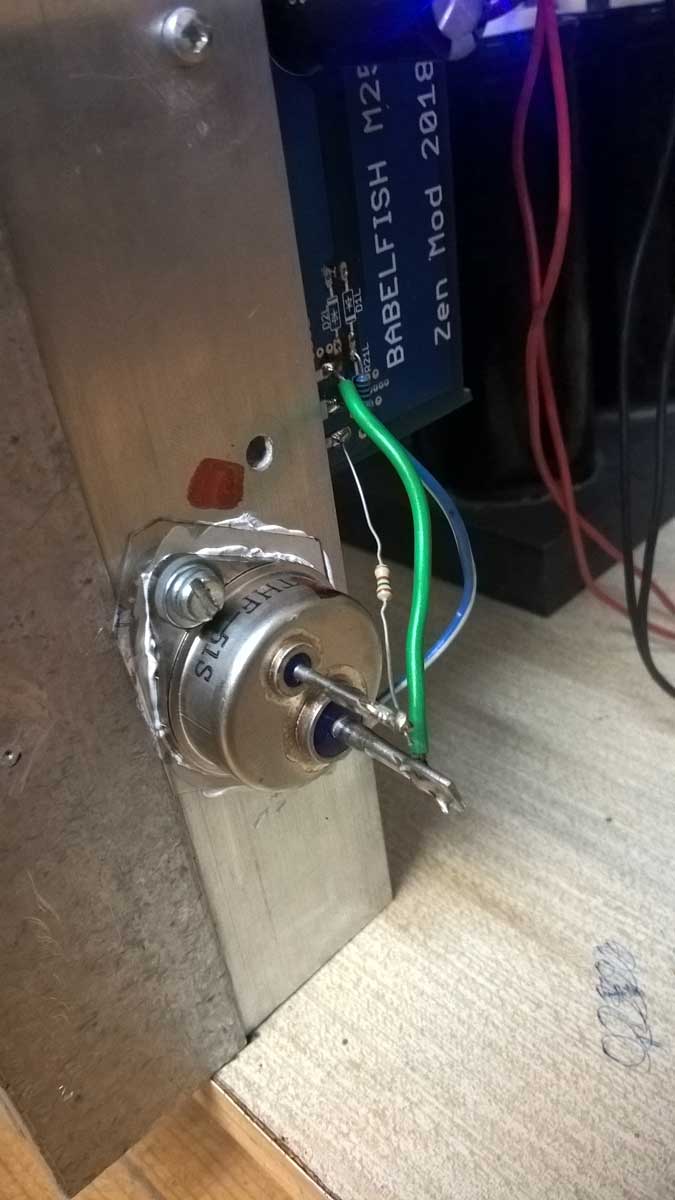

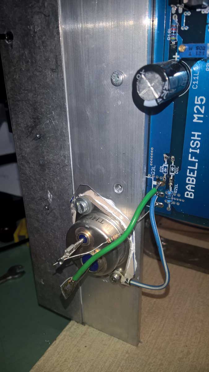

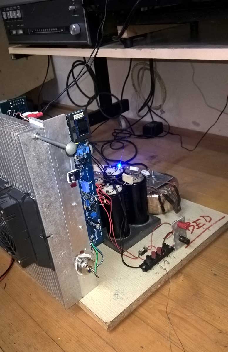

to quote myself , it was little trouble , who could expect that ........ sims aren't so precise regarding biasing network resistor values (few important factors missing in models , most important of them being gate leakage current)
so , had to heavily alter some resistor values - against values predicted by dummy sims made by even dumber operator , but solved it
I'm pretty satisfied , THF51-S not exactly being PapaSIT (read - made for sissy audio purposes) , but real tough welding drek
intended PSU is classic FW format - Donut with 2x18Vac secondaries , usually resulting in some 22V5dc rails (use CRC in filtering bank)
Iq , say between 1A8 and 2A
actual conditions in T-Bed are 25Vdc rails and Iq of 2A
due to damn big THF case , even 0.1mm thick mica is good enough for THF case being just slightly warmer than metal beneath it

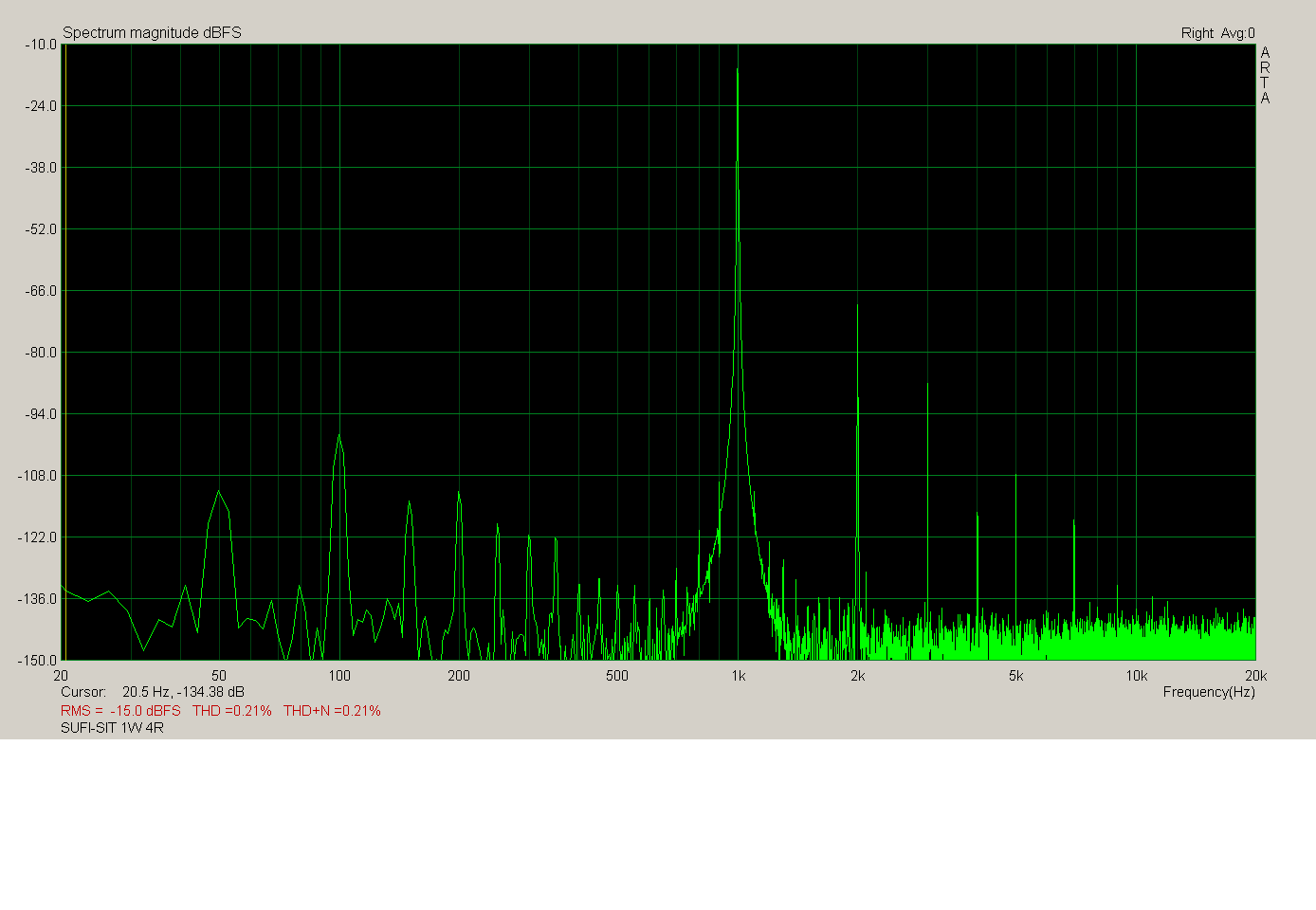

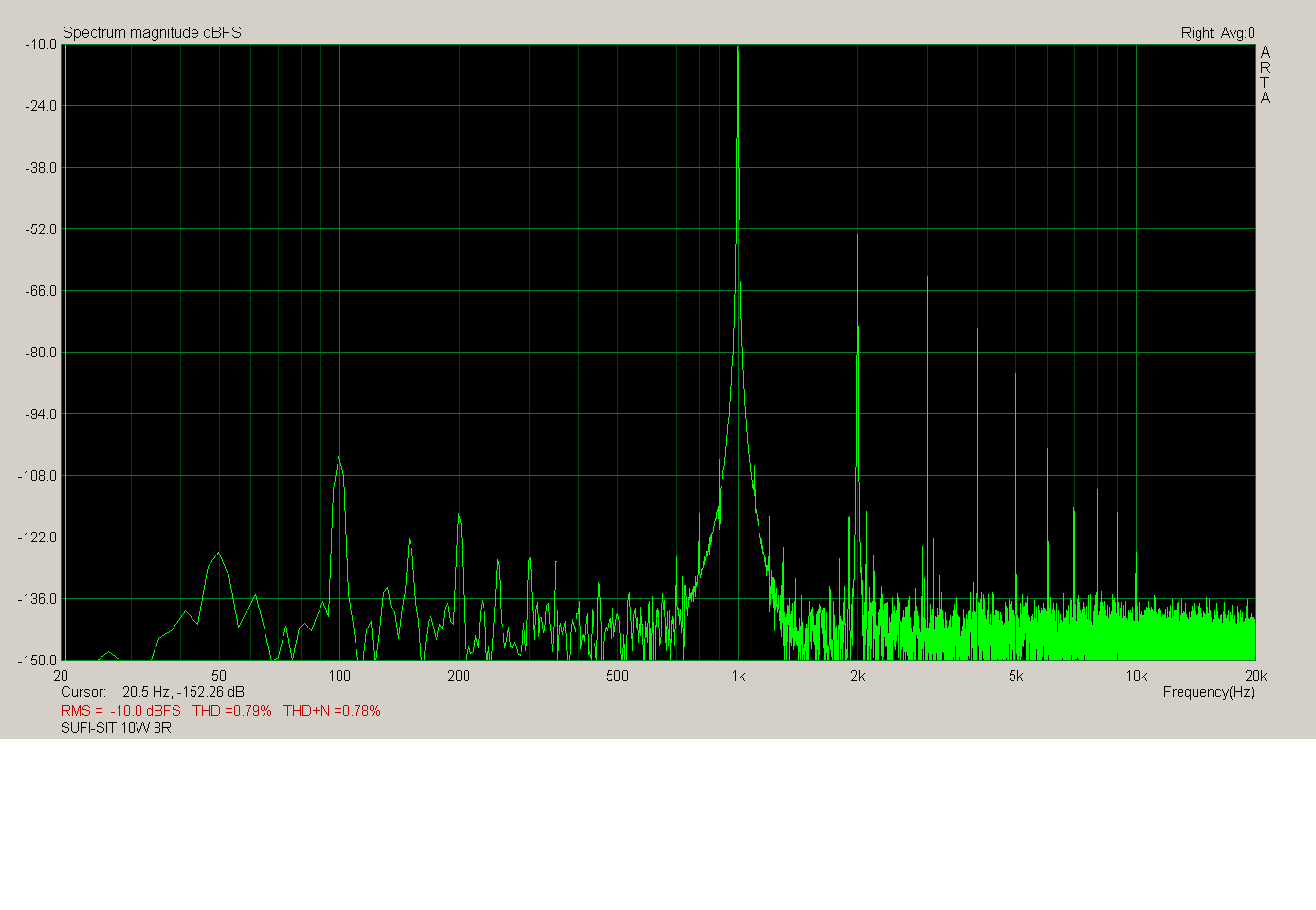

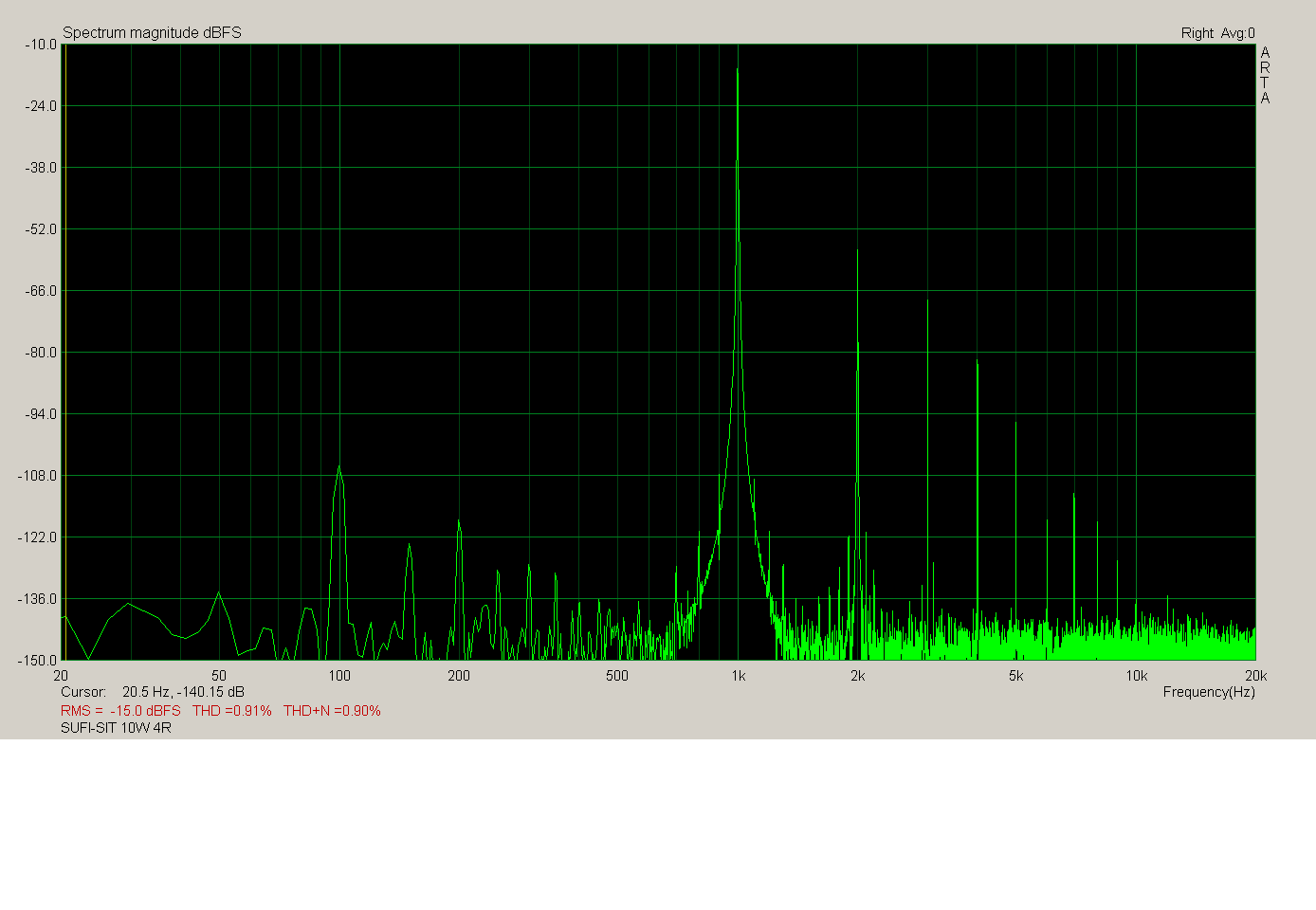

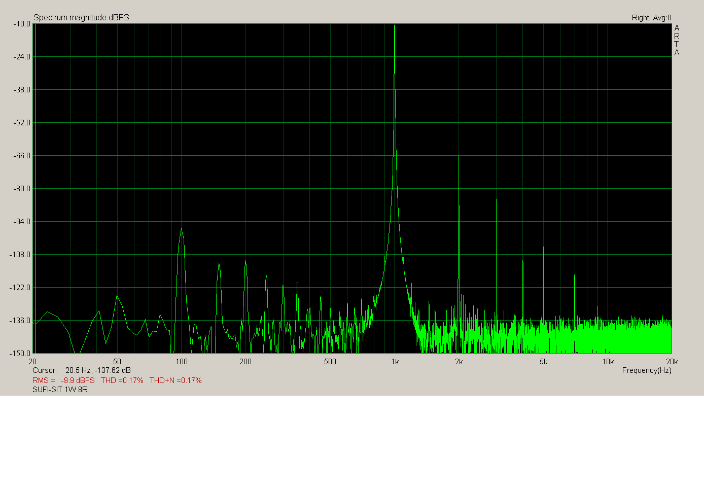

so , 1W measurements (EMU1212 , DIY interface box , ARTA) are :

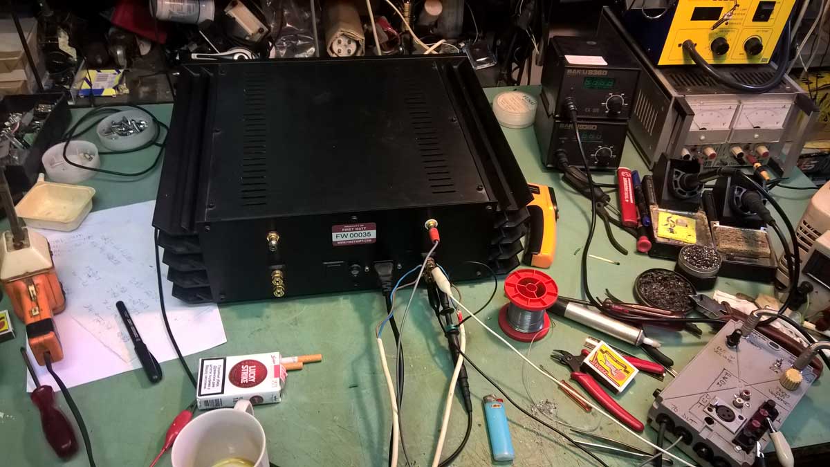

(FW SIT-3 , as reference , having approx. 0.15% 1W/4R and 0.21% 1W/8R)

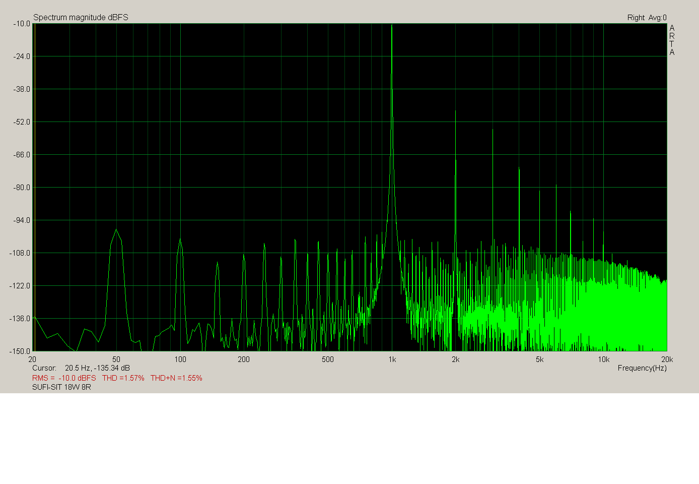

FW SIT-3 declared as 18W/8R and 30W /4R
having THD of , say, 2% at 18W/8R and 2.3%/4R

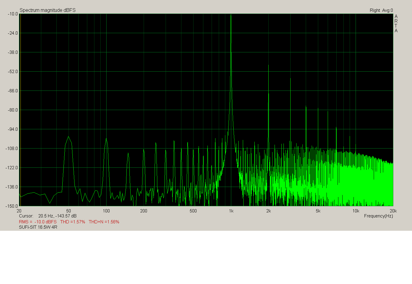

from some reason (excitement , what else) , I forgot to measure at 30W/4R .... so including what I have - 18W/8R and 16.5W/4R ..... was probably shooting for same amount of THD
disclaimer - these mesaurements made with additional 6db autoformer in-between EMU and amp; it's probably adding some THD of it's own , but who cares
edit: Tea- will answer that later , with more info
you can see from my measurements vs. SIT-3 data - difference between PapaSIT and THF51-S nature ........ SIT-3 is characteristically having lesser THD on 4R load , while THF is having lesser on lesser (8R) load ; as I see it - result of PapaSIT being developed for lower rails voltage/higher current (pretty much FW form factor/audio usage) , while Tokin Biggie being ... what it is - shaker table/industrial workhorse

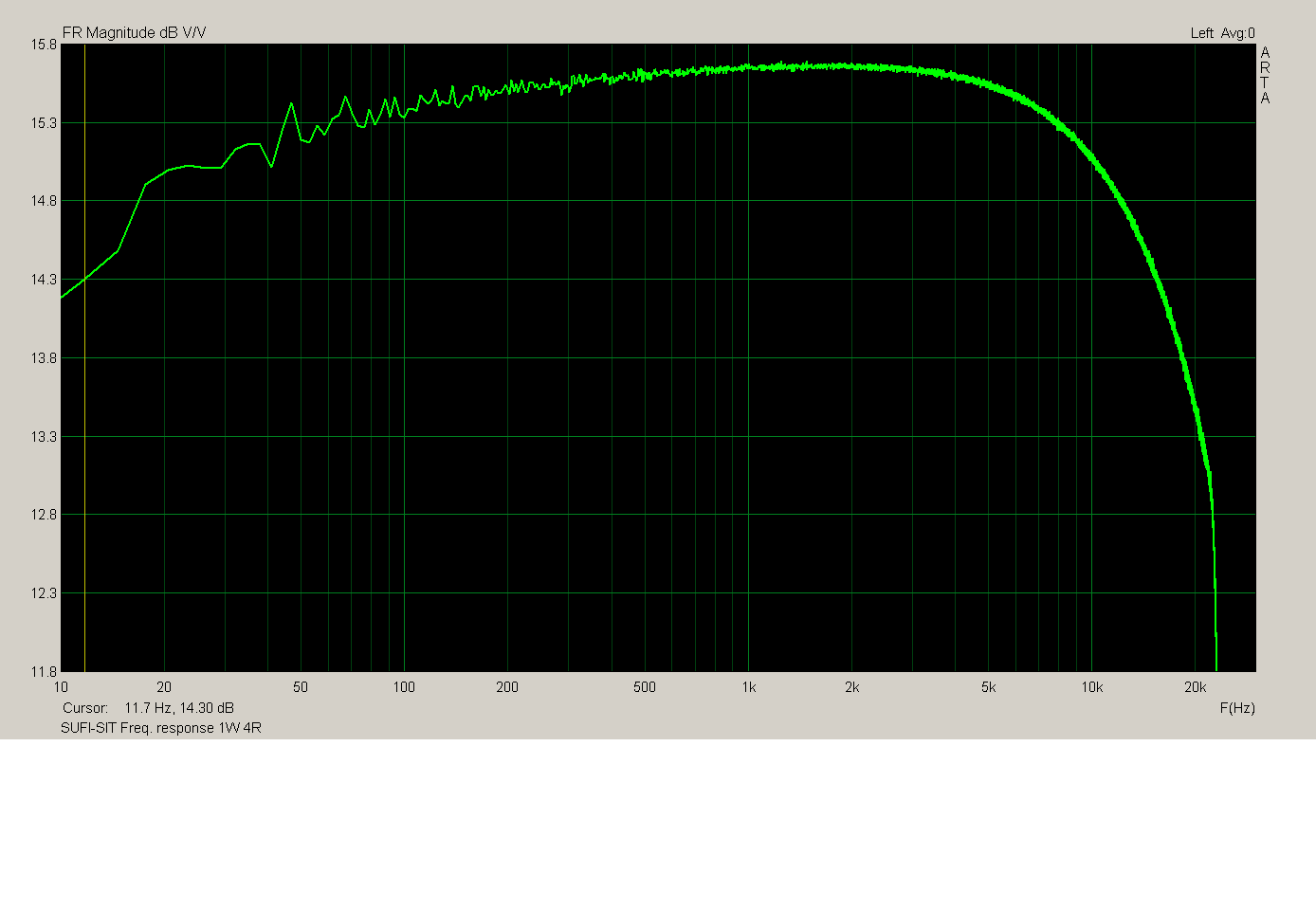

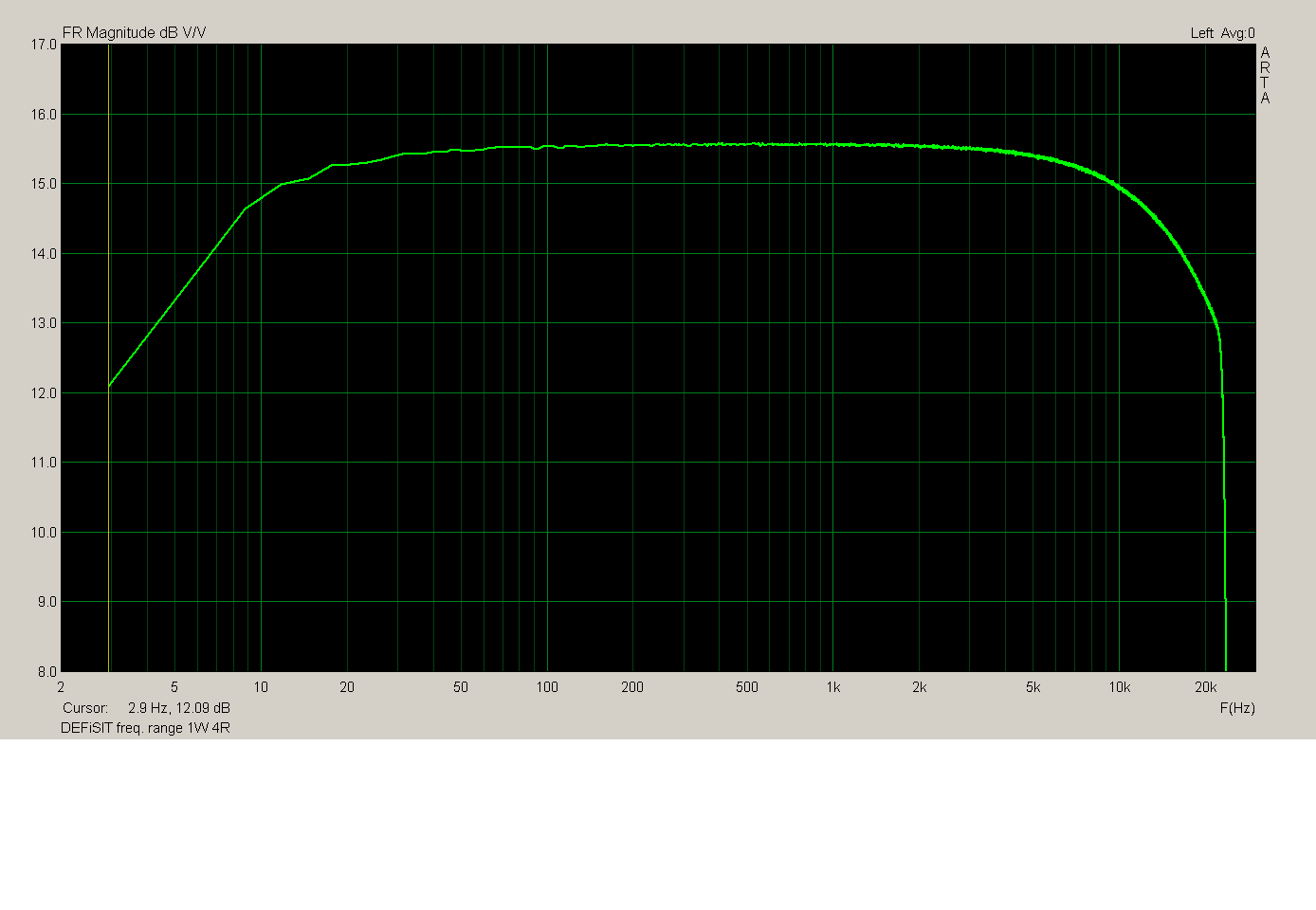

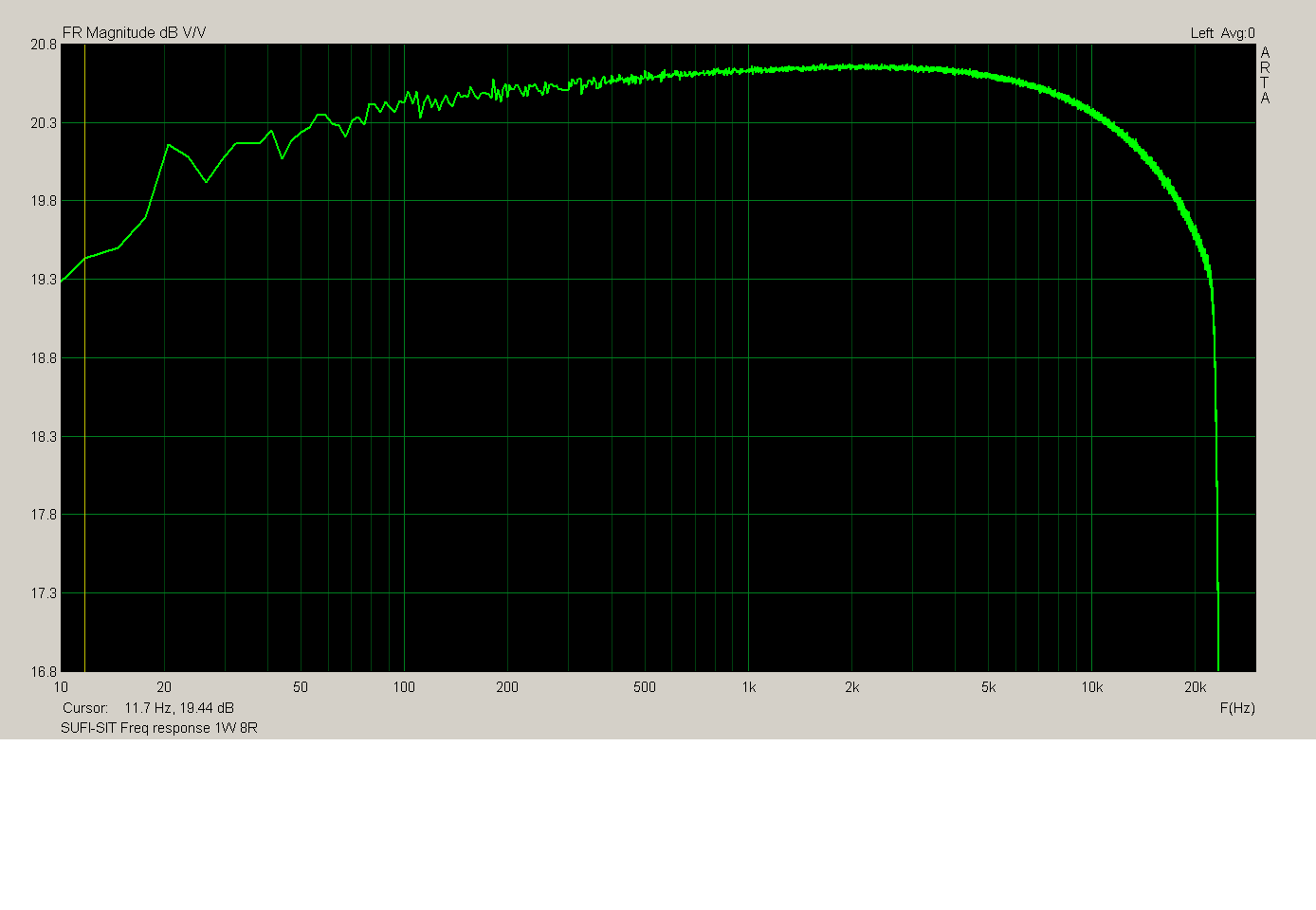

final graphs, Freq. response at 4 and 8R load , 1W

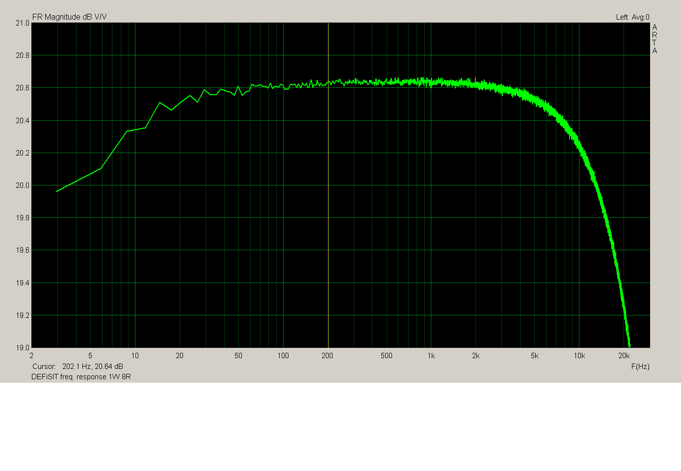

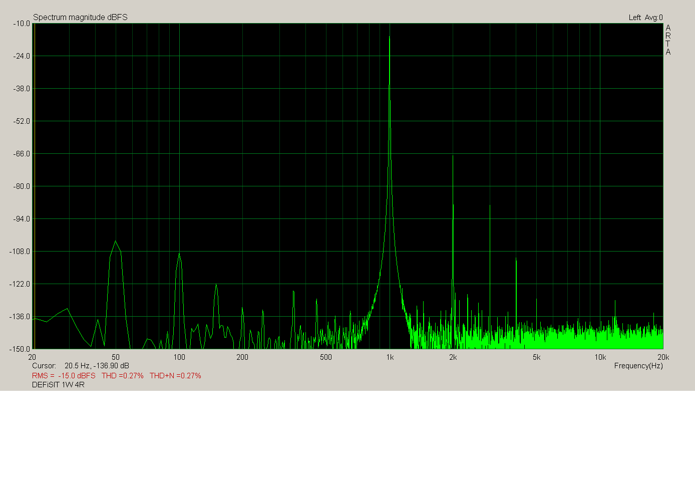

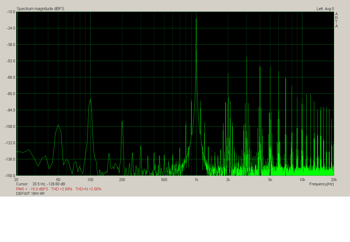

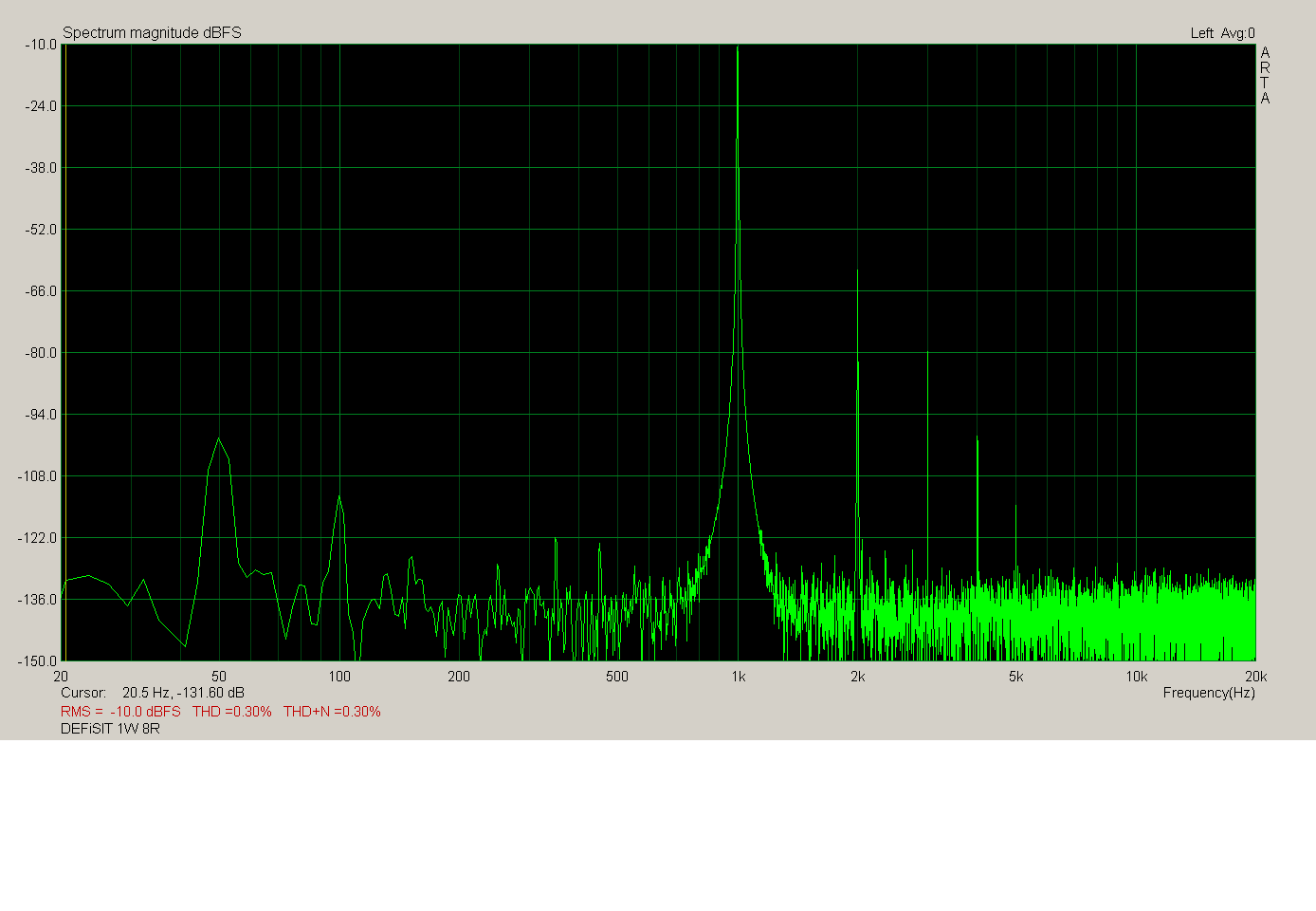

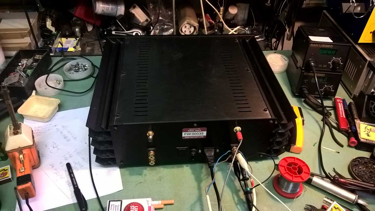

now, Tea asked for comparison with little jewel (little just in physical size , not in sound ) DEFiSIT ....... for my ears , and for my regular sets of second ears .... same magic is there ; speed , details , authority .....
maybe I can say that SissySIT is somewhat Berserked DEFiSIT , and note that all comparisons are made between properly made DEFiSIT (dual mono and whatnot, with Cinemags on input) , while SIssySIT is still "just" T-Bed iteration - with crappy PSU common for both channels , ubercrappy powerwiring and Edcors on input

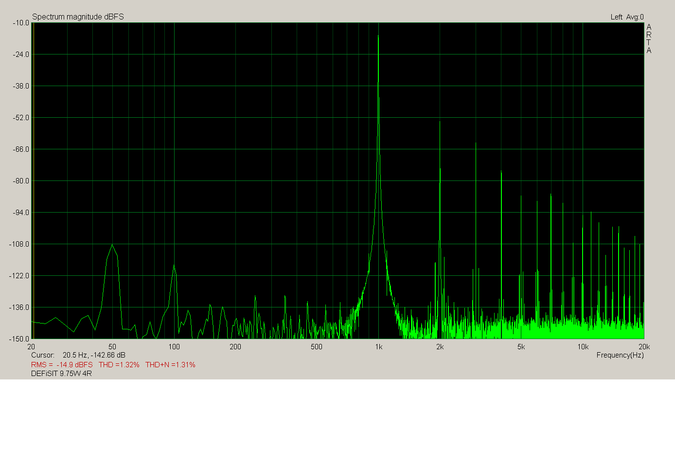

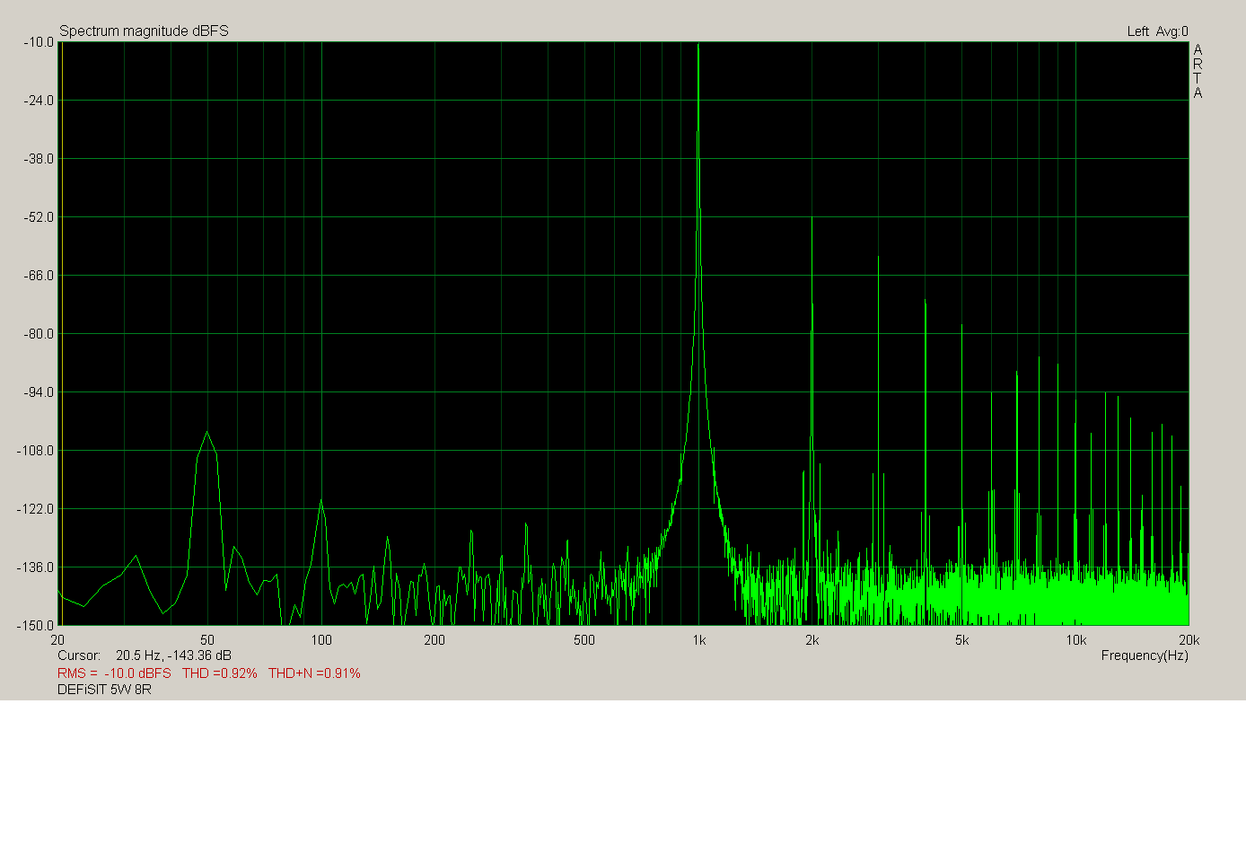

as illustration , set of measurements of my dear DEFiSIT ......
while I'm still on the Mountain , not yet arrived at peak with my fave concrete pole , to sit on , both amps are at my friend's ...... he's regular user of my Babelfish J2 , so to paraphrase his words :
-same sound character
-same musicality
-in this phase -old PSU caps , Edcor instead of Cinemag, common PSU , lousy wiring - little rougher than DEFiSIT
-space , resolution ........ everything as per wish
comparison with Babelfish J2 ...... higher level of resemblance to tube sound , but most important difference is in details presentation.... BJ2 is presenting details as is , direct to head , whily SissySIT is more subtle .... same as difference in sound presentation of Benz Micro LPS and Ortofon SPU Royal cartridges ... both worth having and enjoying

that's it for now ..... must do some work on that schematic in first post, and include few missing (Z) diodes
