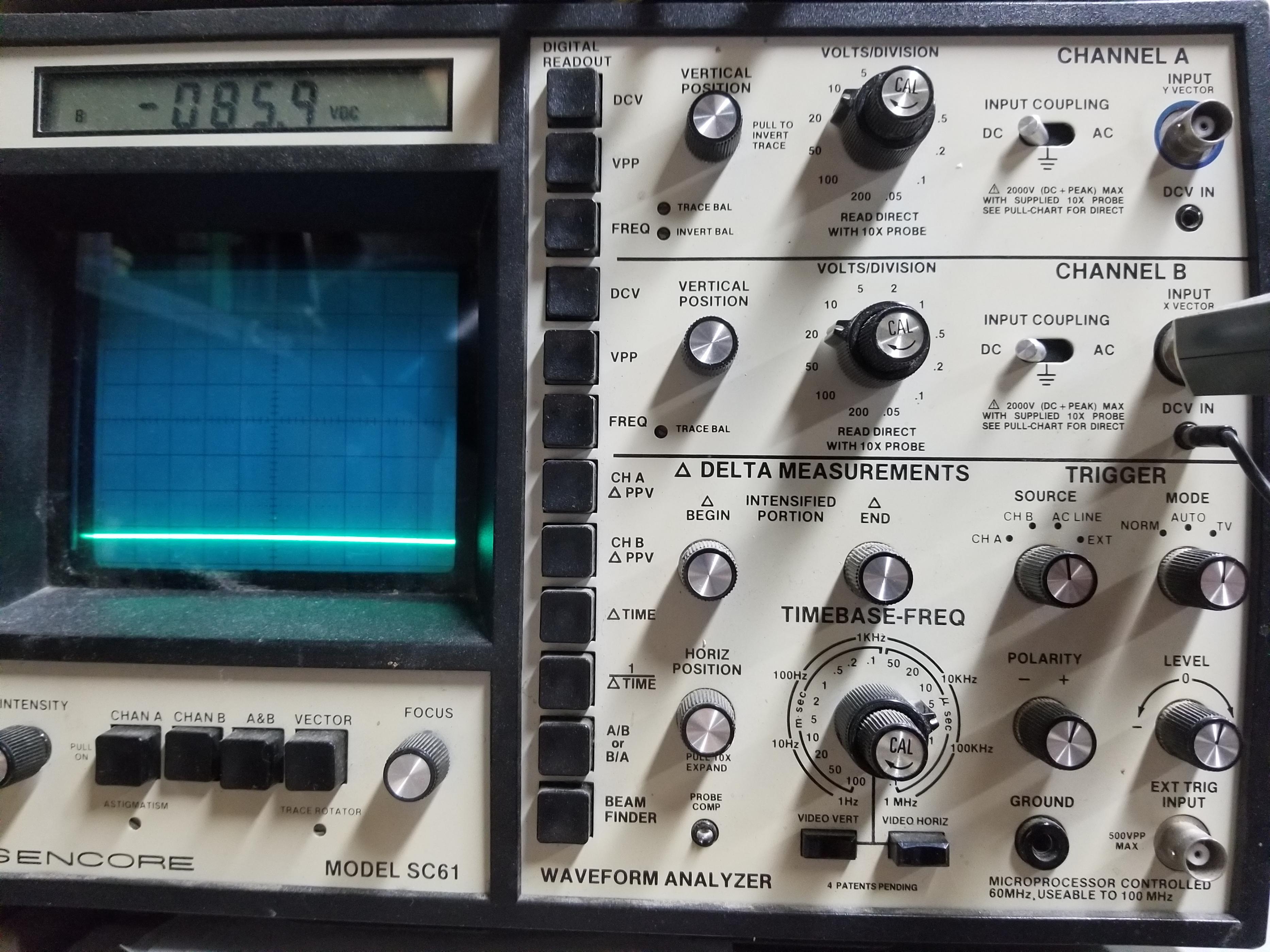

Thanks Perry. I know to check the rails for noise. Rail voltages are clean. I've never heard of checking rail to rail oscillation. Please explain how to hook up the scope to check that.

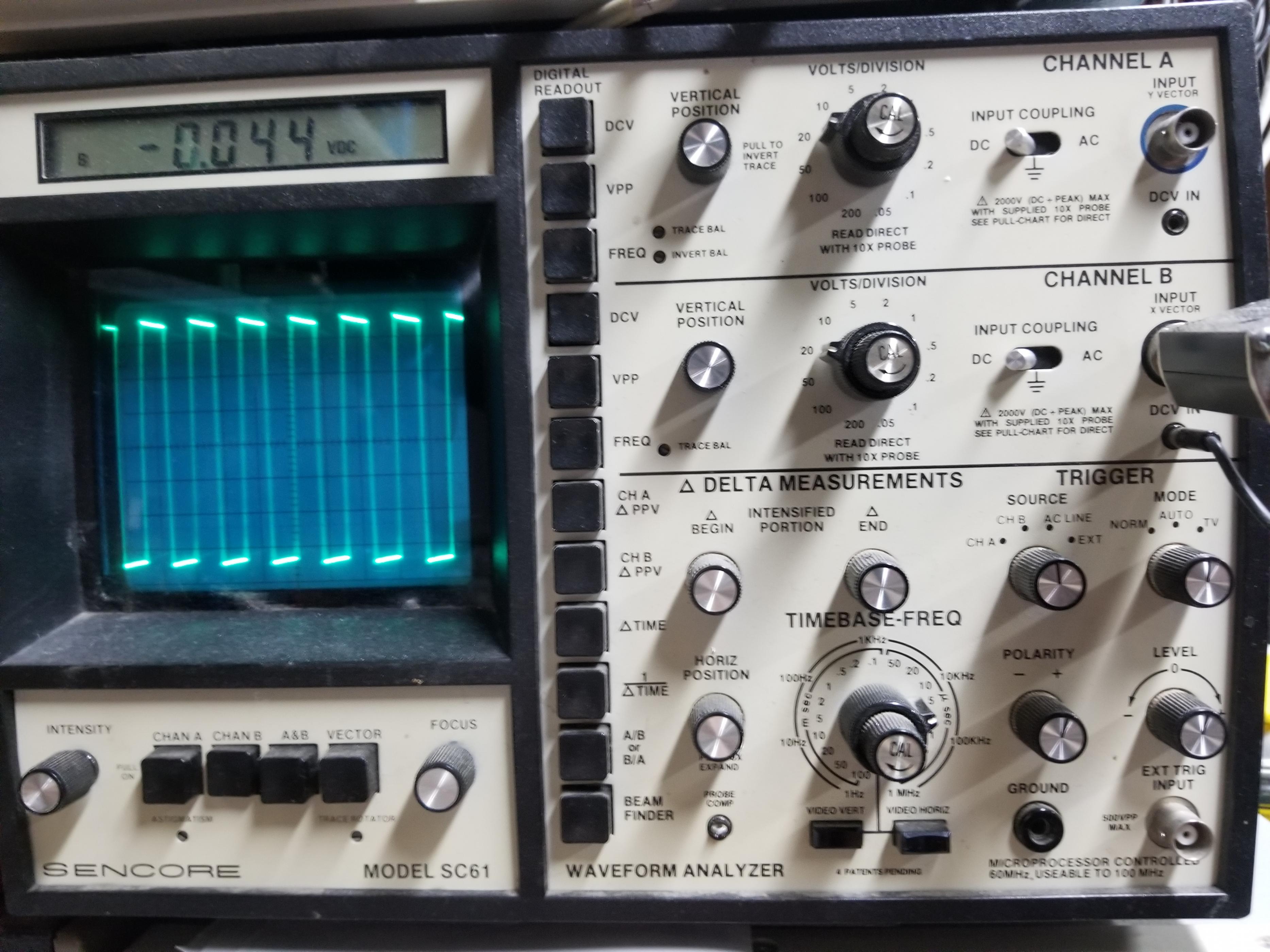

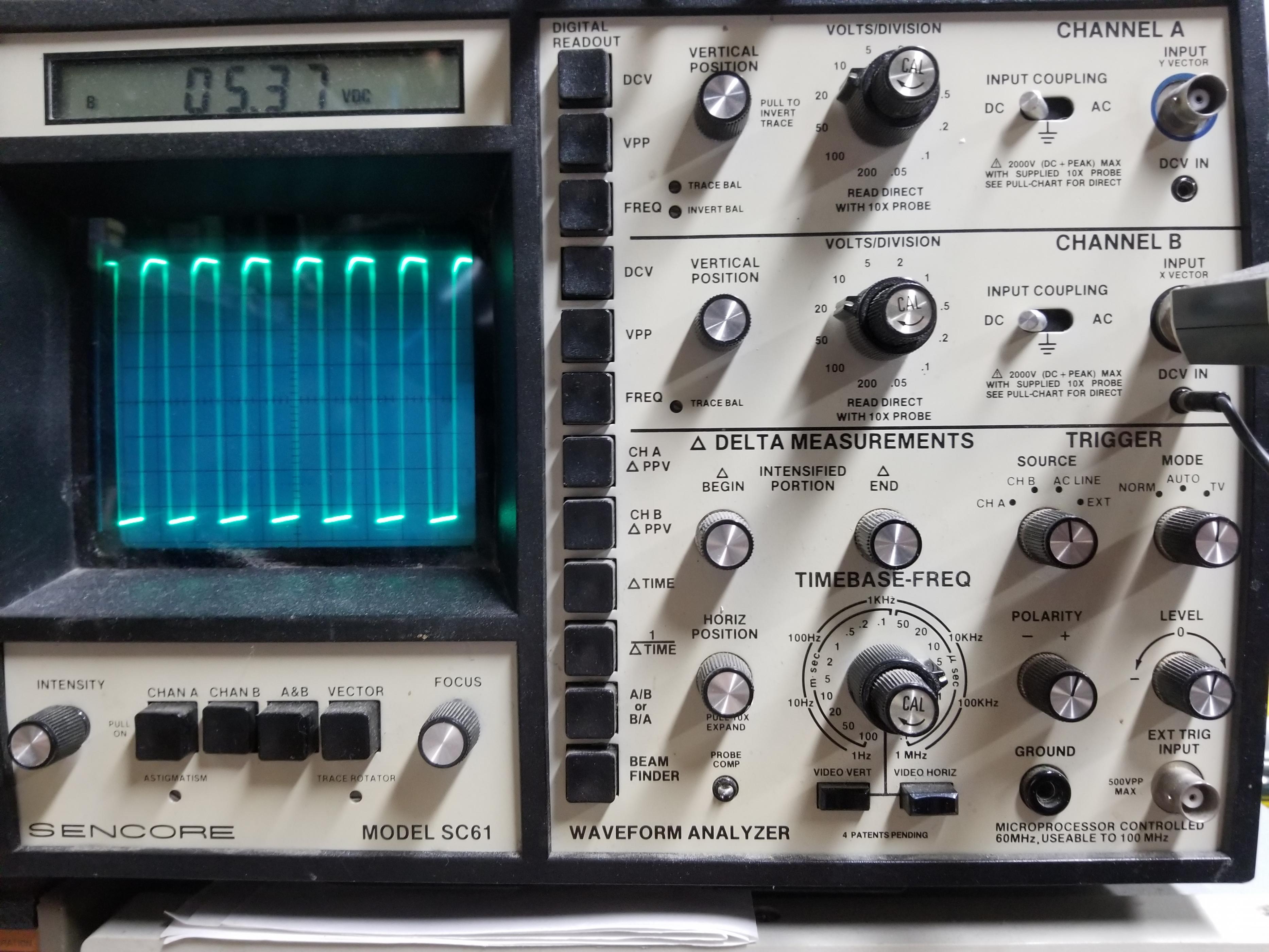

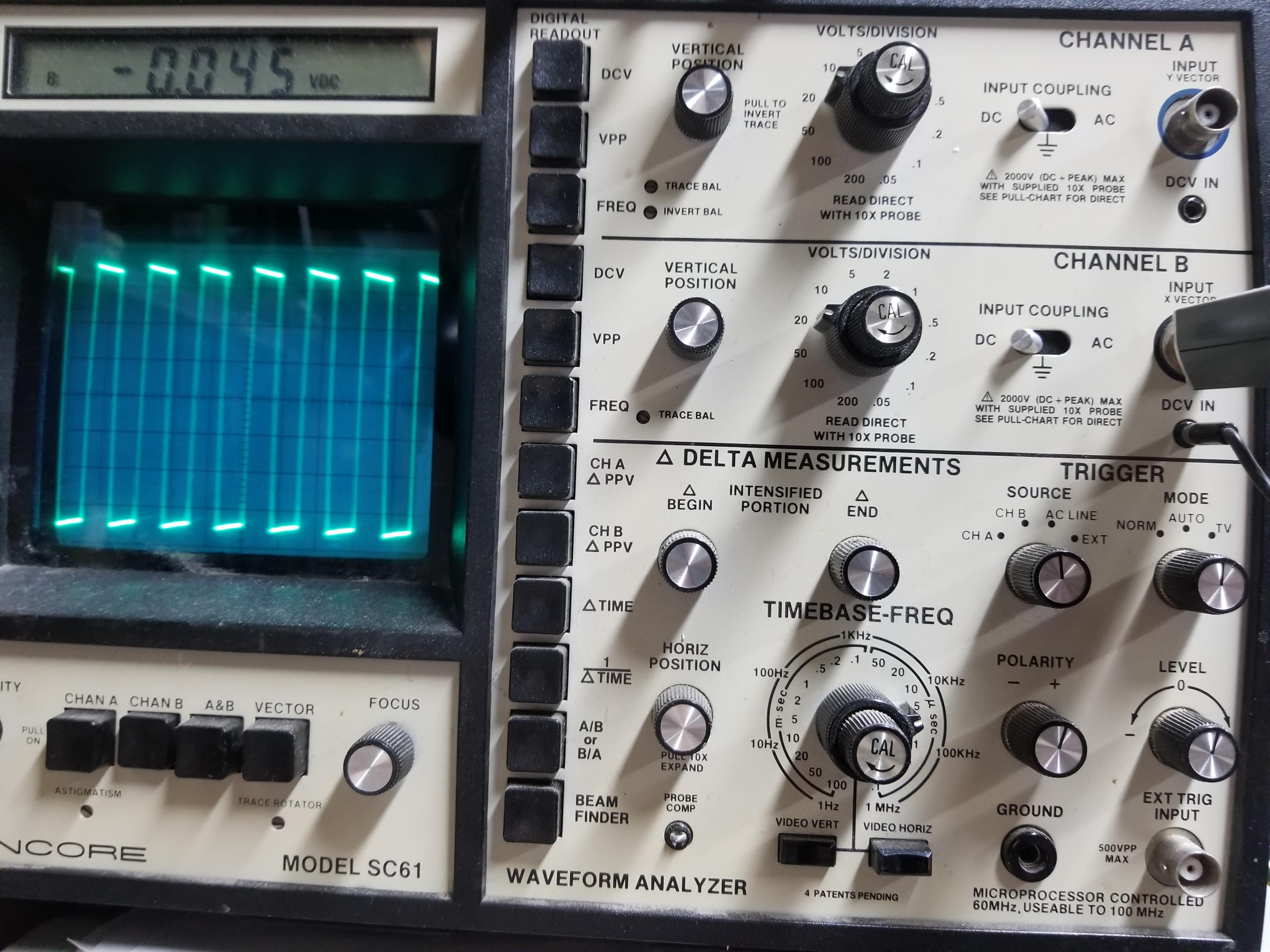

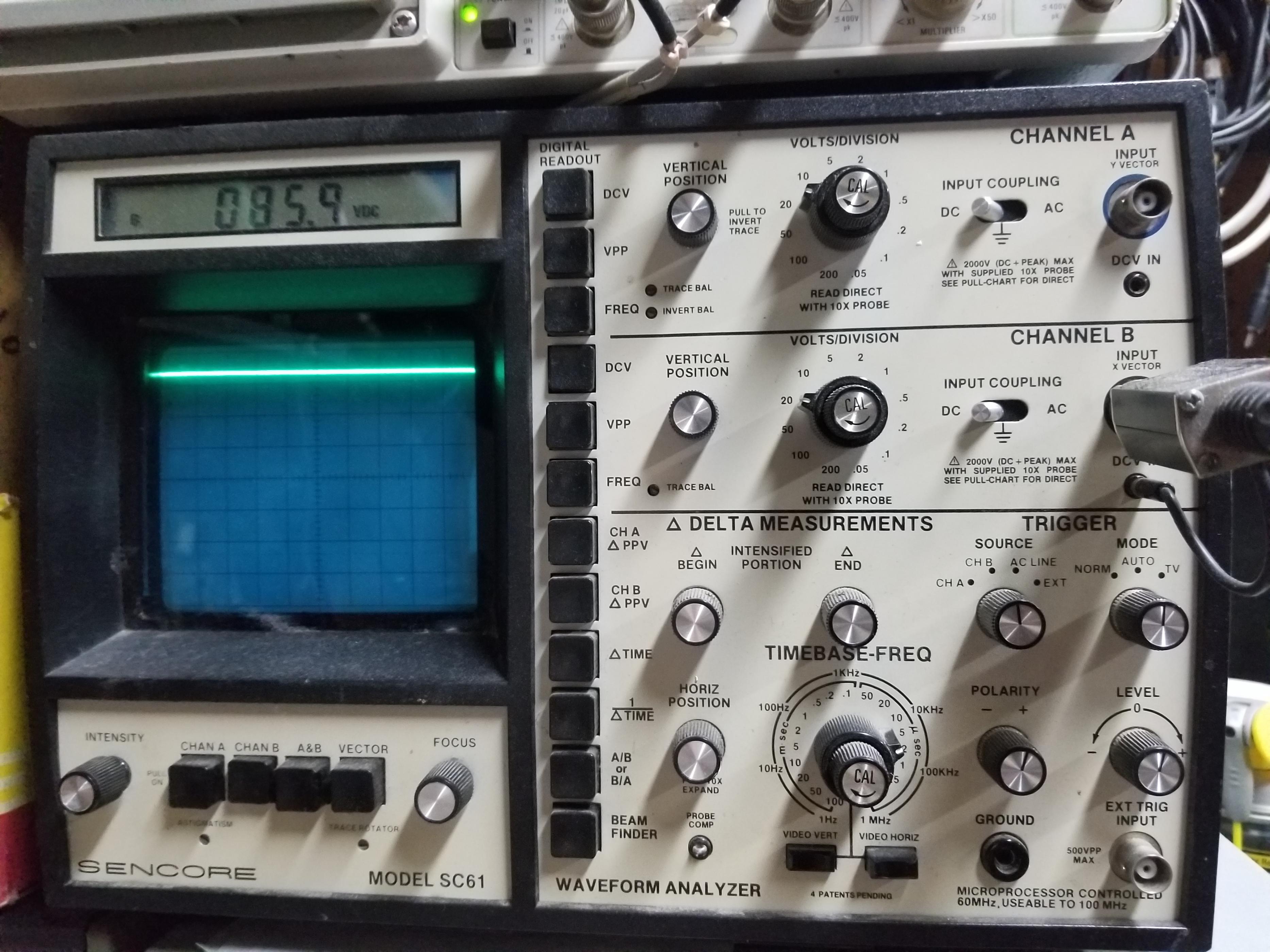

Perry, thanks for the education. I've attached pics of the output wave forms.
I just needed to know if there was activity there.
It looks like your probe may need to be adjusted to match your scope.
Have you tried operating all of the pots and switches through their entire range to see if audio (or anything else) played through?
Was there any modulation of the rail-rail oscillation when you drove a signal into the amp?
