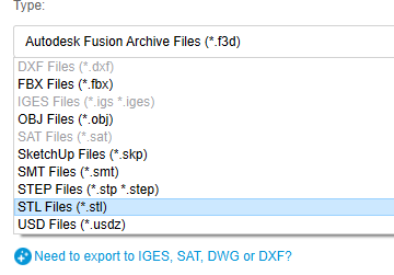

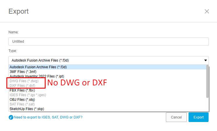

look Fusion360 is also locked for DWG and DXF
only hope is *.stl
but not all CNC shops take *.stl or they charge more for the conversion
i guess i need to get back at freecad

Ok, soooooo.......
i was able export .dae from sketchup in to freecad and from freecad i can export to DWG and DXF and STL
so! i think we are good 🙂
can anybody confirm this works ?
