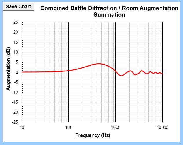

May I suggest doing a sim first on that GBS driver that includes baffle diffraction effects and the rear wall reinforcement. It's a fairly specific combination of cabinet depth and width that is going to work well with that driver with its rising response in the LF's. I found something around 3" deep and ~6-7 wide looked about right. Response Modeler works well for this.

The cabinet that worked best was around 10" x 26" x 4" (w x h x d) though a few other combinations in that ballpark were pretty similar. Using 1/2" wood everywhere except the back where I might use 1/4" because that back panel will sit right up against a wall, that gives you about 11L gross which will work fine for 2 of those Peerless in a closed box. Perhaps surprisingly, the sim is a little better with no edge roundovers or chamfers - in this case I wanted all the extra SPL's that the diffraction mid peak could provide.

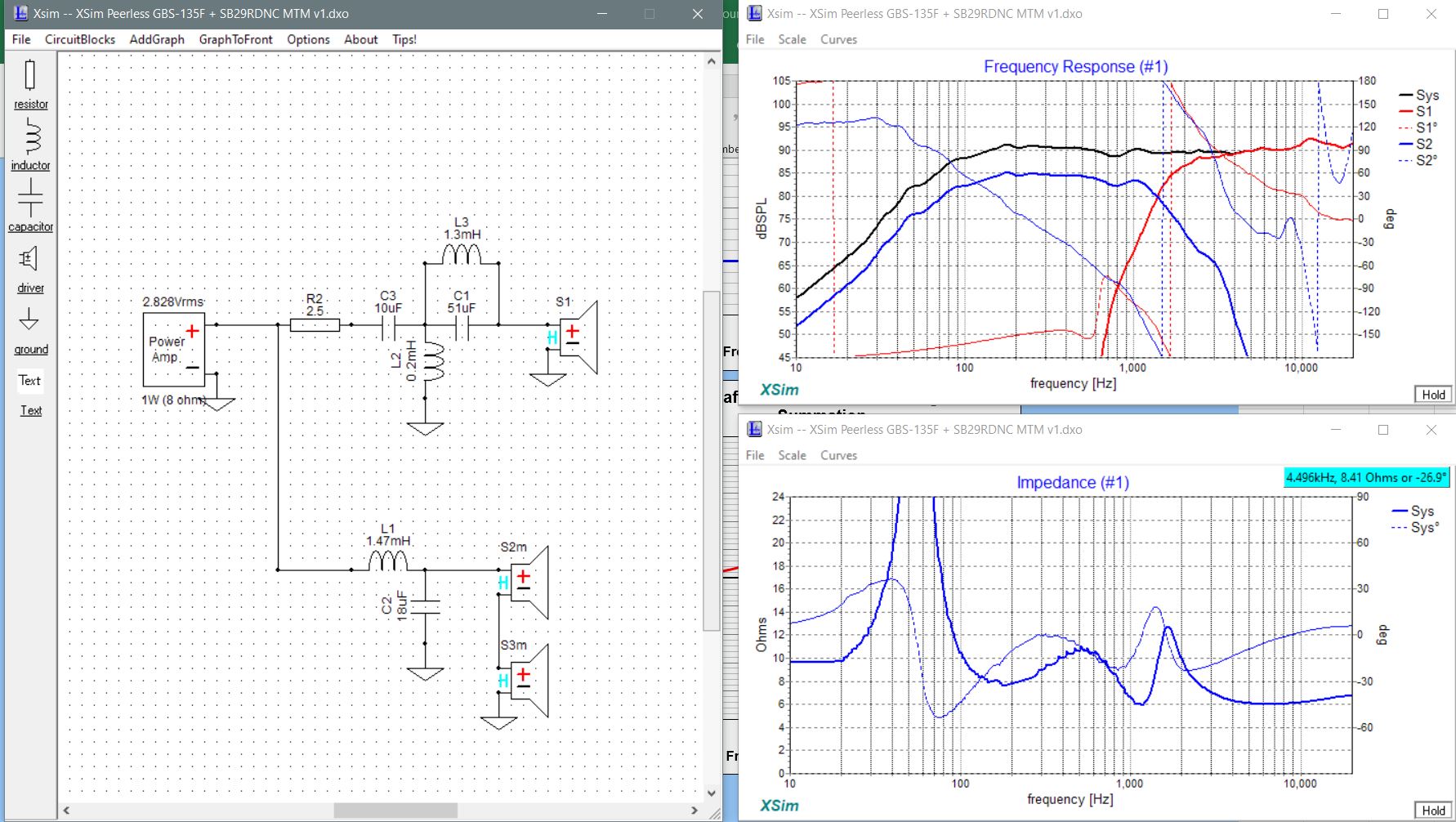

With baffle diffraction and rear wall effects added in, the xo worked out easier than I expected but the best I could do was a xo frequency of about 1600Hz. So a low Fs tweeter is definitely required. I chose the SB29RDNC with an Fs of 680Hz and a smaller faceplate for closer C-2-C spacing between the woofers and because I had a file for it already in my computer.
The biggest unknown in the sims is the acoustic center for those Peerless low profile drivers - the regular rules are just not going to apply. In fact I expect the AC for the woofer will very unusually be in front of that for the tweeter. I guesstimated at 3/4" but I could be out to lunch on that one.
Pic 1 below is the combination of BD and the rear wall reinforcement and pic 2 is the xo sim if anybody is interested. I tend to fear for a tweeter's LF's when the xo point is low and the speaker can do decent SPL's so I took the extra effort to seriously squash the tweeter's resonant frequency.
Consider it a rough effort for now as I didn't sweat all of the details.
