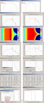

slot over speaker to offset increasing directvity?
Using diffraction slots over a cone transducer to achieve very wide horizontal coverage? Can anyone comment on or refer to experience, threads, papers, etc about this sort of thing?
The general consensus is that diffraction of sound is associated with bad sound quality - but in this case would that hold true?
I'm looking to explore the pros and cons of a full range speaker concept that would use a slot over a single cone to offset increasing directvity with increasing frequency.

Hi eqjive,
i fear applicability - especially of a very narrow slot compared to
cone diameter - is restricted in usable frequency range.
This is because the volume of air behind the slot and the mass
reactance of the slot together form a helmholtz resonator.
The cone/volume/slot configuration can only be used considerably
below that resonance, also depending on the kind of lowpass filter
to be used (e.g. in a 2-way system).
The concept is hardly applicable to fullrange IMO.

What was known as a Kolster Brandes slot diffuser largely overcame the problems associated with the trapped air that LineArray has mentioned.I cannot find my original reference via Gilbert Briggs and so I can only suggest an arrangement that suited 8'' speakers that suffered from a rising response above 2kHz,if someone wishes to try the device.Four 50 mm D circles are removed from a sheet of three ply ( approx. 5mm thick)The centres of the circles are on a 50 mm radius from a central point that lines up with the speaker cone centre axis and each circle is spaced at 90 degrees from each other.A slot of 31 mm width is removed from the plywood sheet and this runs from one of the 50 mm circles to the opposite 50 mm circle to form what in useage will be a vertical slot.There will need to be some thought given to the clearance between the diffuser and the periphery of the cone and in some cases a protruding roll surround.I would also suggest that an application of Blu Tack could be used to both dampen the plywood and partially streamline the inner surfaces.

Long ago I did some tests with diffraction slot on 8" fullrange driver. It was simple piece of thick cardboard which I encarved with knife :)
The result: It works.
However, be prepared for severe on-axis level drop at high frequencies. This is because the energy is redirected to wider angle than originally. Simple energy preserving law :) So if you initially have flat on-axis at high freqs, after the slot it'll be down to -10 ... -20 dB.
For a driver having heavily rising freq response, diffraction slot maybe a good idea.
