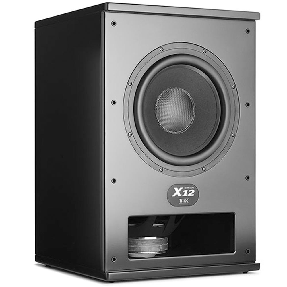

I want to build a new sub, isobaric setup (only because I love the old M&K subs) using 10" drivers. I would build a similar 12 in cube, with one driver facing forward as normal and one mounted on the bottom firing into the box. The then I will finish 3 sides around the bottom woofer, leaving the front open.

What you describe (like the M&K) are not isobaric. The are simply push pull subs, one cone facing out one facing in.I want to build a new sub, isobaric setup (only because I love the old M&K subs) using 10" drivers. I would build a similar 12 in cube, with one driver facing forward as normal and one mounted on the bottom firing into the box. The then I will finish 3 sides around the bottom woofer, leaving the front open.

M&K are not isobaric, but they are parallel drivers in push-pull.
Well, that explains why I couldn't figure out how to model it using the Isobaric option. I will try investing push pull tomorrow.you describe (like the M&K) are not isobaric. The are simply push pull subs, one cone facing out one facing in

The two drivers in push-pull
Act like one woofer. All push-pull means is that teh drivers are acoustically in phase, one wired and mounted inverted to reduce 2nd order distortion (at the exzpensive of increased third). It is effective if you use cheap woofers, not so much if you use good woofers (ref Nick McKinney).

Likely part of the reason M+K added
2 drivers to help increase senstivity.
If your going for recreating the M+K M10
like the X12 and 15 shown so far.
Simulation is basically 2x drivers
in a sealed box.
According to the website sealed application
One driver is reversed for looks.
good size magnet, old trick to reduce volume
getting displaced, reverse the driver outside
the box.
