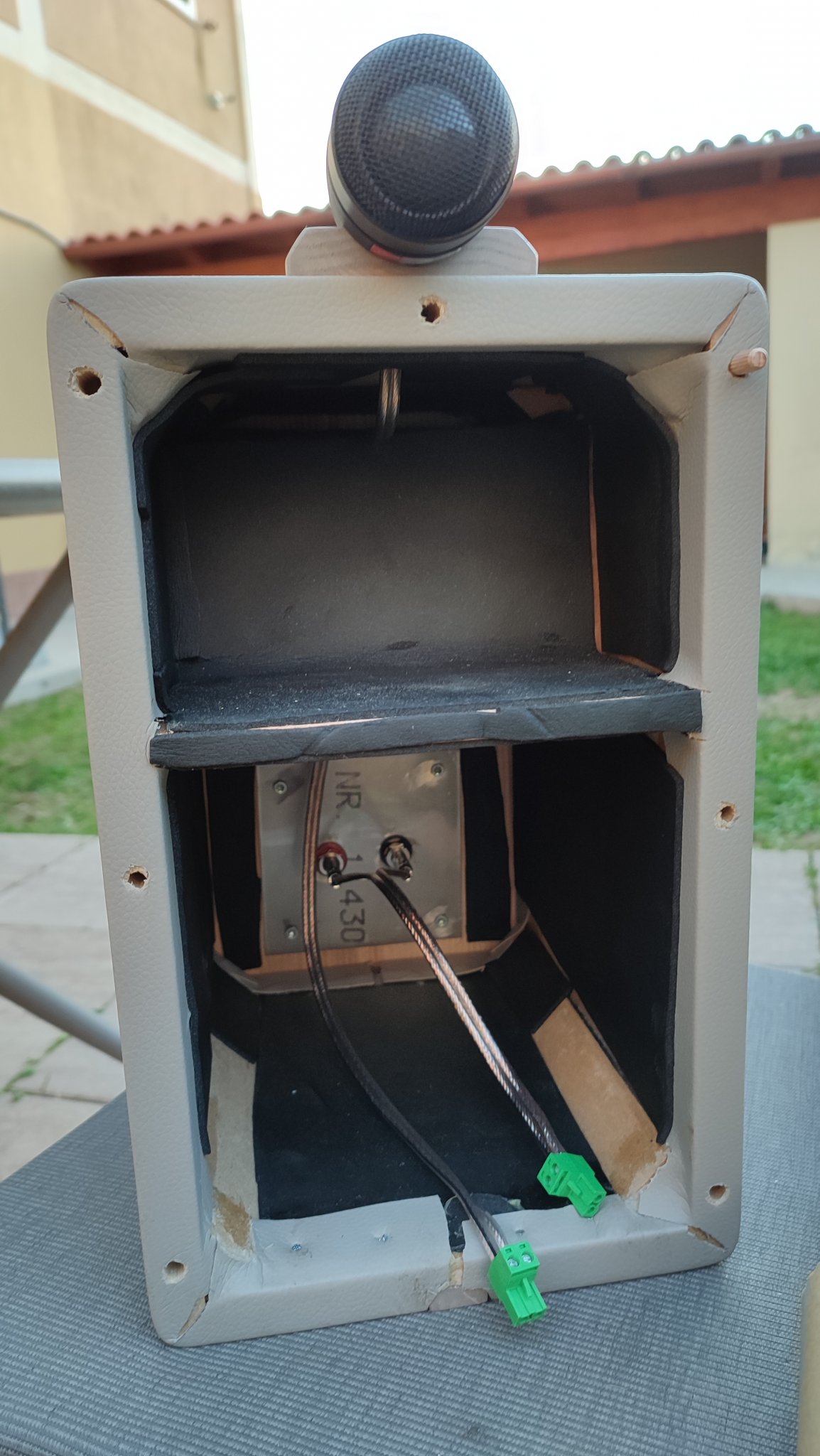

I completed a first bookshelf project and this is the second one.
I bought the 3 couples of drivers as a deal and after I tried to put them together in the best way.
I know it's quite useless a 3 way design with such a small woofer and a small enclosure, but I like experiments.
So you can see the result in the pictures.
They sound good, not really punchy in the super bass region as you can imagine, but they are dynamic, well controlled and very clear at medium-high frequencies.
Medium frequencies are a little too present but they are very very clear thanks to the Visaton qualities. Also in the non optimal location in the room this is a plus.

Hi @pop4richard ,I'm a bit concerned. Should not the Visaton midrange have its own little box? Did you use software to design the box and the port size? I love the look of these speakers, very clean, nice finish and good proportions.
yes, the visaton has a small 1,5l box inside. The port size is calculated with the help of various calculators but nothing advanced. All measurements with very basic instruments and a bit of crossover tuning and listening sessions.

Yes, After all I agree with you and the mid range benefited a lot from this design. But sure Is full of excellent quality 2 ways speakers with brilliant mid range rendition.
Unfortunately I had some limitations in terms of space, so I designed a 10 liters cabinet that Is adeguate for a woofer not larger than 5-6 inches.All in all, however, it is enough for my listening.
I'd have liked to make a larger cabinet but i was limited by the available space in my bookshelf...yes, they are real bookshelf speakers 😄

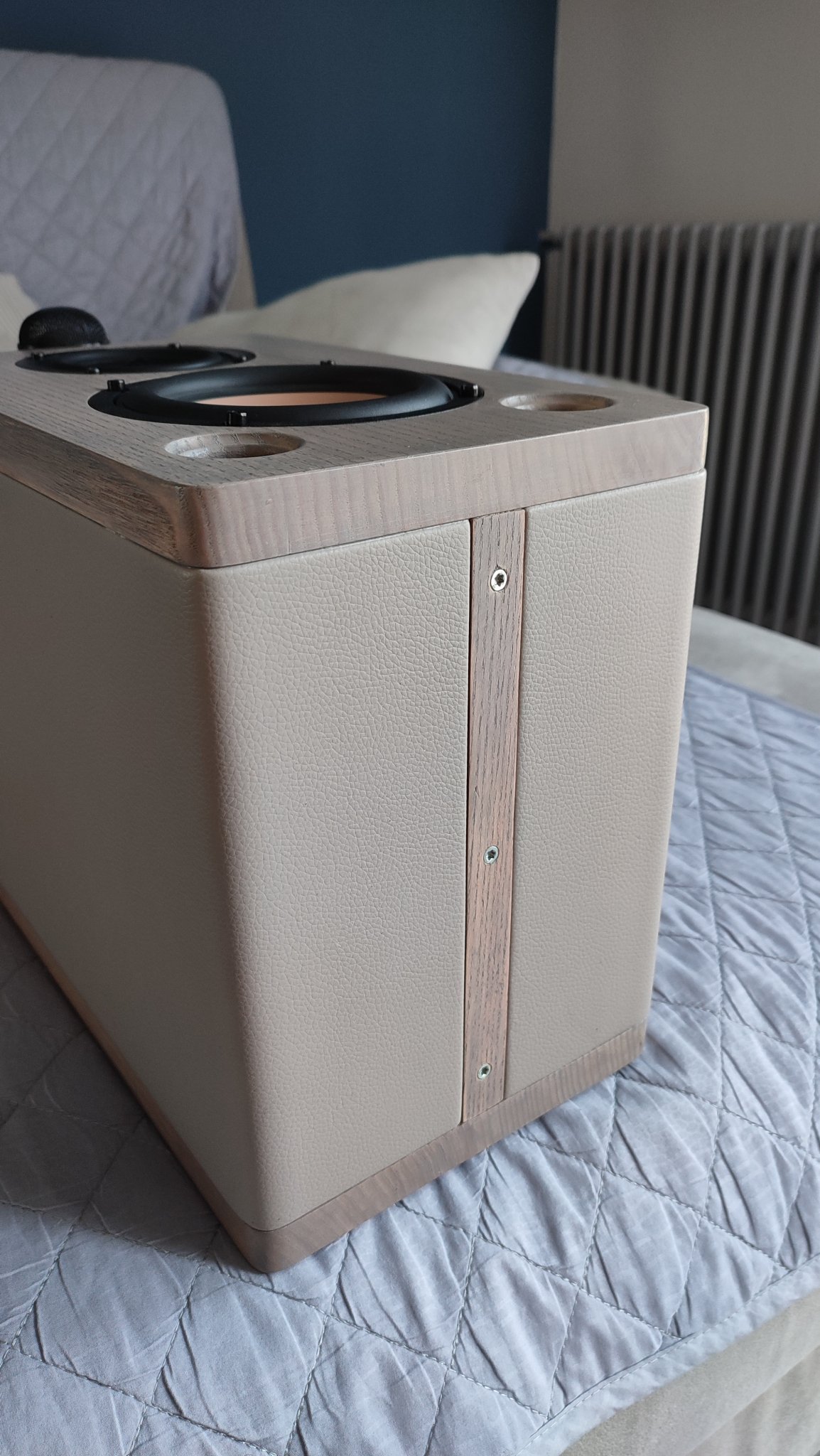

I'ts a synthetic leather. I attached It with a spray glue in the larger surfaces and with a strong Bostik contact glue on the edges.I really like the leather (or leather like) wrap around. I was wondering how you attached it and how you you wrapped it around the front and rear of the speaker.
To understand what i did for front and rear solution and to join the two edges of the leather i post some pictures.
