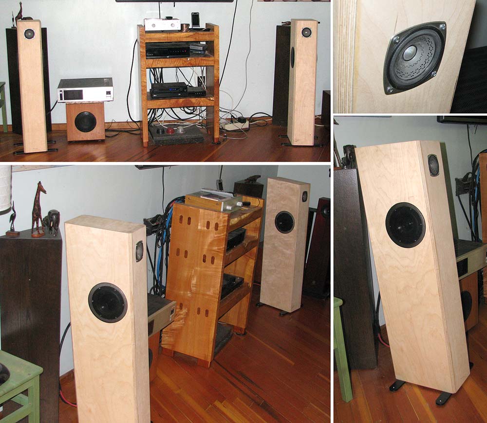

It has been done quite a bit. Look for "WAW" and "FAST." Here's a long thread with a very good build using an 8" woofer and a variety of full range options. At the moment, I'm using this in a floor standing model with a Fostex FF85. It's really a great sounding speaker.

Pano, in your experience does a 8" full ranger sound "bigger" in such a design vs a 3". I'm aware of the downside of the larger driver vs the smaller in terms if high frequency response, just curious if you've experienced any feeling of differences in the scale of the sound with the larger units?
Yes, bigger scale, more realistic. But then all the issues you mentioned. You either have to choose well, live with the limitations of the 8", or add a little tweeter. FWIW, I do like 8" plus 2x15". 6.5" is not a bad compromise for big sound vs good top end.
