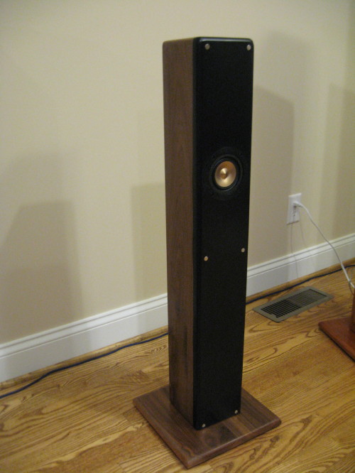

My Alpair 6 MLTL prototypes were built from solid walnut hardwood for the sides and top with MDF for the front, back, and bottom panels of the box. The overall external box dimensions for my enclosure (with 0.75” thick material) are 35.25” H x 5.5” W x 5.5” D. I am using a false bottom to raise the driver to be closer to listening height.
In this case the active part of the MLTL internal dimensions are: length (top to bottom) 30”, driver distance from the top 10”, port distance from the top 27”, with a straight cross-sectional area of 4” wide x 4” deep, stuffing density of 0.50 lbs per cubic feet, and port radius of 0.75 inches with a port length of 4”. The false bottom adds 5.25” to attain the height of the finished box. I have added flush mounted embedded magnets in the front baffle face for grill attachment.
From the conception I knew that these speakers would sound acceptable with good music at moderate volume. I suspected that they would strain when pushed toward their limits. Well, color me surprised at just how impressive these little guys sound on favorite tracks. The speakers can be run without any baffle step filtering as there is some help from their frequency response. If you observe Mark Audio published frequency response for the A6 you’ll notice that the driver has a hump of up to 3-4 dB in the 175-550 Hz range. Thus, for the 5.5” wide cabinets there is some inherent gain in this area for baffle step compensation.
Now these speakers will not win any bass SPL contests but you’ll be impressed at how well they perform. Vocals are natural with no sibilance for both male and female voices. The high frequencies are very nice with the shimmer of cymbals and such.
So in conclusion these little guys get the job done for the size and satisfy the SAF goals that I had established. Don’t expect wall shaking performance but a solid reproduction of music in a small/mid-sized is delightful.

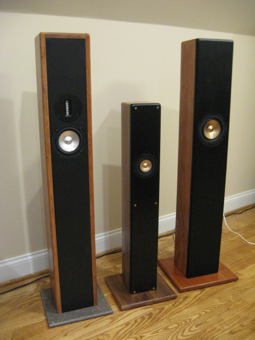

EUVL,
I also have a MLTL design for the Jordan JX92S with a ribbon tweeter (Aurum Cantus G2si) that I really like. That design is a variant of my earlier mini-monitor design,
The MLTL designs for the Alpair 6 and 10 offer the advantage of bass extension in a small footprint. I think of these speakers as small monitors on a stand whereas the stand is the MLTL pipe.
Pictured are the 'Jordan with a Ribbon' MLTL, the Alpair 6 MLTL, and the Alpair 10 MLTL.
Jim

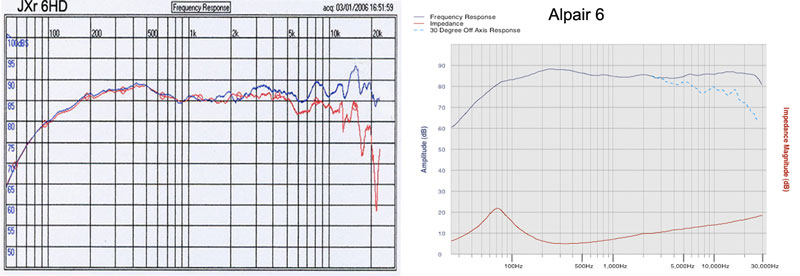

Re Collin's comments on the 6HD and Alpair 6:
The "hump" is also present in the 6HD's low-mid performance, relatively similar to the alpair 6. This HD result is from a batch we made in late 2006. I can't speak for any 6HD units that may have been produced after we parted from Jordan some months later.
I didn't have the time to test the HD's that we made in sealed boxes, but maybe the variations in the lower frequencies would be damped in smaller sealed boxes for both drivers. I'd have to test an Alpair 6 in our anechoic chamber to be sure (when time permits!)
Mark.

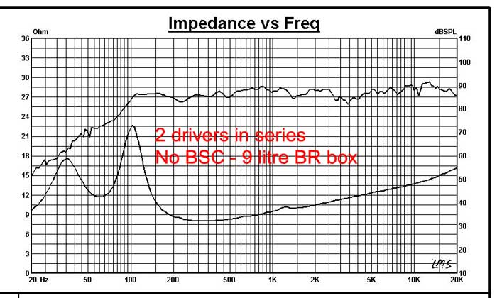

Hi Collin,
Good to hear from you ((long time).
I did much work on coils in the early days. Different former materials gave varying results across the HD's range. I applied my experiences form the energy transmission industry in dealing with the factors that apply to operational relationships between drivers and their box environments. I've carried this knowledge on into my family of drivers. I've refined the technique to help reduced the need for BSC.
Here's an interesting graph from my other work show showing a flat response using 2 drivers in series in a 9 litre BR box (No BSC).
The HD's maybe benefiting from the same flattening effect, the driver's LF gain is off-setting the pneumatic inertia inside the box.
Also, the HD's suspension are very soft damped, there's no spider so pairing then helps to spread the work load. Room gain is welcomed, again reducing the need to increase the loads on each driver.
Mark
