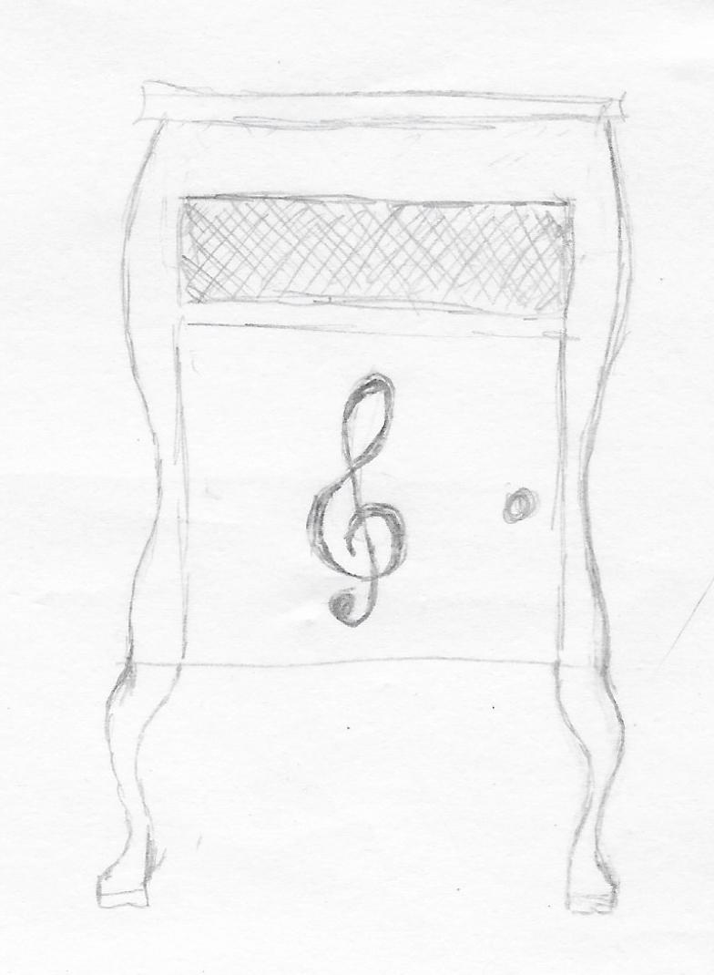

Looking for advice for a small record console project. This is for use by my daughter in a small apartment. I want it to all be self contained, speaker, amp, turntable, and record storage. Attached is a sketch of what I am thinking. Size about 24" wide, 20" depth. So record player under top, speaker is the middle section, record storage below. I plan to fit all electronics in the same area with speaker, I think a little chip amp will do. Looking for inexpensive speaker options.
I think for speaker I could go 2 ways, either 2 full range drivers in stereo or run mono into the amp and a pllxo to split the channels into hi pass and low pass for a mono bi-amp WAW arrangement. Basically a center fullrange flanked by two woofers. The latter appeals to me since I think it could deliver better bass and spl but I have no idea what box volume/port to setup.
Thinking of drivers in the 2-4" range and under $20 each. A little flexible around the size since height is not set. Appreciate any suggestions.

The general idea of a stand alone turntable in a console is perfectly fine if your expectations are realistic. I like your drawing, that's cool. However, the proportions I see are probably just enough to house a turntable and LP's comfortably.

Yes, turntable has a built in preamp. Plan is to house a small chip amp and speakers in the area behind the grill cloth, my thinking is this area should be around 24"w 6-7"h 20"d leaving room for a small chip amp and speakers. Controls on the back or under the top lid. As stated modest sound quality goals, hoping for better than the plastic Urban Outfitter speakers in use now. Plan to build it so it can be upgraded/changed later without too much effort.

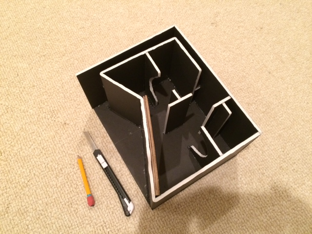

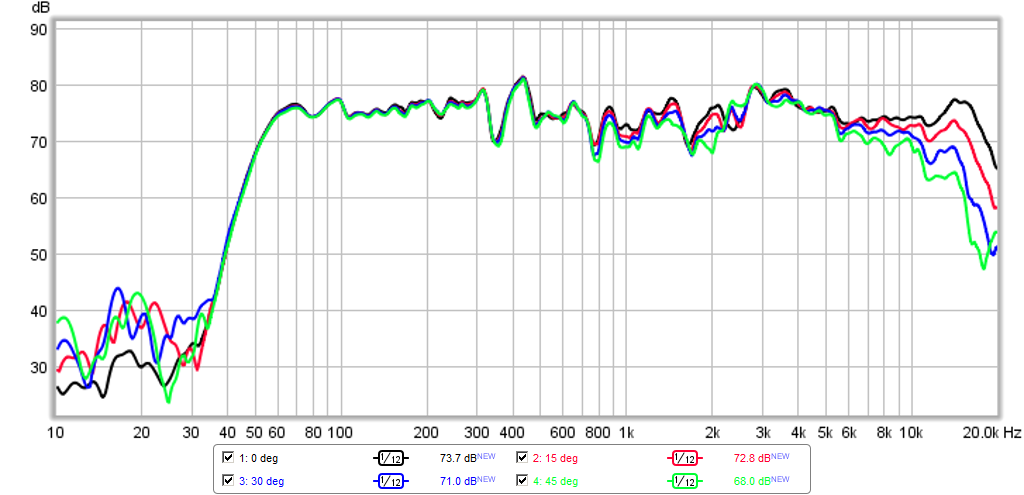

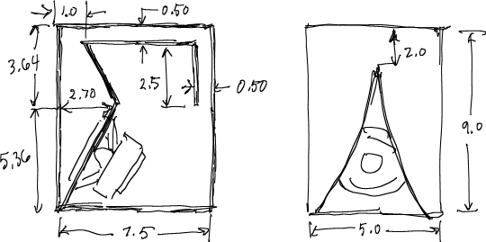

In the linked post below, XRK971 describes an XKi cabinet for Dayton's PS95 which is only a bit over 9 inches tall when made of foamboard. It could work upright - inverted (assuming sufficient height for the grilled window)
besides left-right butted. It would be interesting to hear X's remarks on it vs the little Karlsonator.
PS95 at around $25 is quite a bit more expensive than the Vifa
Dayton Audio PS95-8 3-1/2" Point Source Full Range Driver 8 Ohm
Did X ever make his XKi for the Vifa? Faital ?
XKi - X's ab initio Karlson 6th Order Bandpass
My XKi’s include: RS100-8, single Beta 8CX, dual Beta 8CX, dual W5-876SE sub, W5-2143, PA130-8, dual PA130-8.

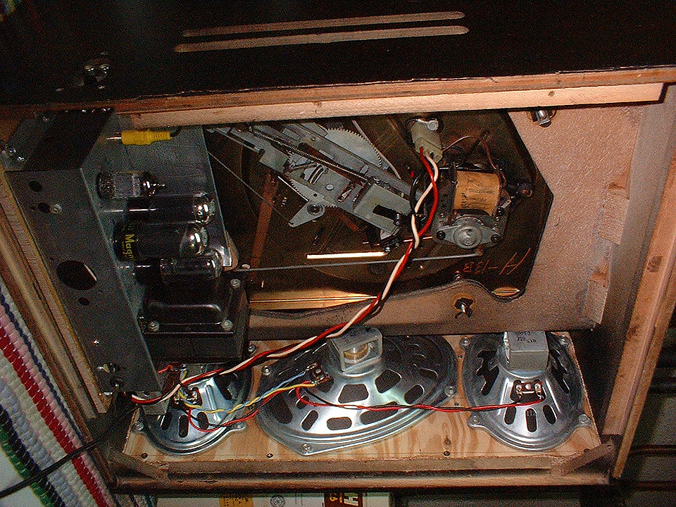

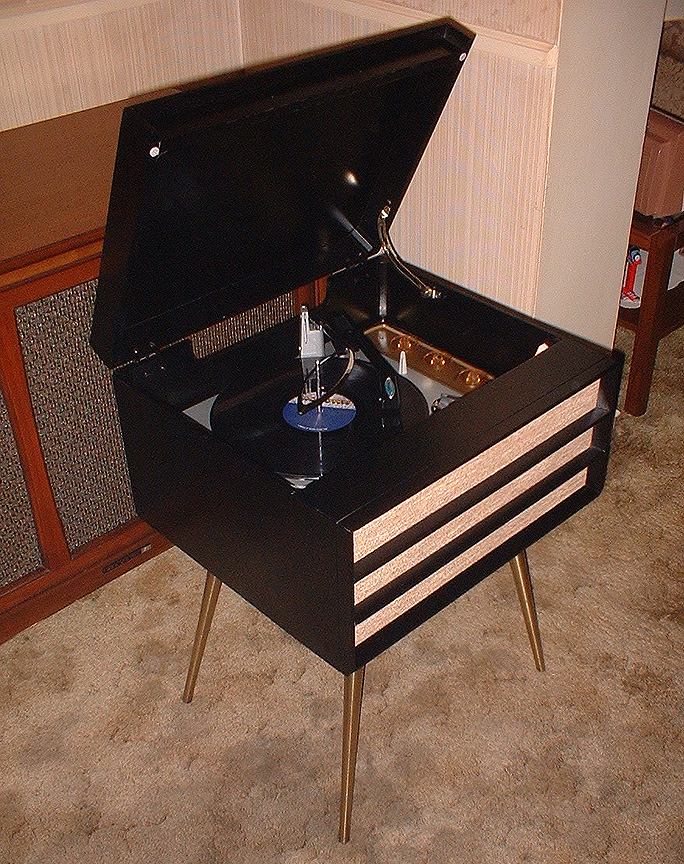

I went "vintage" with a 1958 RCA Victor consolette... 3 FR speakers...
Be interested to hear the what and how for the 3 fullrange speakers.
Simply just 3 vintage oval drivers, each 12 ohms, parallel hookup = 4 ohms.
There's no need with this to go nuts as most do with trying to figure out the plethora of response curves, cabinet tuning, and all that crap.
The thing sounds surprisingly nice.
Simply just 3 vintage oval drivers...no need with this to go nuts as most do with trying to figure out the plethora of response curves, cabinet tuning, and all that crap.
