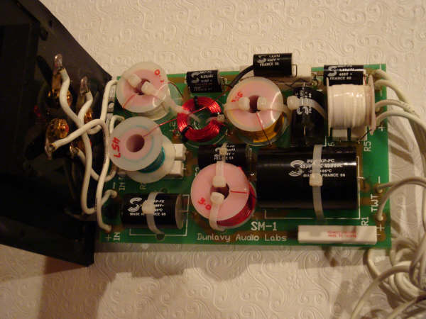

All I know is Dunlavy SM-1 is an MTM with two 6.5" mids and it can run almost flat from 60hz to 20,000 khz at about 91db or so. So he made it work somehow, since I do not need 91 db maybe it can be done with smaller 3" drivers running flat at much lower db.
Here is the picture of that cross -over, this picture was posted by another user many years a go, maybe something can be extracted from his design. Can we even tell if it's 2-way, 2.5 or 3-way.

Your picture shows a passive crossover network. They are very hard to get right; easy ones work badly, and ones that work well are difficult to design. Using an active crossover and bi-amping is a much better solution for DIY.
Some simple math: the area of a 6.5" diameter circle is 33.183 square inches. Two 6.5" circles have a combined area of twice that, or 66.366 square inches.Dunlavy SM-1 is an MTM with two 6.5" mids
A single 3" circle has an area of 7.069 square inches.
Do you see the trouble? The 2x6.5" Dunlavy speaker has more than NINE TIMES the woofer cone area of a single 3" woofer. The Dunlavy is a (small) lion, the 3" woofer is a mouse...but you want the mouse to roar in as deep a voice as the small lion.
