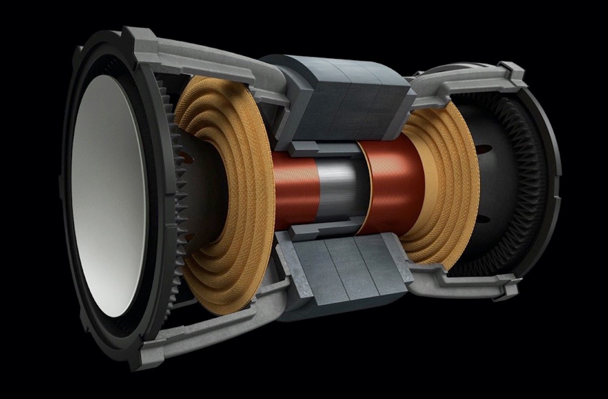

KEF use (admittedly larger) 6.5" force-cancelling drivers along with 1,000 W RMS of amplification.

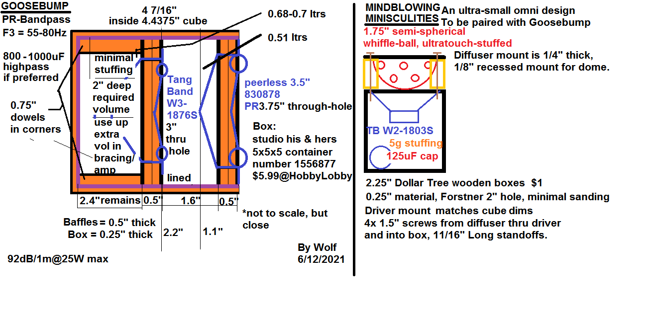

My Triumph or Biumph design uses the W5-1138 in a PR loaded cube of 9.5".

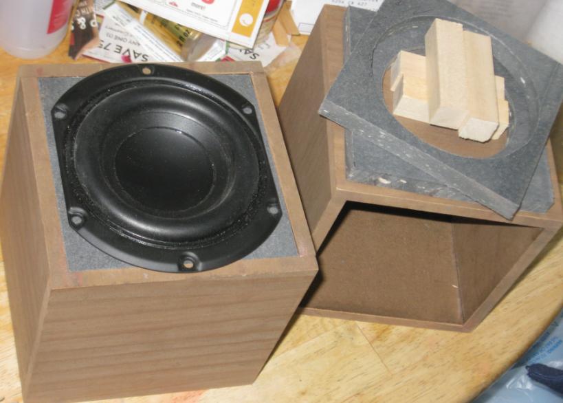

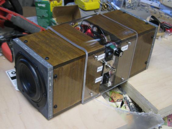

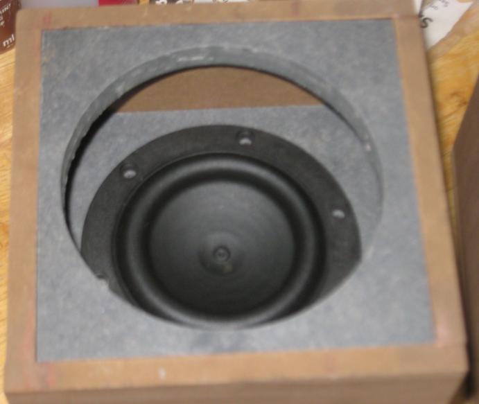

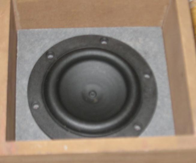

Oh- I have used the TB W3-1876S woofer as well. In a very small 5" cube in a PR-loaded bandpass, these are quite respectable at about 15W each, and better in opposed pairs.
EDIT: More as stout woofers in a bedroom system, PC subwoofer, or bluetooth box. These do not go ultra low, but the sealed box keeps the woofer happy.

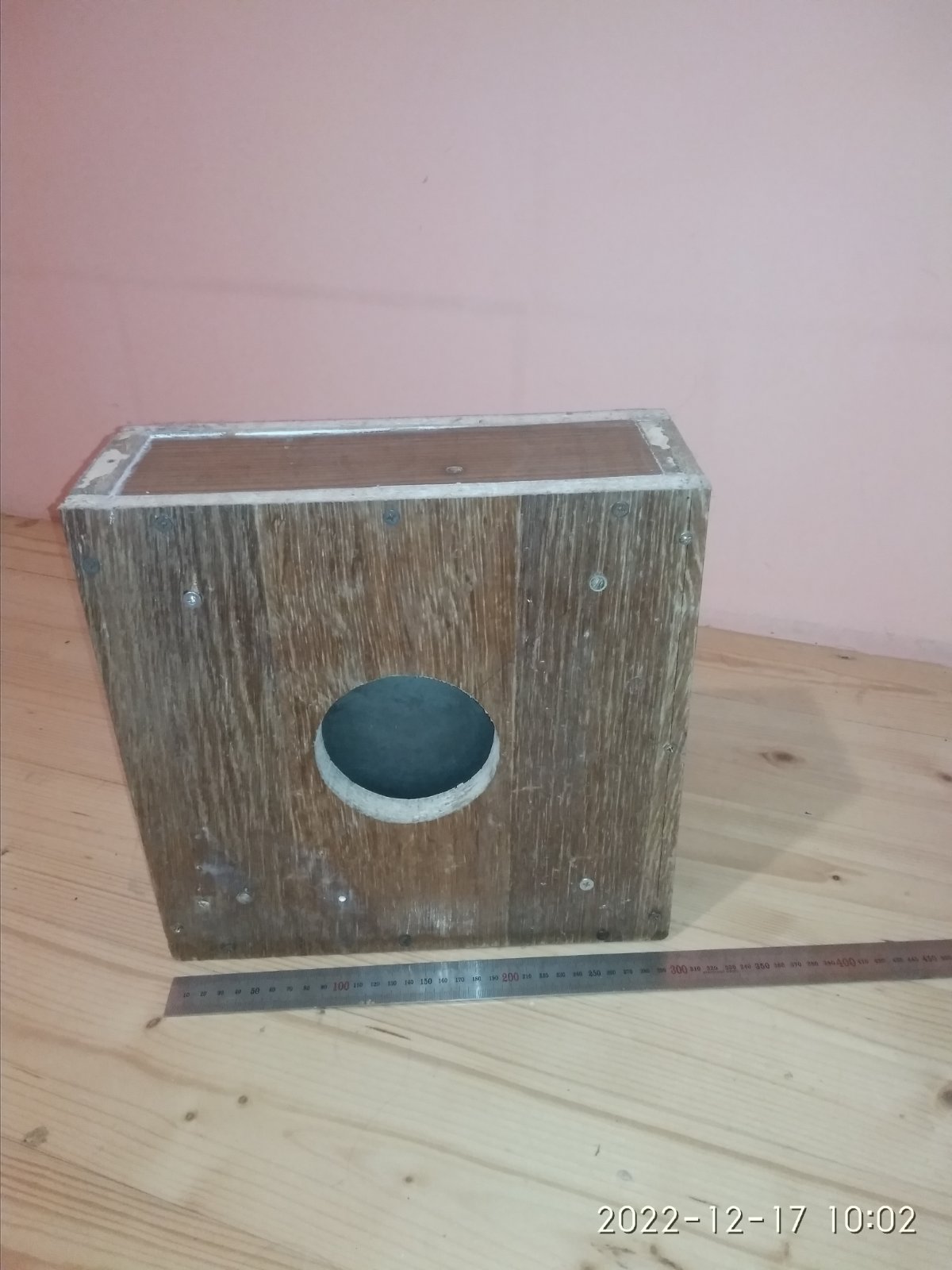

I was referring to the size of the case. Here's a subwoofer I made on a 10-inch speaker. Its dimensions are 300x300x120mm. Plays from 28 Hz. It is quite suitable for computer acoustics.I did that before posting, and what I saw was a 15 inch driver, which doesn't have much to do with the 4 or 5 inch the original poster requested. So I says to myself, "Self, either you're not seeing what they're talking about, they're talking about something random, or they're feeding the same thing into multiple threads trying to push something." Maybe myself will get back to me later with more insight 😏

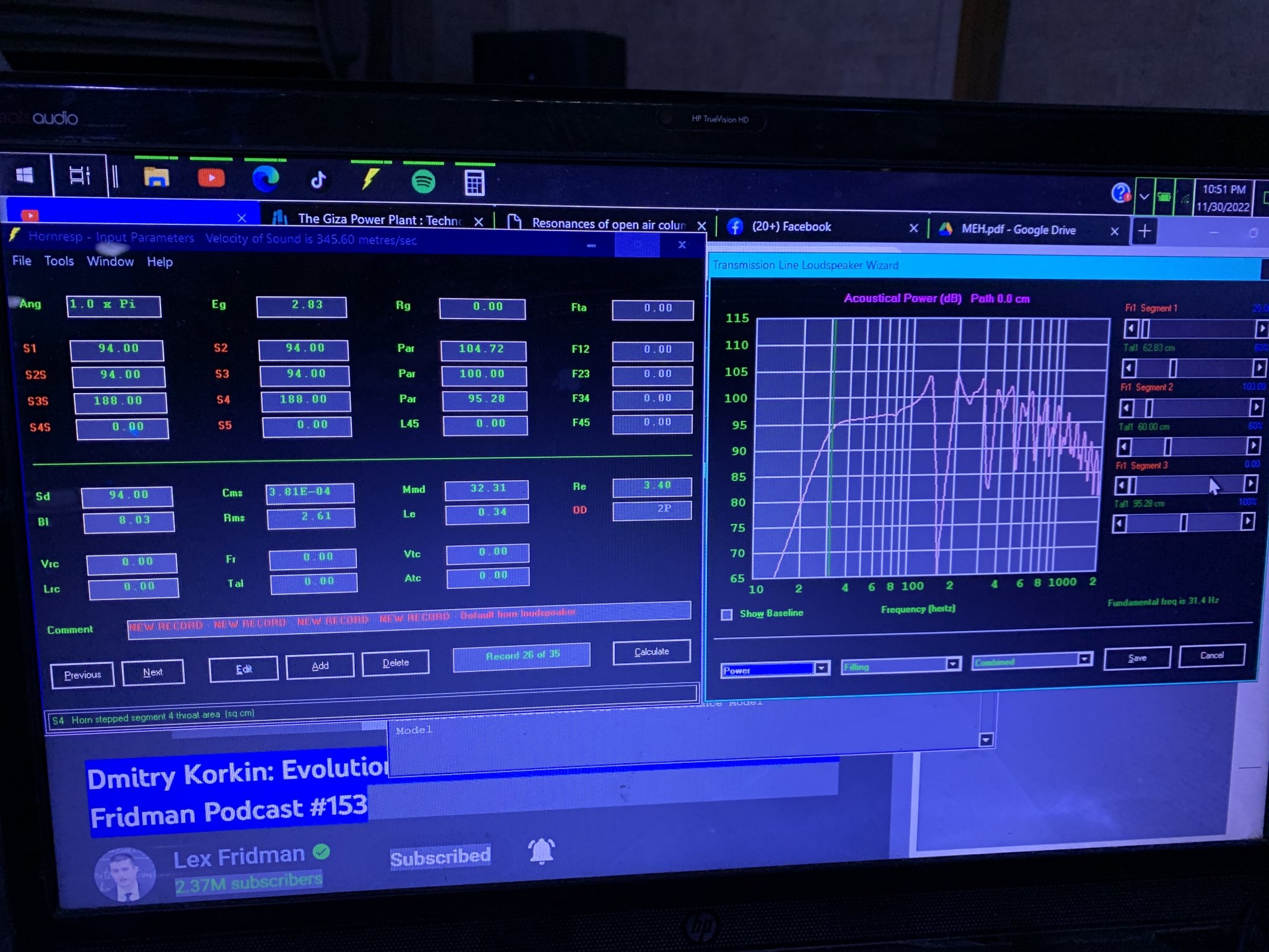

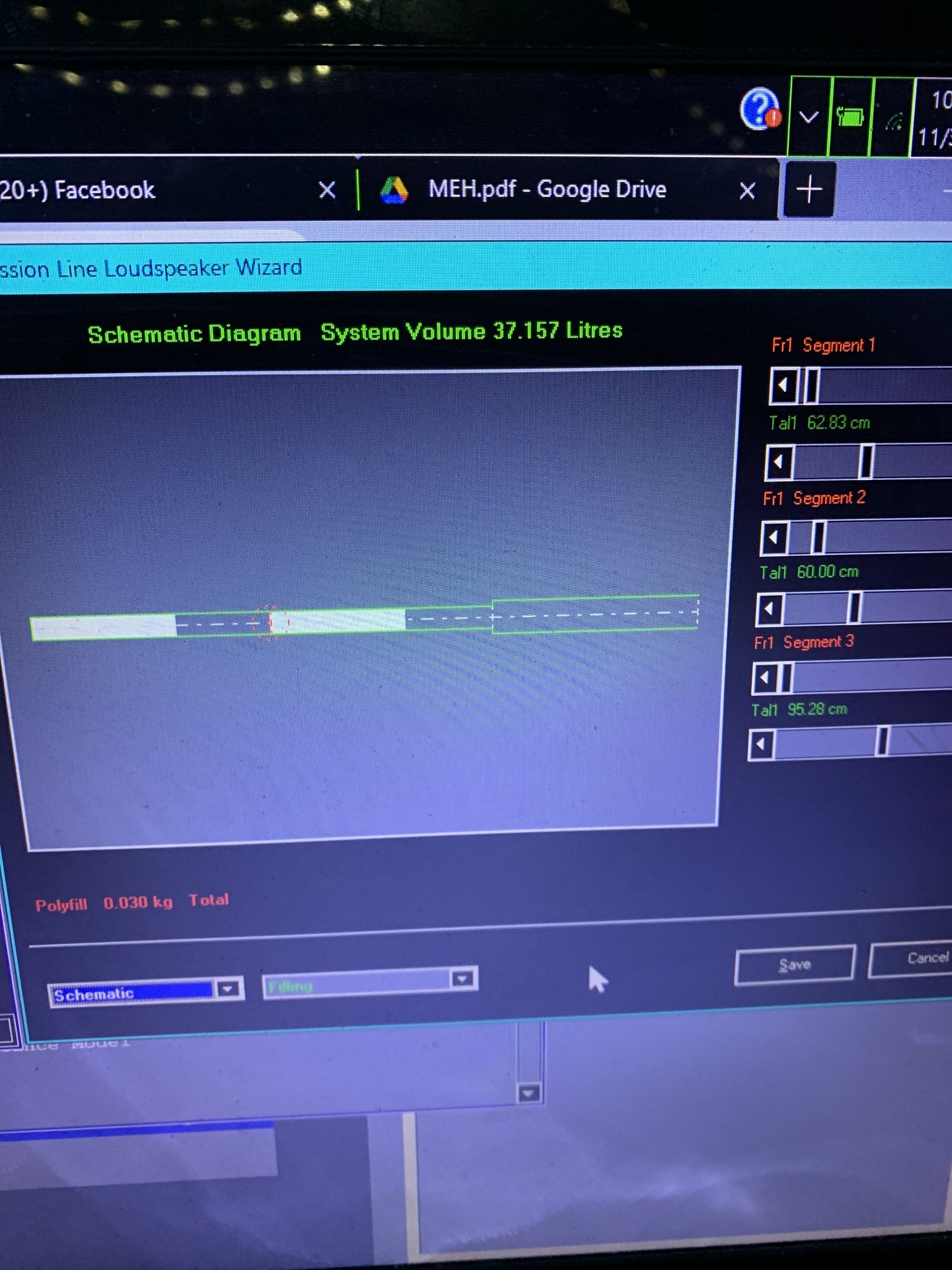

Teeny tiny to me ~26 L, 22-80 Hz/F6 TH, >102 dB/m/25 Hz-up/130 W/2piThe newer Dayton MMAG HE woofers
