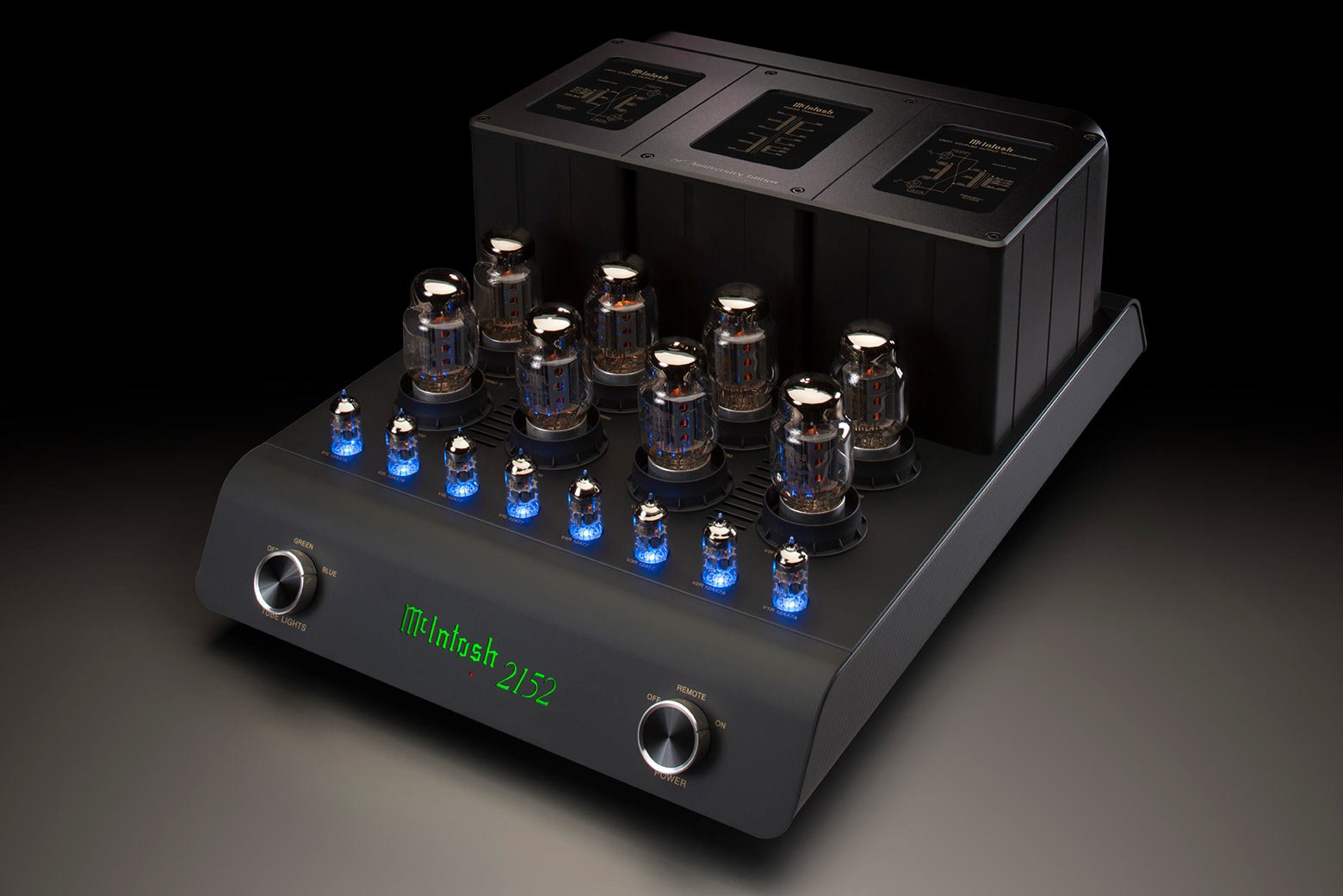

Just saw the other day, a Dayton amp where the tubes were illuminated from the bottom with orange colored LEDs.

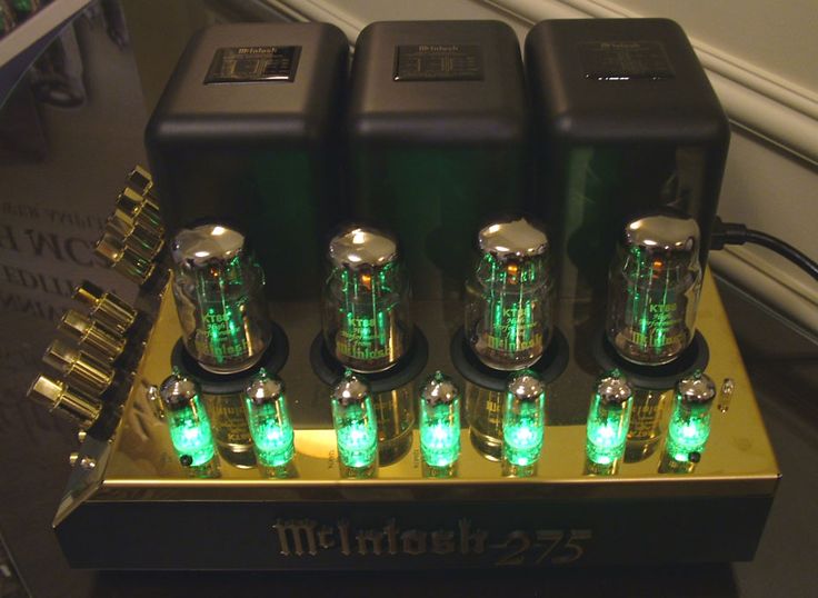

That's nasty. Especially blue led below tubes. Or green mcintosh, blah.Just saw the other day, a Dayton amp where the tubes were illuminated from the bottom with orange colored LEDs.
Behringer was heavily critized for putting orange led behind mic tube pre. Lots of people disliked the gimic.
Yup. And to add insult to injury, a new MC275 is $6500. 😆That's nasty. Especially blue led below tubes. Or green mcintosh, blah.

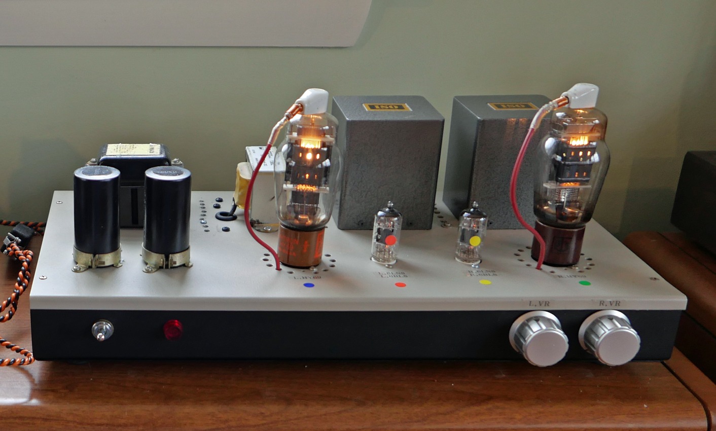

In 1930's ... 1960's equipment the valves are usually not sticking out, you only see them through the ventilation holes or slots. They do stick out in 1920's battery-powered radios with directly heated bright emitter valves, but it would be a waste to use those.

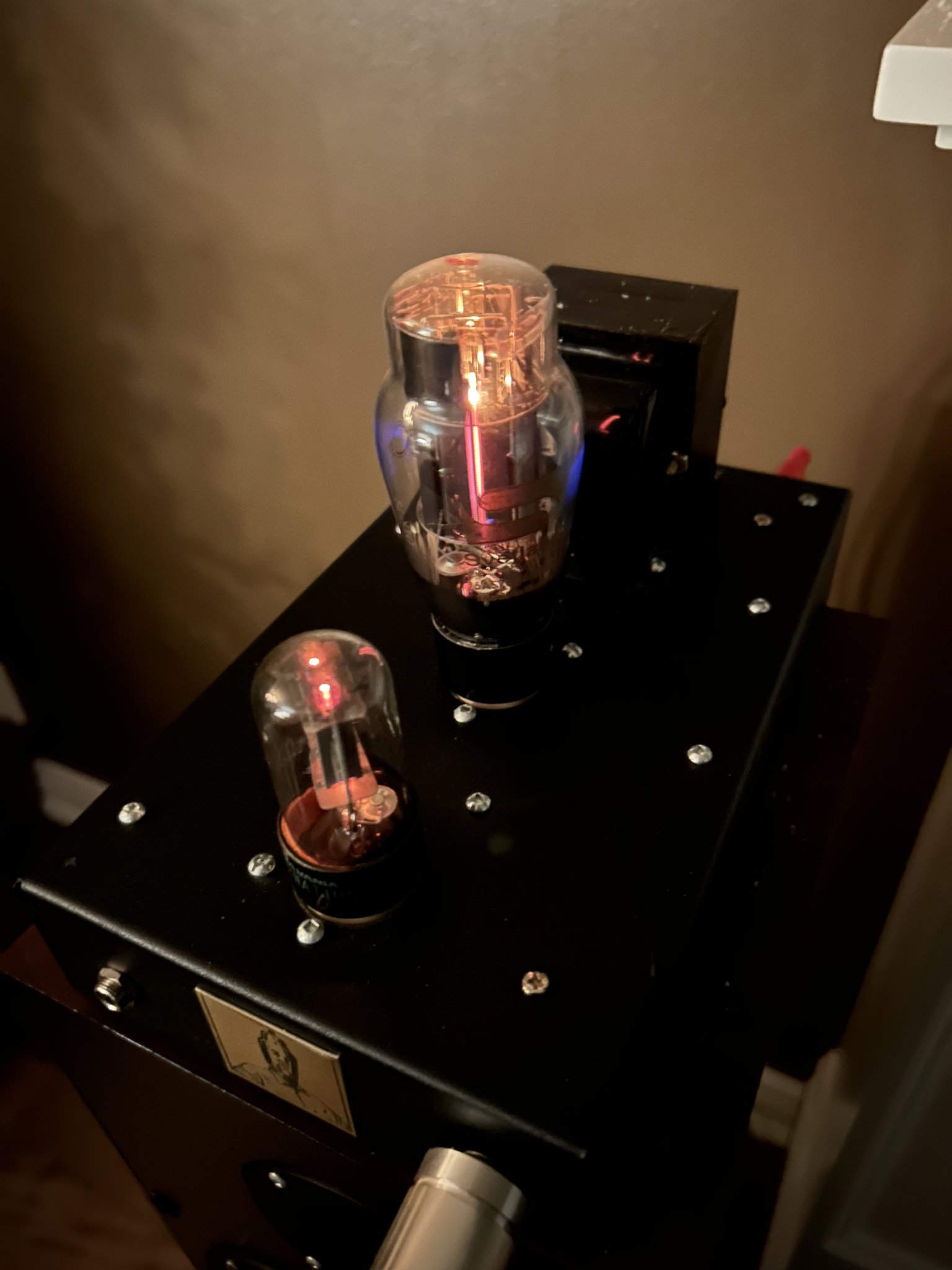

I used to have big russian rectifier tube on my headphone amp, i believe 5u4g, where you could nicely see glowing heater wires going up and down.
Nice to look at, lava red hot.

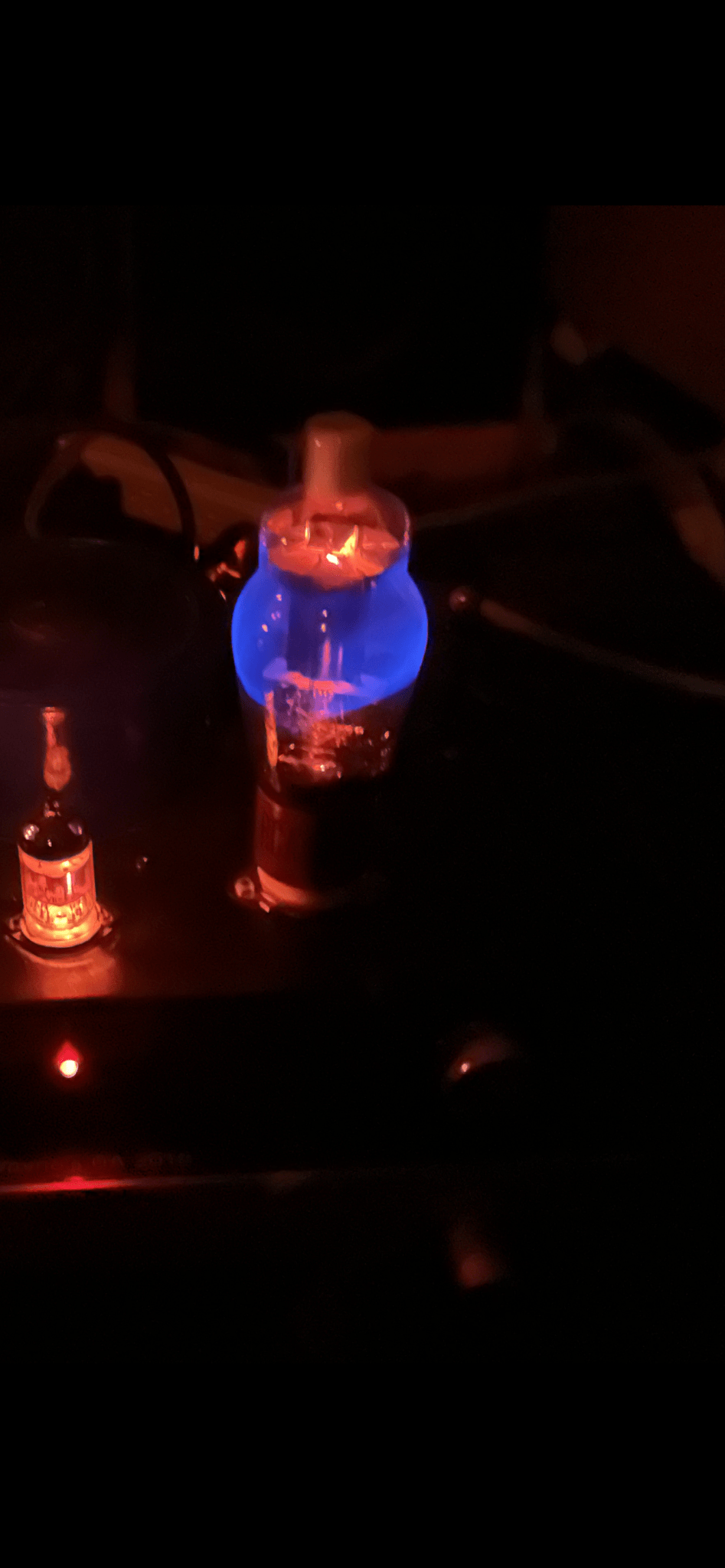

My favorite is the OD3 gas, Shoulder glass envelope version. Purple glow.
One resistor, one series diode, one OD3. Simple & pretty.
You can even use it to provide regulated 150V to a low plate voltage tube, cathode follower, or a medium voltage pentode screen.
Since this is for a solid state preamp, there probably is not enough voltage to run the OD3 . . . Unless you use a series resistor, series diode, and OD3 from the power mains (220VAC will work; 120VAC probably will not be enough (170V peak).
