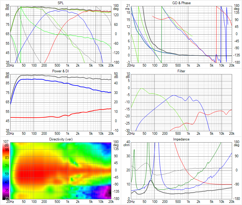

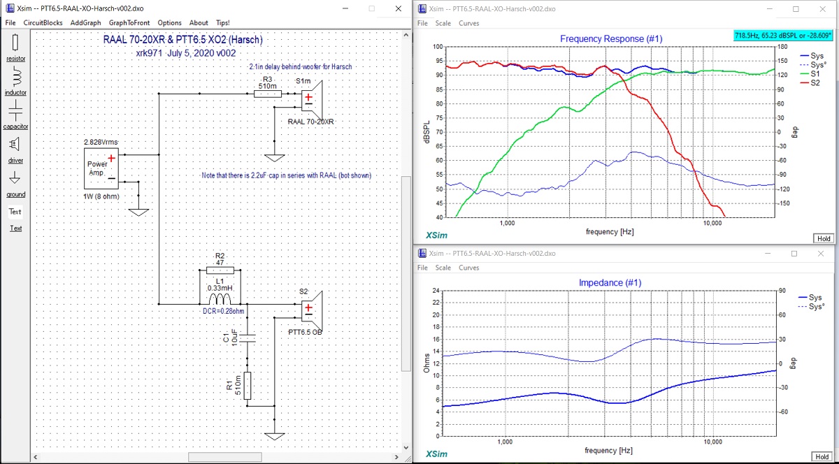

As we as mentioned, it depends on the drivers. They can sometimes have natural roll offs that permit virtually just 1 or 2 components on the XO.
I ran into such a case when I was just measuring raw driver in cabinet data for designing a crossover. I only put a 2.2uF high pass cap on the ribbon tweeter to protect it from DC (a cap is mandatory as it has a low impedance inductor internal to the tweeter). So 1 component. The woofer was running full range. Here was the resulting raw data plot of just the woofer, tweeter and combined system with a single 2.2uF cap.
Here is measured acoustic phase:
Of course, these are both SOA drivers in their category: Purifi PTT6.5 woofer and RAAL 70x20xr ribbon tweeter.
RAAL 70-20xr and PTT6.5 Compact TL
So sometimes it’s just plain luck.

I believe it's minimum phase.Can you explain the phase to me on that 2 way ?
0 degrees to -210 ?
not what I recognize looking at dunlavy stuff on stereophile
Dunlavy Audio Labs Signature SC-VI loudspeaker Measurements | Stereophile.com
so, the highs and lows are still moving around forward and backward, compared to a tight phase plot ?
Not sure what you mean by highs moving around. This phase plot is rather flat with a 55deg hill. Look at phase plot of an LR2 or LR4 and they wrap through 360deg, sometimes, multiple times.
True, 55 degrees is good, especially compared to steeper crossovers that are all over the place.
As far as I knew, the phase changing is also changing the relative distance of that driver at that frequency.
I’m fuzzy on this stuff but I can throw up some stuff from green mountain audio roasting a 24db lr crossover. Got to find it.
