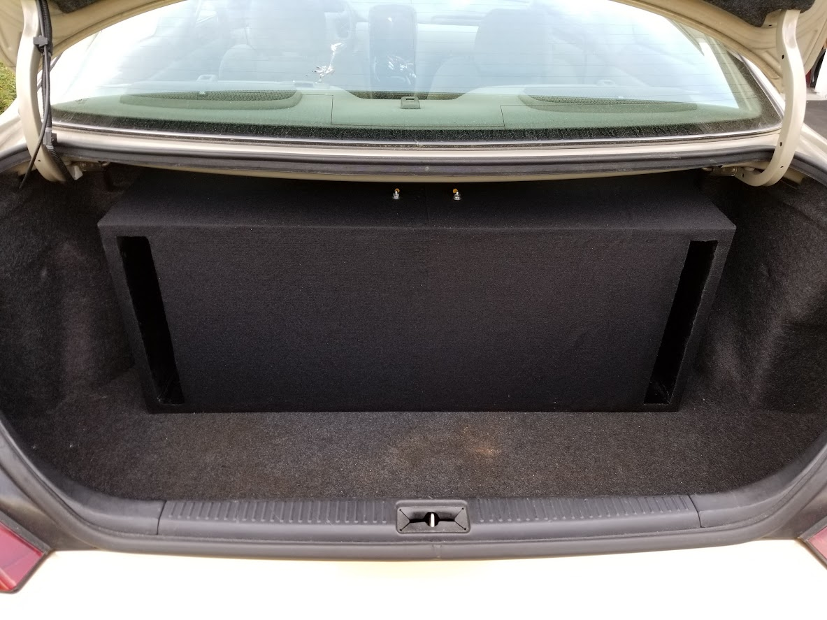

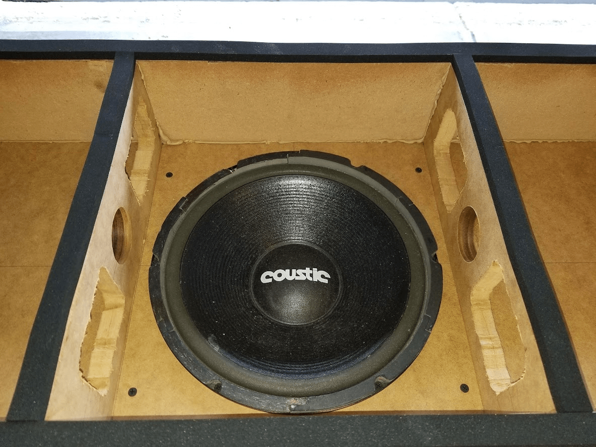

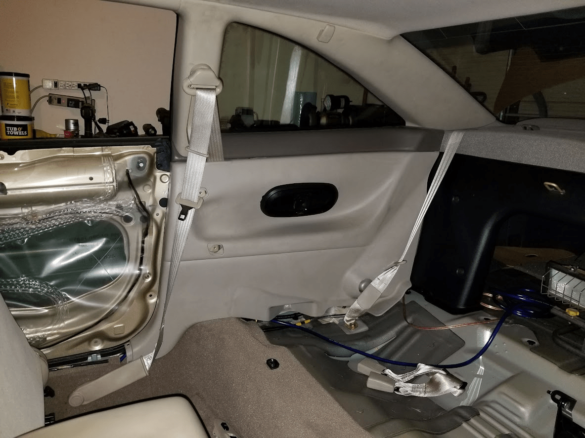

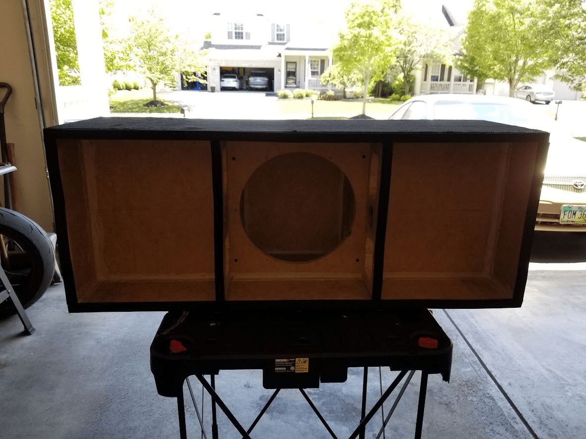

Would there be any benefit using a (mid)bass horn in a car? I have read that LF horns do not make any sense in a car since the car is a pressure chamber. I still believe there will be some gain left from the horn - but maybe the usable frequency is too high to do anything to the bass. The idea is to have a bass horn with a higher cut off that would be filled in by the cabin gain. Does that make any sense? I have some Peavey FH1 clones that fit my trunk - I wonder if it was worthwhile to pull one out, put it into the car and measure with open and closed trunk to see the difference in FR at the front seat. In a sense, the car walls would be a continuation of the horn, or am I wrong? It would be like sitting inside a horn. I am getting enough bass from the door speakers in my current car, so it is more like a theoretical question. I would maybe like to get a bit of the midbass horn "kick" in the car if that was possible.

The paraflex will be tested as well, I only need to clean the way to get the boxes out of the basement🙂

You exactly got my point - horn ending in a box - the crazy horn system built into the room is what I had in mind when thinking about this topic. I am actually buying a "new" car, which is quite used and I will have a chance to to whatever I want with it. I could not really do much with the current one, it was too new to do any irreversible things to it.
