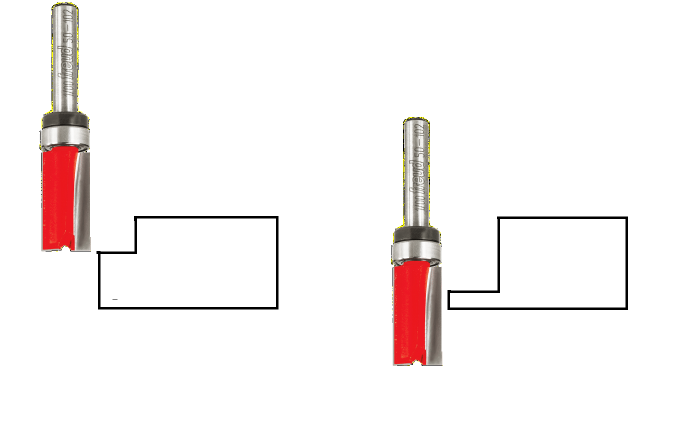

Most of the time I use a pattern bit with my circle jig, with a bearing at the top. See sketch.
Make several passes, maybe 1/8" or so at a time, until you have about 1/8" left.
Adjust the depth to cut through the last 1/8" without moving the router on the pivot. (Or use a drill bit with the same diameter as the router bit to go through it)
Then adjust the depth so that the bearing rolls on the previously cut surface.
Until you get to the last inch or so, the circle jig pivot will keep the router in the path. When it breaks away, remember to keep the bearing against the wall of the cutout.
