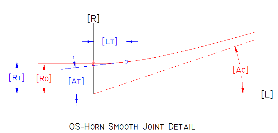

*Update/Corrections
Smooth Joint Connection of an OS-Horn to a Compression Driver
What follows is preliminary and probably has a mistake or two that I have not found yet. For the purposes of clarity, additional parentheses have been added to the formula. Any corrections needed are welcomed.
WHG/09-Oct-10
*Update/Corrections
WHG/09-Oct-10

WIP
Hi Ed,
I have an Excel sheet as well that was published on the web about 10-Years ago.
Just adding Freehafer's horn to it. So published the work here for others to use.
Like most other horns, it needs a Tractrix bell termination to make it finite.
A smooth match can be implemented as well by applying the same math regimen presented here.
Check your private e-mail for my address.
Bill

WIP2
Bill,
Hi Ed,
In your spredsheet, calculate [Lt] and [Ro] from [Rt] and [Mt] (or [At]) using the formula [15] and [18] provided here earlier.
Then recast formula [05] to
[Rl] - OS-Horn Radius at Profile Length [L]
= {([Mc]^2)*(([Lt]+[L])^2)+([Ro]^2)}^(1/2) ...[19]
Now the horn graph will start at the desired attachment point of [L]=0,[Rl]=[Rt] .
I will have an update shortly that will add a tractrix bell and refine the formula given here. These you may incorporate into your spreadsheet as well. I prefer horns with elliptical, rectangular, or 'bow tie' apertures, rather than those with circular boundaries that extend beyond the throat. This preference is based on the shape of the space being irradiated (typically of rectangular section) and the distribution of listeners to be covered within. Ideally the OS horn flair should be incorporated into the phase plug design of its accompanying compression driver. Presently most available drivers employ an exponential flair; so at best, the resulting combination yields a hybrid horn.
Bill
