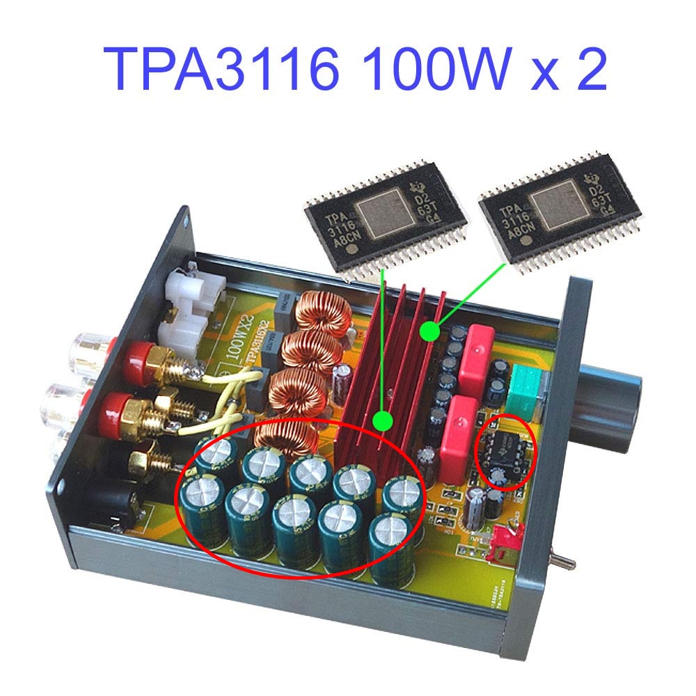

If your choice is between the Breeze and Senucn amps, spend the extra and get the Senucn, you will not regret it. I've set several clients up with "sound bar killers" using them and either the Elac Debut B6.2 or Fluance SX-6 speakers and they all seem really happy with them.
The TPA3116 is a 24 volt chip. At 24v with a 4.5 amp or better power supply you will get about 50 watts per channel on 4 ohms and 35 watts on 8 ohms. Doubling the chips absolutely does not double the wattage. It only allows the chips to run cooler at maximum loads. The output voltage from the amplifier is the same, no matter how many chips they stack up. So dual chips isn't much of an advantage unless you plan to pound the snot out of 4 ohm speakers.
Also be aware that super-cheapo companies like Breeze audio tend to cut a lot of corners in the manufacturing process. They are not beyond using counterfeits or recovered parts. If you look at the thumbnail attached you will see that I've red circled a bunch of capacitors, it is likely those are 25 Volt parts. They should be 35 volts, minimum. At 24 volts you don't have much of a safety margin on those caps and one or more is likely to burst causing all kinds of problems. Also note the red circle around the op-amp. They are using only one where most others are using 2 on the inputs. Finally, with two Class D chips you need to synchronise the clocks to avoid audible artefacts in the output and I don't believe they are.
As for the concern about the amps being powered up, but in standby when "off" this is actually a good thing. When you first turn on an amplifier there is a rather sizeable inrush of current while the bulk capacitors charge up. If they turn the DC power off this repeated inrush of current at power on will eventually kill your power brick and maybe the power switch itself. It is better to just keep everything charged up and ready to go, with the amplifier chip in standby to silence the device. Trust me, your smps brick will thank you for it... (This precludes the SMSL choices which do switch the DC mains.)
So ... The Breeze is cheaper but that usually means immediate modifications and parts replacements which will probably more than soak up the price difference with the Senucn amp that you can bring home, plug in, and enjoy from day one.
