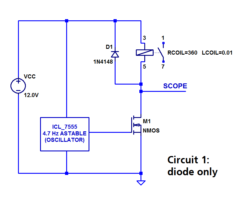

I'm in the process of making a relay-based input selector. I've done a bunch of reading on how to minimise the impact relays have on the audio signal in the case of a power supply that's shared with the analog circuitry. I know the ideal situation would be a completely separate and isolated power supply for the coil (i.e. its own transformer, rectifier, etc) but this isn't always practical on a tight budget.
So, how to best implement this? A flyback diode is mandatory, but how useful is an additional RC snubber across the relay coil? I'm thinking a 47ohm resistor in series with a 100nF cap, with the two of them in parallel with the diode. Like so:
Is this the correct approach? Or should I be looking at something else?

The RC is of no use. Just a diode reversed biased to remove the spike upon de-energising.
No worries using the same power supply either as long as there is enough current available and the coil is completely isolated from the contacts so no disturbance there either.

The use of RC versus simple diode really comes down to how fast you want the relay's coil current to collapse. The diode will always work, of course, but the coil current drops based on the initial current, followed by having a load of 0.7V across the coil when the polarity reverses. Only when the current falls to the actual dropout value does the armature open up and the contact clears.
The RC concept usually will result in faster current collapse, depending on how well the R and C values are chosen. With appropriate value for R, the inductive kick is well-controlled, and will not put any circuitry at risk.

Don't forget to include the resistance of the coil itself in your calculation. For example, this relay has a 12VDC coil that draws 30 mA; its coil resistance is 400 ohms. So when you turn off the switch that energizes the coil, the coil current flows in a series circuit composed of the flyback diode, the coil's inductance, and the 400 ohm coil resistance. There is a 12V drop across the 400 ohm resistance, plus an 0.7V drop across the diode. V = L*dI/dt and initially, at the first instant of turnoff, V=12.7. Not 0.7. The coil current falls at a rate 12X faster than you might expect; the relay shuts off quicker than you might imagine.... The diode will always work, of course, but the coil current drops based on the initial current, followed by having a load of 0.7V across the coil when the polarity reverses. Only when the current falls to the actual dropout value does the armature open up and the contact clears.

Here are three different ways to swallow the flyback pulse when turning off a relay's coil current. They trade peak overshoot voltage against turn-off time; this is no surprise since the inductor equation
In "Circuit 1" below, the external terminals of the relay coil are clamped to 0.7V during flyback {but remember there is additional voltage drop internal, thanks to the coil's resistance}. In "Circuit 2" below, the external terminals of the relay coil are connected to a resistor + diode; the initial voltage is 0.7V + Icoil*Rexternal, and it follows an exponential decay. In "Circuit 3" below, the external terminals of the relay coil are connected to a Zener diode + PN diode; this clamps the external voltage to 15V (above the 12V supply). I measured this data using a 2N7000 MOSFET, and ICL-7555 chip, a 12V bench power supply, and this relay (12V coil, 16A contacts).
As the differential equation predicts, the higher the clamping voltage, the faster the turn off.
By the way, the smooth exponential decay of Circuit 2's waveform, includes an unexpected little "hump". This is due to the changing inductance of the coil as the armature's magnetic circuit changes, when it swings from the NO position to the NC position. It's not so visible in the other two circuits's waveshapes, which are binary square waves.
