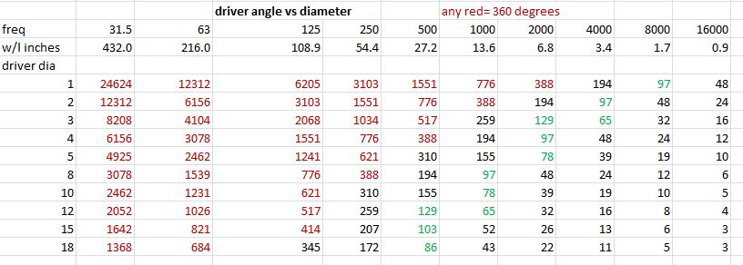

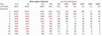

Here's a rule of thumb i pulled from a Stereophile interview with John Dunlavy.
His quote:
" A 4" midrange will have a very broad beam; the 15" woofer will have a very narrow beamwidth—you can find it by dividing 57 by the dimension expressed in wavelengths. That's the beamwidth."
If i didn't screw up, the chart below takes that formula to driver diameter.
All red values are 360 deg.
The green values are me tagging where 90 degree coverage was close....
Black are the narrow/beaming values.
His quote:

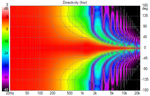

Ground plane measurement suits for any radiator type but requires lots of space. Diffraction simulator is another option to estimate effect of baffle size because cone alone does not define directivity to full space.
This is closed 12" in 340x340 mm baffle simulated to 10 meters with Diffraction tool of VituixCAD. Not exactly accurate for sure but gives some clue about omni limit. 1st contour is -3 dB.
