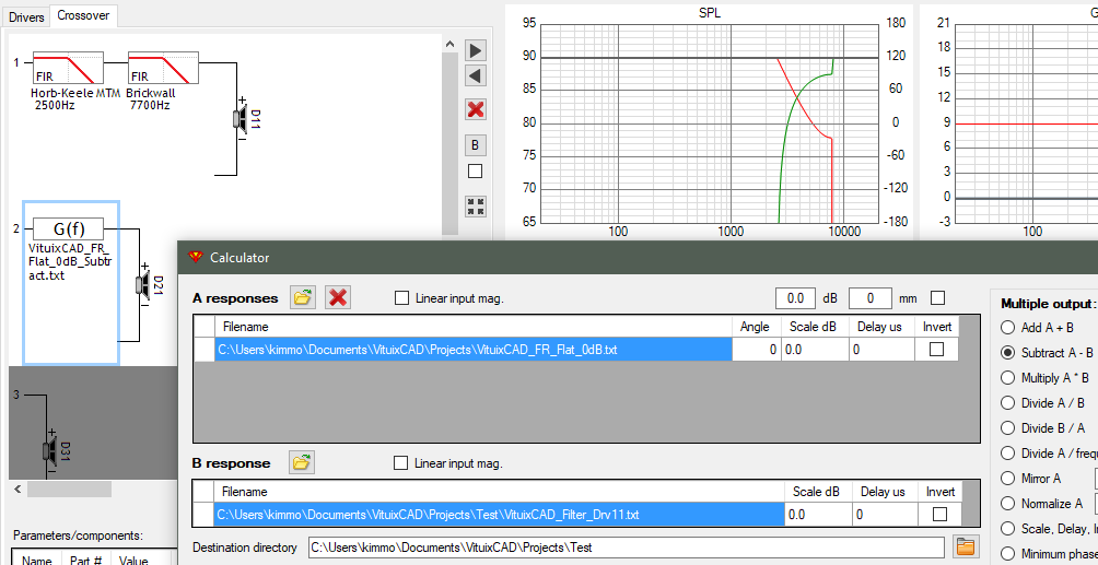

Simulated polar responses of single 1,2,4,8,15 inch drivers. Exported those as txt files from VacsViewer. Converted txt files using python into several that VituixCAD was happy to read. I have no idea if the phase response was correctly exported/imported.
In VituixCAD you can then use the response for a pair of distanced drivers. I tried to enter the active filters as seen in a table and graph here: http://www.linkwitzlab.com/Horbach-Keele Presentation Part 2 V4.pdf
Here is my result:
Some of the values are only eyeballed, but it looks quite similar I think. You might notice that I failed to implement the correct filter for the tweeter. If I could use the sum of 2 paths of active filters I could easily do it correctly, but I dont think I can and I dont see another solution.
Seems to do what it is supposed to, which might also indicate that the phase wasn't too bad? One probably shouldn't read too much into the rear response, as that wasn't even simulated anywhere. Unlike their vertical version, a horizontal 5-way would be a bit ridiculous due to its size. Then again it only looses directivity control at around 100 Hz, so one could probably easily scale it down to less absurd dimensions without much of a loss?
On the upper frequency end, control is worse than a speaker with a waveguide. But as the authors say a tweeter with its own control could be used. I wonder if a tweeter with a waveguide would fit well between the next pair of drivers?
Here is my result:
![Y4TMDfM.png](https://i.imgur.com/Y4TMDfM.png)
Patrick, what are your ideas for this anyway?
I could imagine a synergy horn as small as can be and woofers for low end response at the sides for power and control.
I have attached my folder with the VituixCAD project (which should load with all settings resulting in the above), a python script (I used a jupyter notebook so no cmdline parameters), and the abec project (just a reduced version from the one before)
Hope it helps
^You should remove excess phase from the measurements. Adjust timing of measurements (below frequency responses in Drivers tab) to negative value giving close to minimum phase responses.
Another option is to use Calculator tool. You can convert all responses to Minimum phase or set constant negative time offset before loading to main program.
