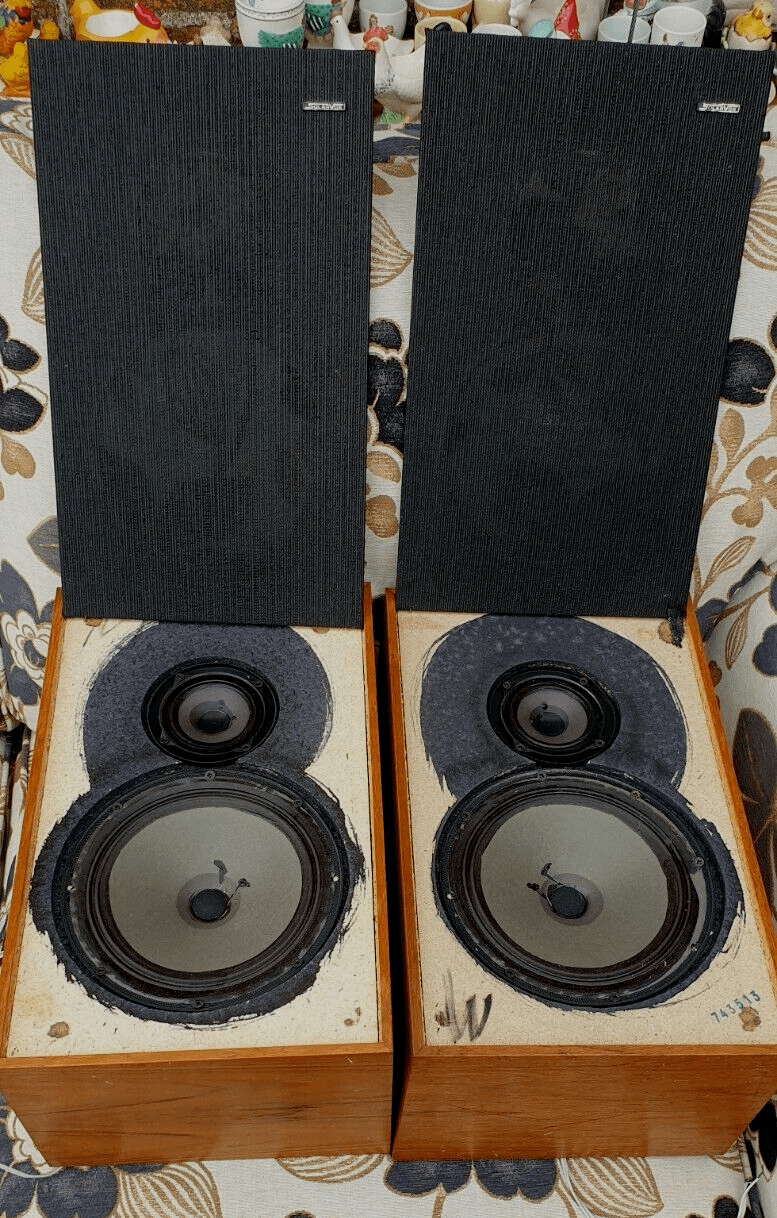

I recently acquired a pair of Solavox TK30 speakers and I'm wondering if anyone knows of the history or any tweaks that exist for this Speaker from a rare British Brand (Comet Electrical own-brand). The boxes are in excellent condition and are almost certainly the same as Leak 2020s as the overall dimensions are identical, the aluminium “picture frame” bezel on the front is the same as are the colour, round shape and typeface on the serial number labels. The speaker frets are the same material as the 2020s.
The only significant difference in the external appearance is that the drive units are stacked one above another, rather than having the tweeter offset to one side. The tweeter looks identical to that of the 2020, but there are no markings, and the bass/midrange is a paper cone unit with a single capacitor for a crossover, not the Leak sandwich type cone. The only other feature that might aid identification is a frequency response curve dated April 1976 on the back of one enclosure.
My theory is that, after Rank bought Leak, it was looking for ways to make the business more profitable and Leak had new designs on the drawing board that they could not afford to put in production because their existing range was not generating enough profit.
So when Comet came along enquiring about the supply of “mass market” hifi speakers, Rank saw a way to generate some funds without reducing the value of the Leak name, by using the Leak 20 series production facilities with component cost savings such as cheaper drive units and simpler crossovers which Wharfedale could provide as their speaker range went further down the price range.
I therefore think that the drive units are from Wharfedale (possibly from the Denton), and the combination of Leak enclosure with the Denton drive units should have resulted in a reasonable loudspeaker. I believe that the Solavox speakers were slated for muffled treble but I don’t recall any reviews.

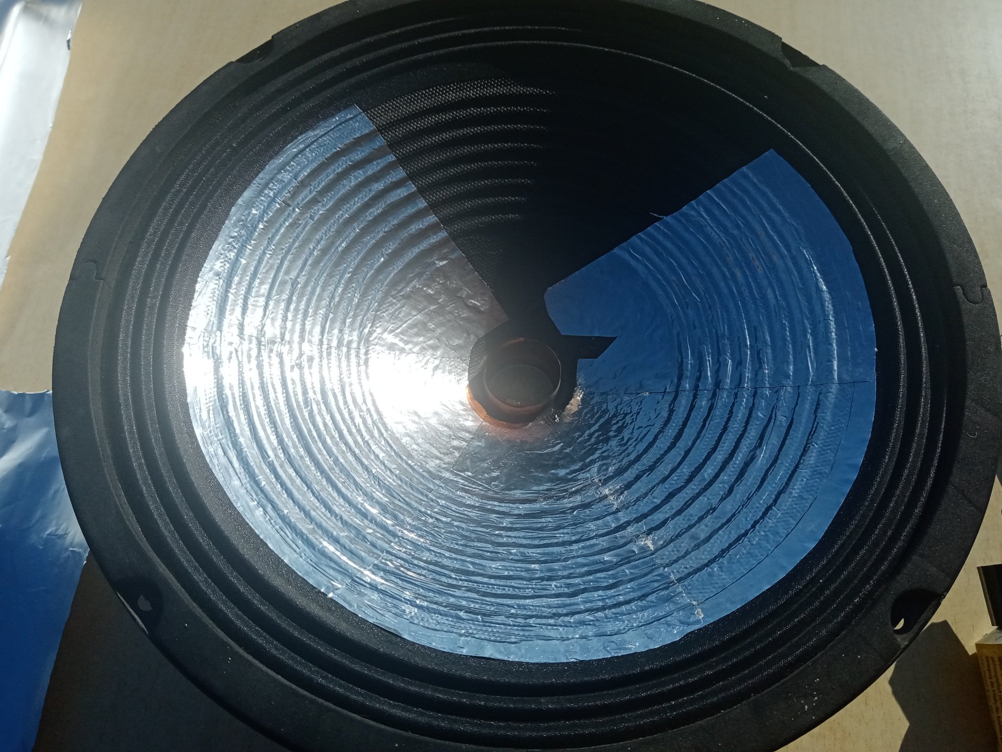

I do sandwich cones myself with paper cones and mellow aluminium foil and not with hard foam and duraluminium like in the Leak construction aiming for maximum stability.
Difference is that this combination is ideal for fullrange drivers. You need no network.
And you get the good impulse reproduction of the sandwich technique.

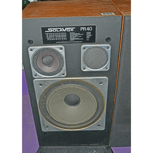

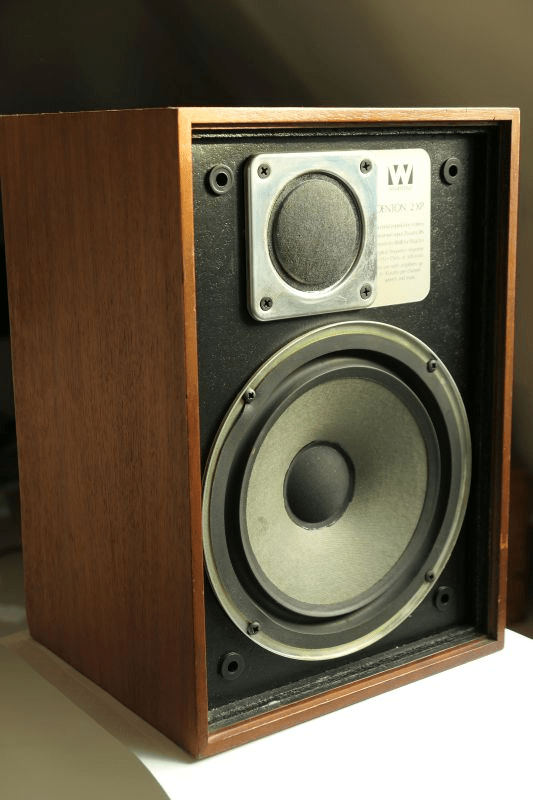

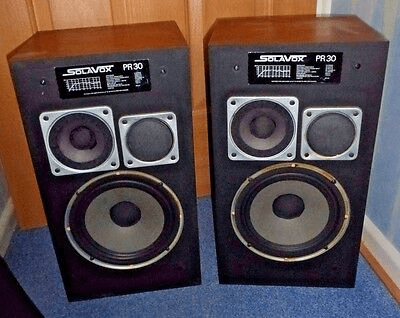

Illustrated above is the Solavox PR30. Below is the PR40, whose Wharfedale looks are unmistakable.

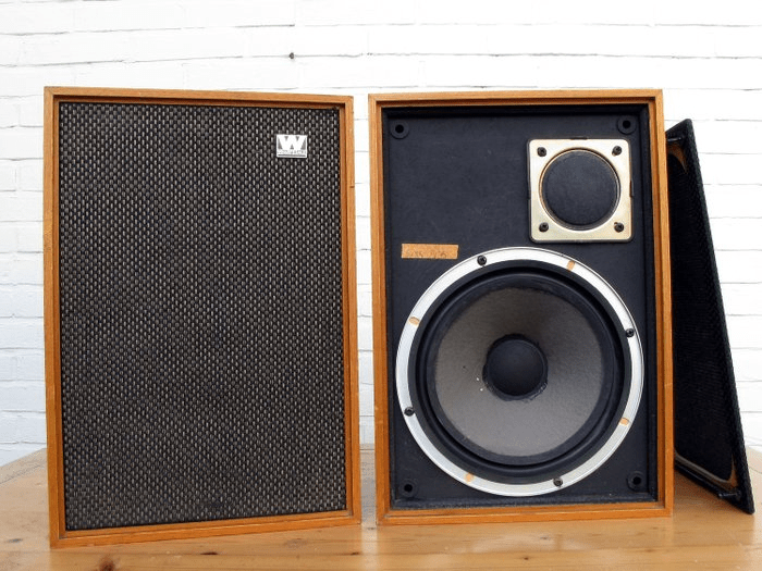

Compare the above image with that of the Wharfedale Glendale 3XP below.
The only obvious major difference is that the Glendale used a more sophisticated Wharfedale/Leak midrange unit.

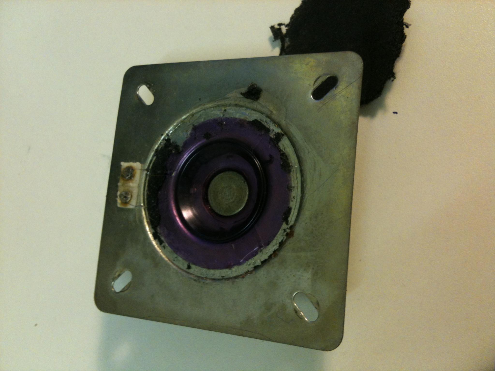

You may be interested to know what's behind that acoustically transparent tweeter cover (see attachment).
The famous Wharfedale/Leak synthetic purple tweeter material is used for the cone.

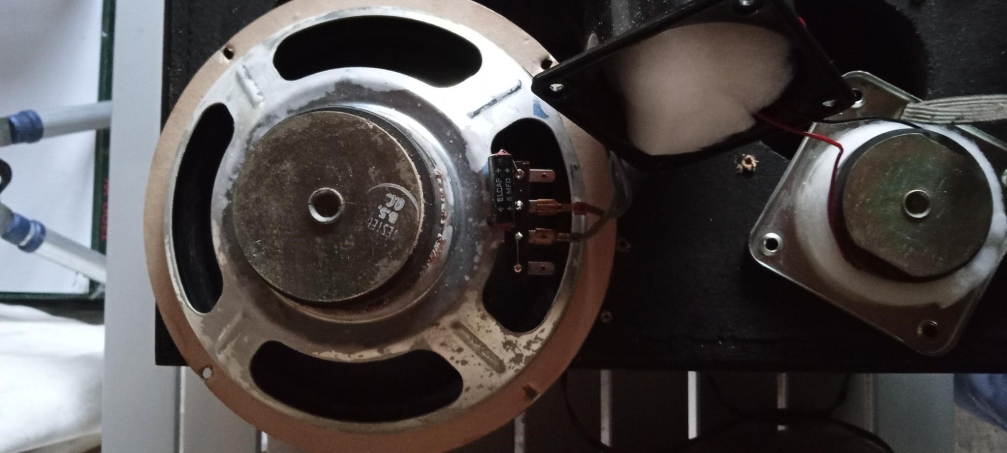

As for identifying the mid/bass driver, supplying an image of its reverse side may be helpful.
Hi Gaul, Thanks for the photo, that does look rather similar to the bass unit in the TK30.
I've attached the rear viw of the drive units, a bit of corrosion but the cones seemed ok although I haven't remove the foam from the tweeters. the single capacitor across the bass unit terminals is an ELCAP 6MFD 50V item - no inductors. I have now tested the speakers and all four drive units are working so at the moment I'll use them in the garage until I find out if there are any reasonably priced upgrades for the drive units.

The mid/bass driver looks identical to those inside the Dentons I have in my collection, apart from the four terminal arrangement which permits support for the tweeter capacitor. The tweeter is connected to the outer terminals of the four.
To be clear, the capacitor as not connected across the mid/bass driver voice coil, but is in series with the tweeter.
To use a single capacitor as the HF filter was an obvious cost saving exercise, as my Dentons have a full second order crossover network comprising two capacitors and two inductors.
You may be interested to know that I have experimented with my Dentons by removing the full crossover network and simply running the mid/bass driver 'full range' with 4.4 uF worth of capacitance in series with the tweeter.
That seemed to bring a bit more life into the reproduction, even though I'd previously recapped the original crossover network.
I advise you to remove the ageing ELCAP capacitor and replace it with a new bipolar electrolytic like this 5.6 uF one:

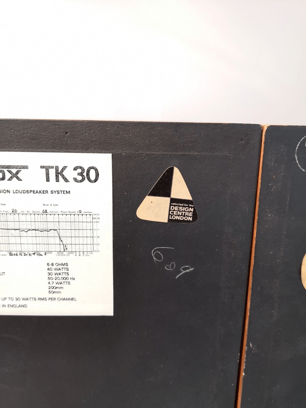

I see a pair of Solavox TK30 speakers at auction right now.
Given your interest in the design/quality of the enclosures, I'd like to point out that the speakers carry the 'as selected for the Design Centre London' sticker.
Click on the image to magnify the sticker.
I visited the Design Centre premises in the late 1960s where I was quite taken by the design of a Rogers HG88 MKIII integrated valve amplifier which carried the Design Centre label, and which I subsequently purchased on returning to Scotland. It's still going strong some 55 years later!

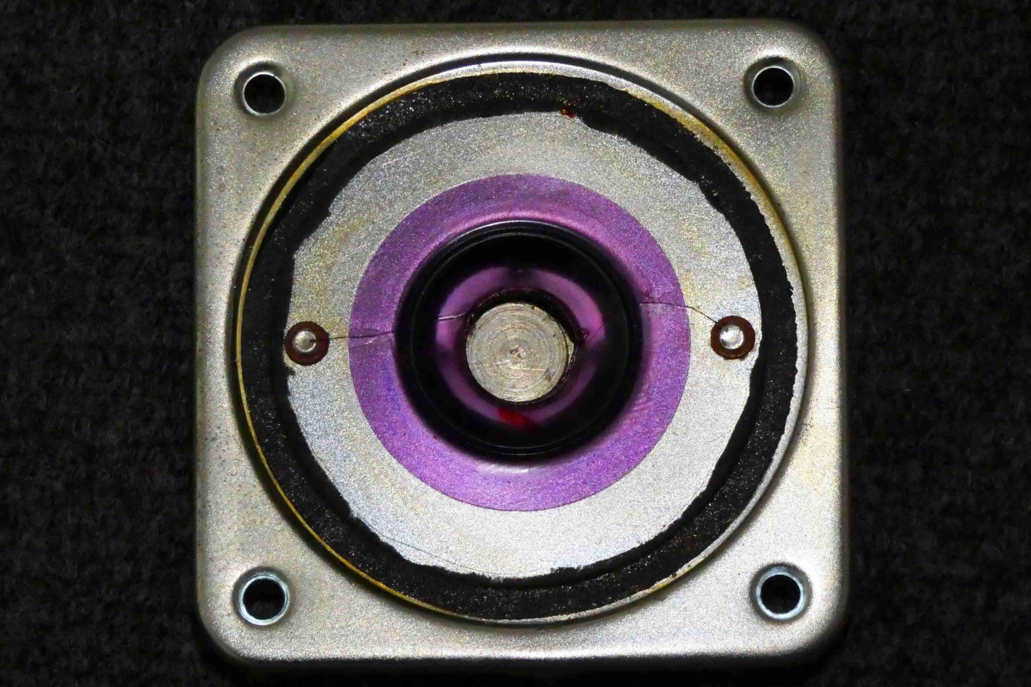

Here's what the TK 19 S drivers look like:

As for the Design Centre label, my speakers have the same label and I tried to find the citation for why the TK30s deserved the award. Sadly the Design Centre no longer exists as such and the archive of awards appears to be at Brighton University and restricted in some way. There are photos of a selection of DC award products in Victoria & Albert Museum photo archives, but only a limited number of hifi items and no citations ,but the Rogers amplifier may be in there somewhere. When the awards were alive, they were a good way of drawing attention to good industrial design, so not only products that looked attractive but also those that were functionally distinctive - it is a bit sad that "design" nowdays is used mainly in the context of aesethic design rather than recognising the quality of performance!
