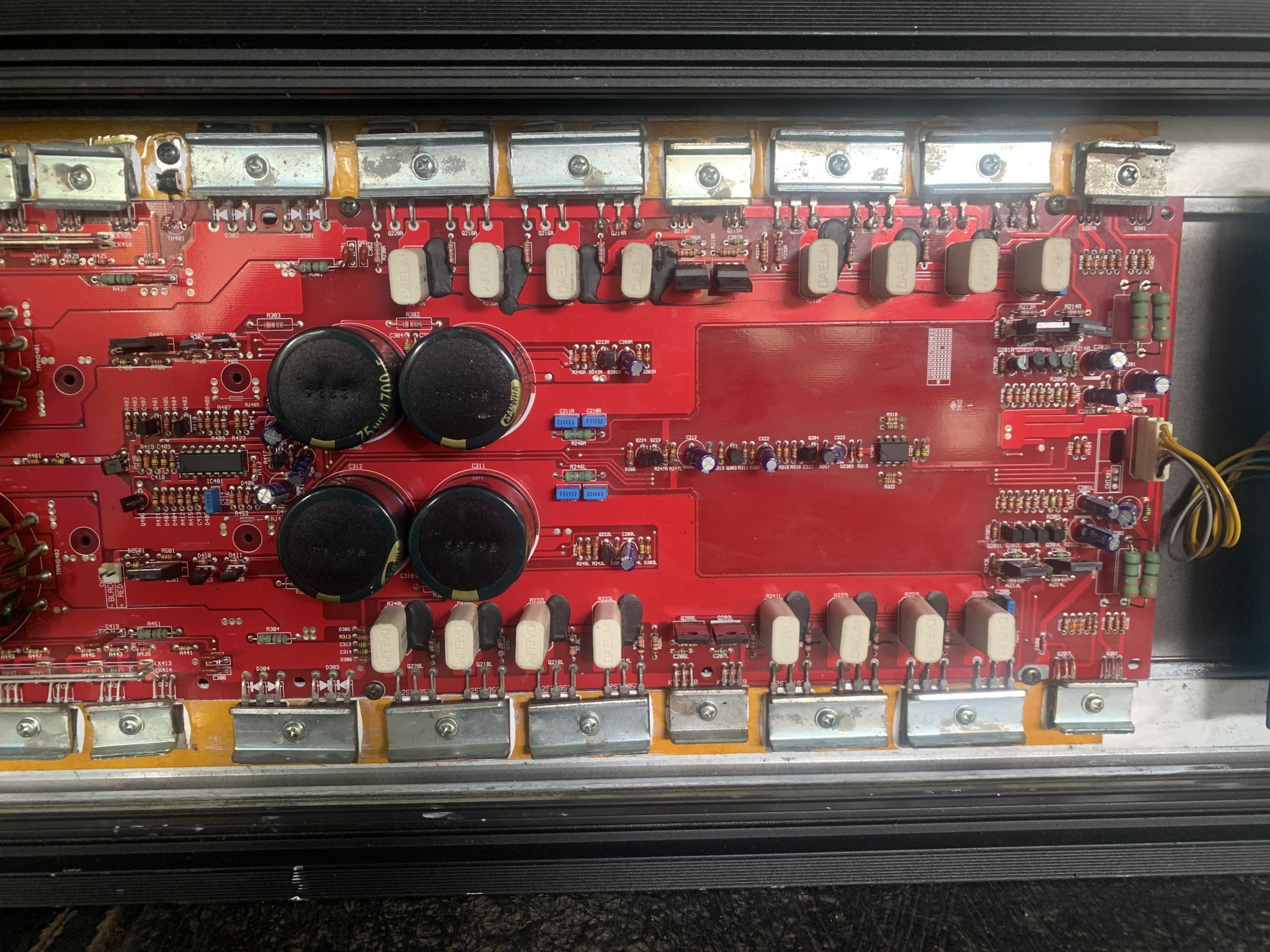

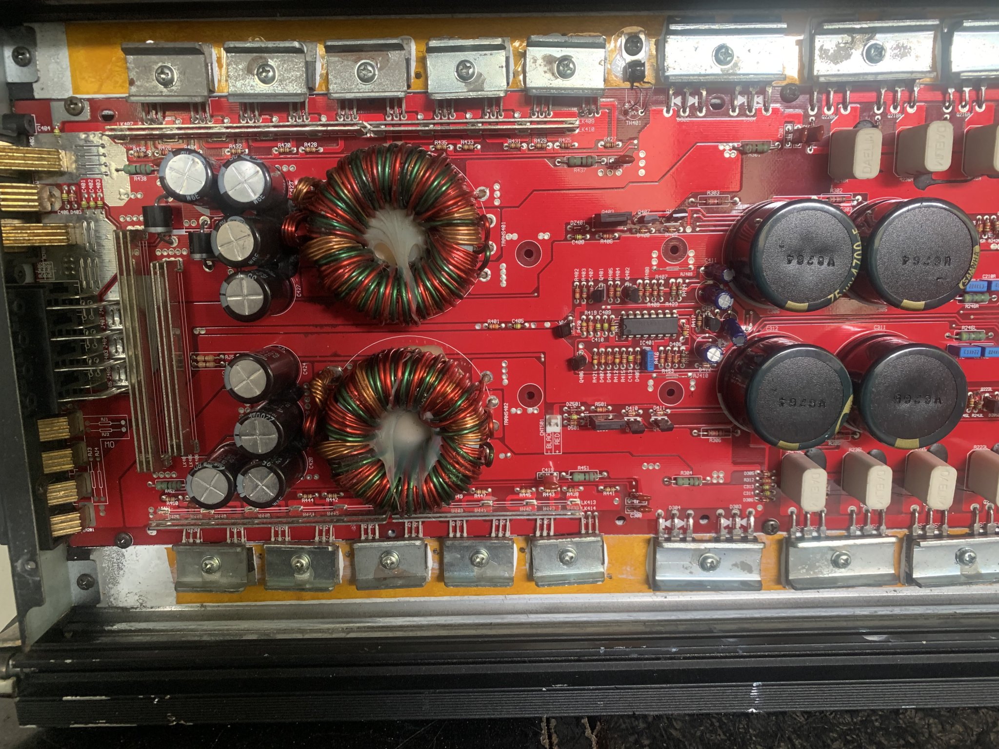

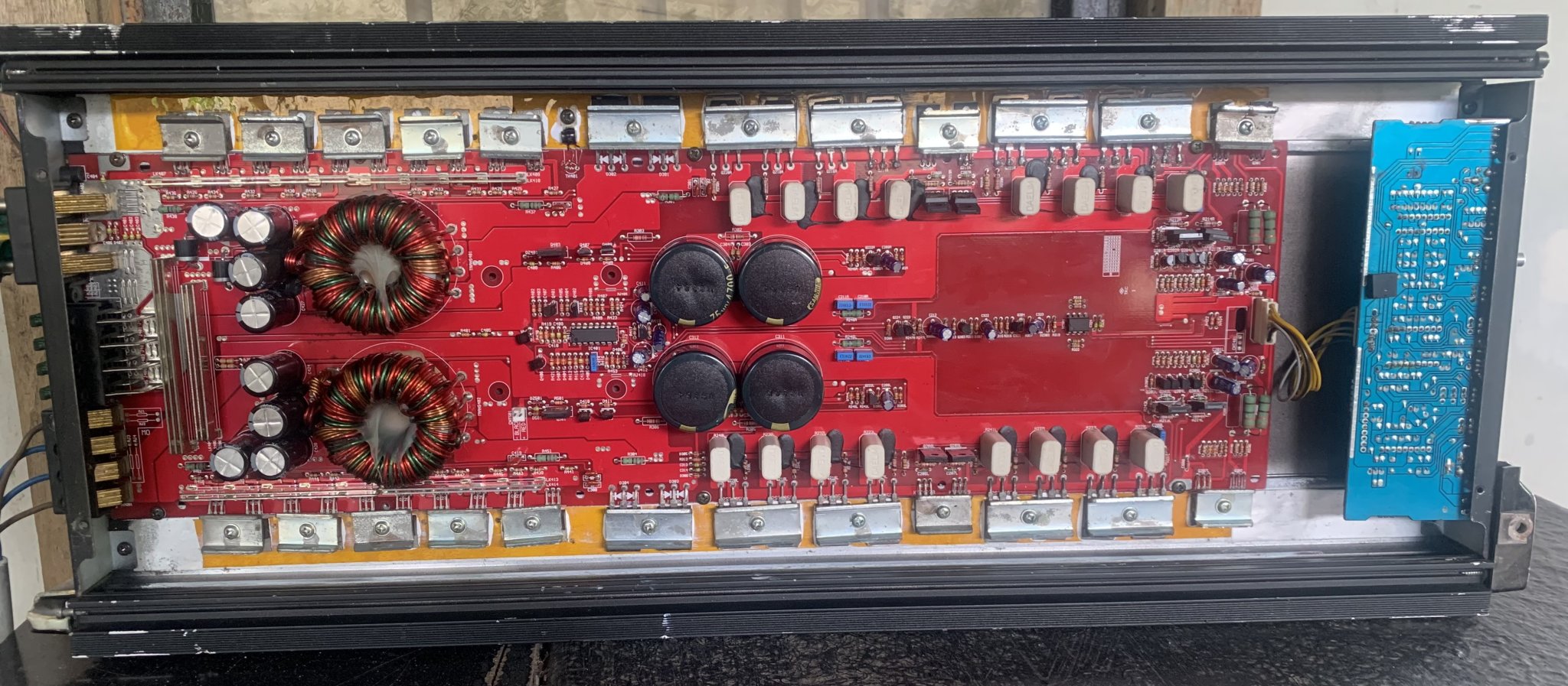

Does anyone have any schematics or similar schematics for solid audio f2000 amplifiers? The board is very similar to American Bass SQ3000 amplifier.
I got this one in and several demons to work out, severely mixed amplifier components, to-247 and to-220 in both channels, with the shorted components removed, the unit goes into protect. Disabling protect, the unit powers up ok with good rail and regulated voltages. But there seems to be DC at the R-ch Spk terminals.
Haven’t disassembled fully yet, still assessing.
