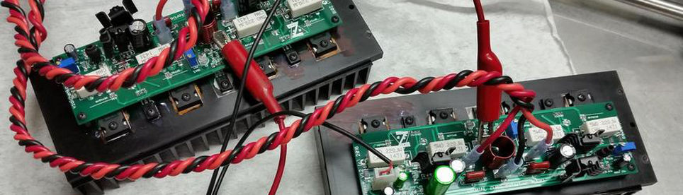

VHex+
VHex+ with one pair of output devices, downsized to 30-35W output power.
Excellent amplifier, sounding great at 1W or close to clipping. It's really pretty unique, utilizing an elegant voltage gain topology. You will not experience lack of detail for sure.

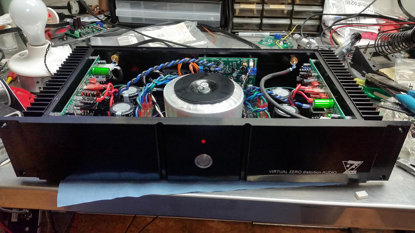

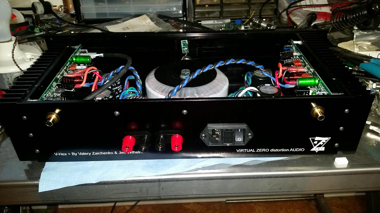

Here is the build by XRK:
VHex+ in a simple compartment
See some professional measurements and feedback there, above the post down that link.
Available in the form of boards, kits, assembled/tested modules or a fully-built amplifier.

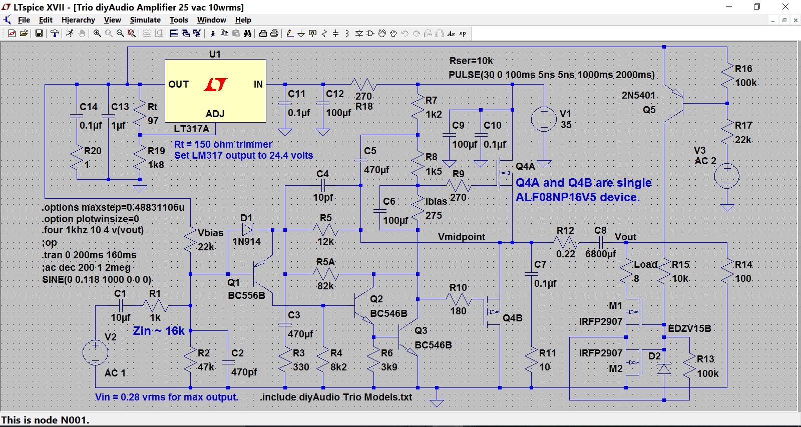

How into diy building a design are you ? Do you need PCB's and full instruction or can you think things through and work with an untested design, because I might have just the thing ?
Simple, it uses (or originally used) just three transistors.
Adding a fourth makes it much better though.
Low power. It can use from 18 to 40 vac transformer and its single rail. That allows the possibility of dual mono construction from a dual secondary transformer.
Power output of 6 to 40 wrms depending on transformer voltage.

I can make my own pcb but can't test...don't have an oscilloscope so I would need a tested desihn...but if you like you can post your idea...we can work together

Well this started out as a three transistor design using the dual lateral FET from Semelab. Unfortunately stocks of these have sold out although suppliers are saying there will be more early next year. Of course you can use a normal pair of devices... it just adds another device to the component count. Q2 and Q3 could be a single Darlington device but I found the (real not simulated) performance was so much better with a discrete darlington. The voltage reg can be the LM317 for all but the highest voltage versions and for those there is the LM317AHV which has a 60 volt rating.
The parts to the right are just a solid state relay to eliminate switch on thumps. A 'rapid' charge version using two such relays is possible whereby the initial load is a low value resistor.
The zipped folder contains a couple more images and also the simulation file and models.

Mooly, I think your input biasing still needs some work. Doing the math, you could end up with about 6 mV of output noise with the input open, and still 1/10 that with it shorted. Not great either way - good integrated amps are at ~100 µV. Plus, midpoint voltage tightly regulated but a presumably unregulated supply?
I'd just tap an R - D - (R||C) voltage divider between supply and ground with your 22k. Simple, low noise and provides good tracking over a fairly wide range of supply voltages. There have been other solutions but this is one of them.
You make a good point actually and yes, the supply would be almost certainly be unregulated. I must see how that compares for ripple rejection and so on.
The complexity has grown from my first thoughts about a design like this. As they do 🙄
