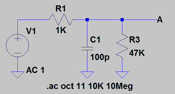

You may find that the 70s amps are simply picking up RF noise on their outputs, coming from the computers SMPS. This is because those amps typically dont have any kind of lowpass filtering on their inputs to prevent this, whereas amps from the 80s onward typically do (for use with CD players).
A quick test - add 1K resistor in series with the input, with a 100pF capacitor to ground on the amp side of this resistor.

The main reason for the input filter is to snuff out the chance of any RF picked up by the signal cable being rectified by the diode junctions in the input stage. I have always used 1K/100p as a "rule of thumb". 2K2/100p has -3dB at around 720KHz which generally works well.

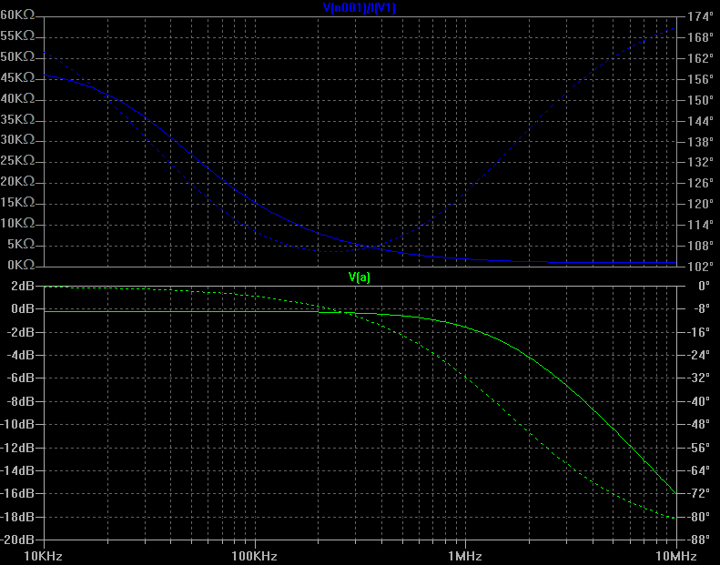

It's not so much about the low pass filter effect on audio, more to do with the effect on input impedance it has at megahertz frequency. Attached shows a typical input network simulated in LTSpice.
Bottom trace shows the filter rolloff, but the top trace shows the input impedance seen. Notice how when we're up in the megahertz region, there is a very low impedance to ground. The RF is shunted to ground instead of being rectified by the input stage, which leads to the noise.
