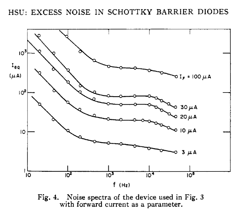

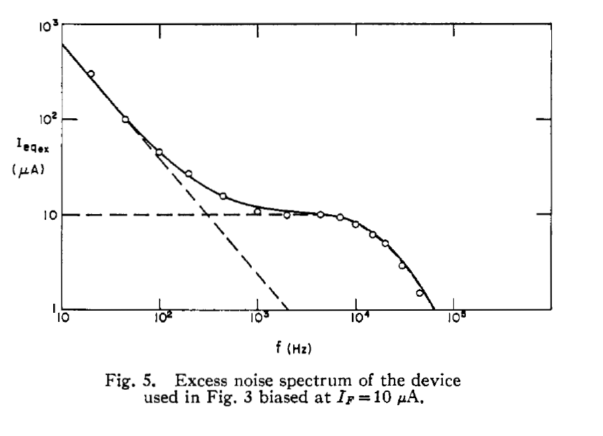

Hello I found this article :
https://ieeexplore.ieee.org/document/1476205
About schottky low frequency noise. I have never seen it discussed on this forum. It is said to that schottky diodes produce more low frequency noise than PN junction.
Does it matter in ou PSUs ?
Any noise measurements ?
Thank you.

No, it doesn't. It could matter when you use a Schottky diode forward voltage as a voltage reference, which I've never seen anyone doing, but not when you use it as a rectifier.

Thank you. I think we have a pretty good psrr below 300Hz. But anyway the low vf of schottky and no recovery is still worth it vs PN diodes.
