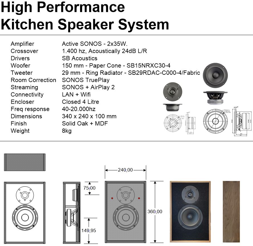

The new amp cabinet – made of bamboo also from IKEA - 2 x Monoblocks🤗
The new speaker enclosure made of solid oak + MDF.

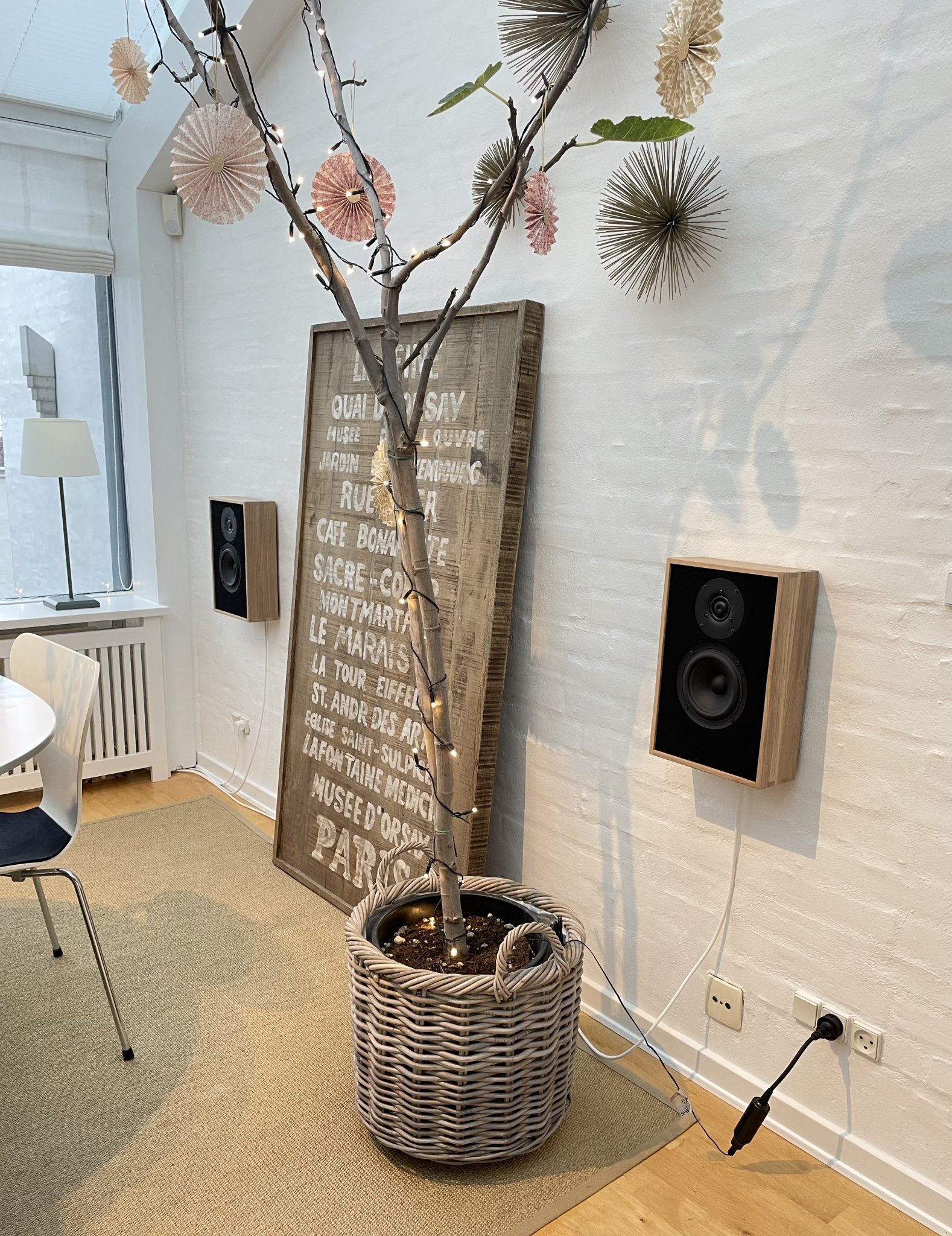

Now in stereo…
And a new TruePlay setup
So almost finish…
Front cover missing
So almost finish…
Front cover missing
I like your xmass tree 🙂Now in stereo…
And a new TruePlay setupView attachment 1009312
So almost finish…
Front cover missing
