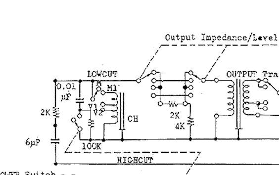

I'm having a go at building my first valve mic , and looking at various circuits. The Sony C37 appealed because of it's simplicity and offboard output transformer, but there is one aspect that intrigued me - it's a Cathode Follower design but there is no capacitor between the cathode and the output transformer so there is a fairly high DC on the transformer. All of the non CF designs I have seen have a large high voltage capacitor blocking DC from the plate , and all CF designs I see in amps and have used myself have capacitors too. Is there any downside to this ? I'm assuming it doesn't affect sound quality or the mic wouldn't be as revered as it is , but does it change the tolerance of the winding wire used?
As far as I can see, there's a 6uF cap in series with the xformer, thus AC coupled.
Jan
Jan
The cathode (labelled "3") connects to a 6 uF capacitor. The transformer comes after that.

It's in there, badly drawn.there is no capacitor

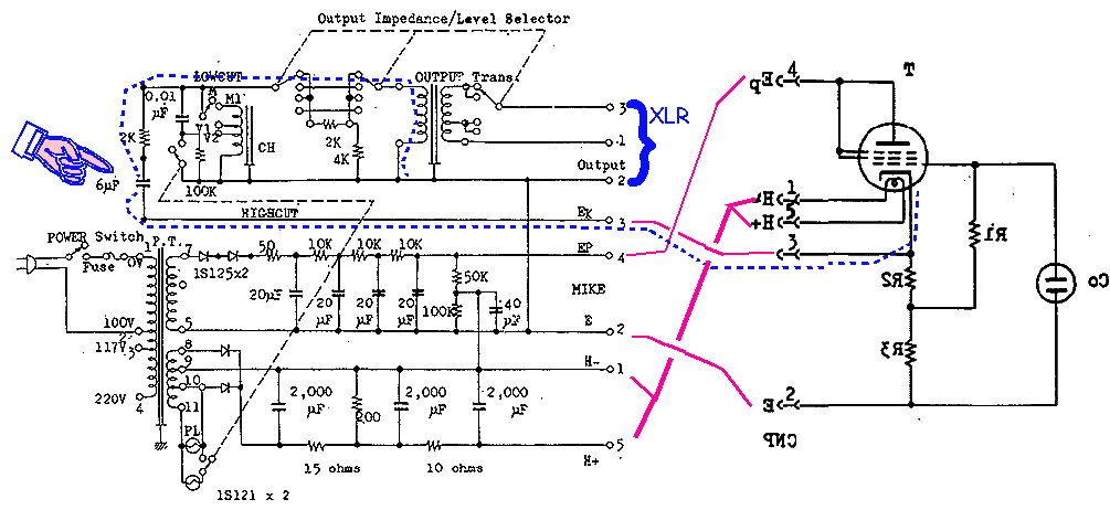

Mirror the mike-guts so the pins point to the power supply. (Or mirror the PS, but the mike is simpler.)
looking at the wrong number 3 pin
Yes, there are TWO EACH of pins 1 2 and 3. Realize that the audio transformer secondary is an XLR mike plug and ignore it.
Draw connecting lines.
Blue-dots is the mike audio path.
While it takes the long way around the bush, we see clearly what PFL200 spotted quickly: 6.8uFd in the power supply. Perhaps to keep its bulk and weight out of the can. Try to find photos: this may be a huge film-cap not a tiny e-cap.
To keep things confusing, the output terminal numbers don't match XLR pin numbers. On an XLR plug, 1 is ground, 2 is positive (hot) and 3 is negative (cold).
All your replies much appreciated , I have one more question regarding the filter setup. I am trying to figure out how the high-cut and low-cut work, making pretty poor attempts to model in LTSpice but I've only just started using Spice and I'm not sure how to represent a choke - if that is what it is , it does say "CH".
If it is , should it be common mode or differential? And possible value? There is an M followed by something , could be MilliHenries I suppose....
