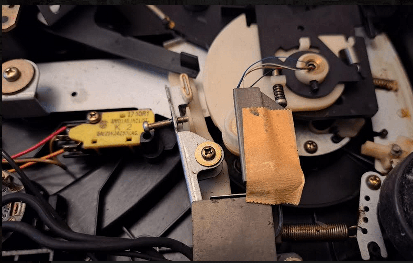

Back 'home' and I wasted no time in taking the turntable out of its place and inspecting it. I was a little dusty, and is quite heavy. The platter mat had an oily look to it, and this is possibly due to the deterioration of the platter mat, these turn oily after decades of storage, so this seems to be the culprit.

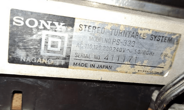

First thing was to check the label for input voltage, and the numbers on the label confirmed that the thing could run with 120 to 220 V. No problem here, as the local voltage is 220 V.

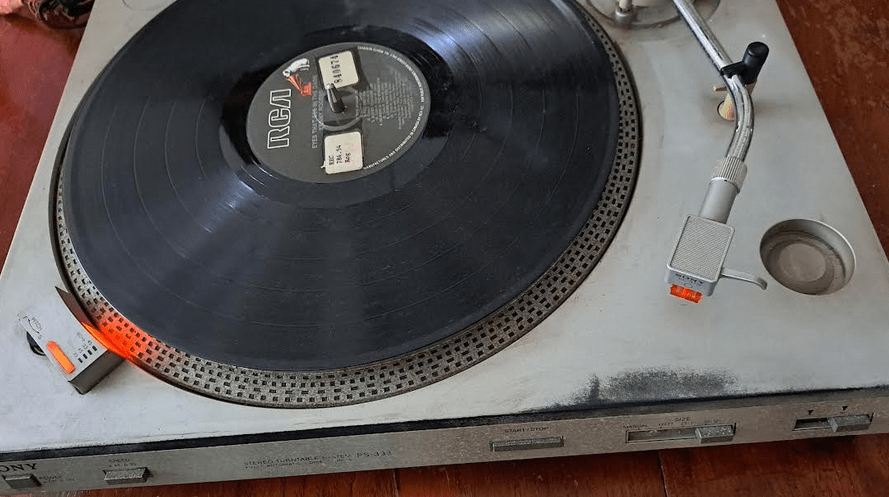

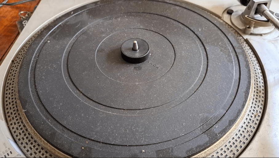

The next thing was to check the turntable platter: it could be turned by hand, though it seemed to spring back to its initial position. The tone arm switch did move it up and down and the tone arm was free to move.
Powering up, I found that the orange light on the left lighted up, and turning the platter activated the automatic tone arm, so that it move the tone arm to the edge of the platter, or just before, and stayed there. Moving the arm to the middle while turning the platter again moved the tone arm back to its resting position. All this was motivated by what I had read somewhere that the automatic stop mechanism may have to be reset (or it was a YouTube video) for a turntable to work.
I coaxed the platter around again and it took off on its own, with no noises from the bearing at all. A record placed on the platter confirmed it was working, but the thing on the end of the tonearm did no look too much like a cartridge. There is a replacement stylus or a cartridge which I may try tomorrow.
So the turntable is turning, finally, two years after being taken out of storage, and 25 + years after being purchased new.

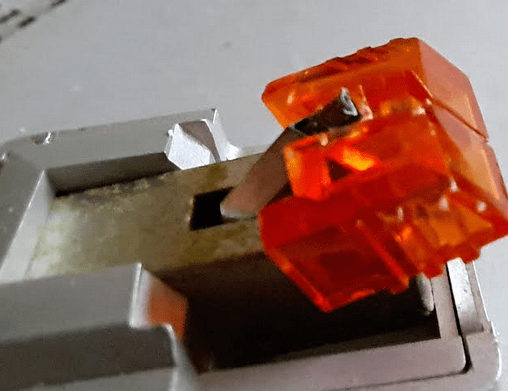

It was easy enough to remove the cartridge by unscrewing it from the tone arm. Two vertical notches were provided to locate the cartridge vertically. This was done earlier, and an image of the cartridge is included.

I cannot make head or tail of the cartridge it seems to be stuck halfway, it is the second on in this web page:
https://www.dacapoaudio.com/220-sony-stylus-replacements

1.If motor is lubricated for life and works properly I recommend you to leave it for now. Something that old can be easily damaged if you take it apart.
2.If strobe shows correct speed than I say yes.
3. For oily mat, try to save it by washing it in warm water with some dishwashing fluid.
For rest, wipe it with soft cloth lightly moisturised with antistatic window/surface cleaning fluid. Be careful, some of these fluids may contain vinegar, avoid them!

Speed is all over the place, and very fast, not responding to pitch control. I have read that this means the pots have to be cleaned, or the coarse adjustment done from inside. There is also an accompanying clicking noise and a cricket-like sound periodically.

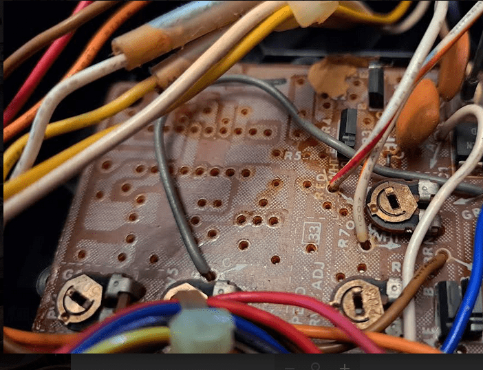

Pitch pot is usual suspect, and there are few trim-pots on pcb inside that may loose contact too.
Speed is controlled by magnetic strip inside platter rim and magnetic head (looking like tape-head). Dont put the platter close to any magnets, if magnetic strip is demagnetized (or damaged) you'll need a new platter. Magnetic head should be clean and close to platter, but without touch. Sometimes, demagnetizing the head can solve the problem. Keep the platter far away if doing this.
Check the pcb visually for oxidation, leaky electrolytic caps, burned resistors, bad looking solder joints, cracks, loose contacts etc.
If that doesnt help problem is more complex. If you don't have tools and experience leave the repair to expert.
From the pictures, it looks like something was spilled on TT, there are stains on mat and top surface. That could damage the electronics.

Your TT is PS-333 not ES-333. I suggest you to hit report button and ask mods to correct the thread name and avoid confusion.

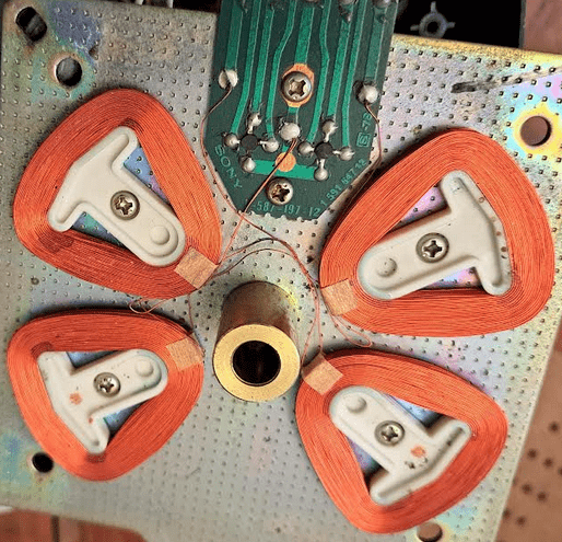

The platter is simply not starting on its own, it has to be turned by hand, after which it spins at 66 rpm despite pitch adjustments or swtiching between 45 rpm and 33 rpm. The speed varies about 4% or more.

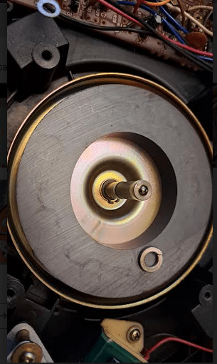

After disassembling the rear panel, for which I had to turn the turntable upside down, there was a noise from the motor when the turntable was placed on its feet and the platter turned by hand.
Once again I opened up the panel, and opened the motor section.
Inside was a C-clip. That explains it. I will be searching the manual for the C-clip position.

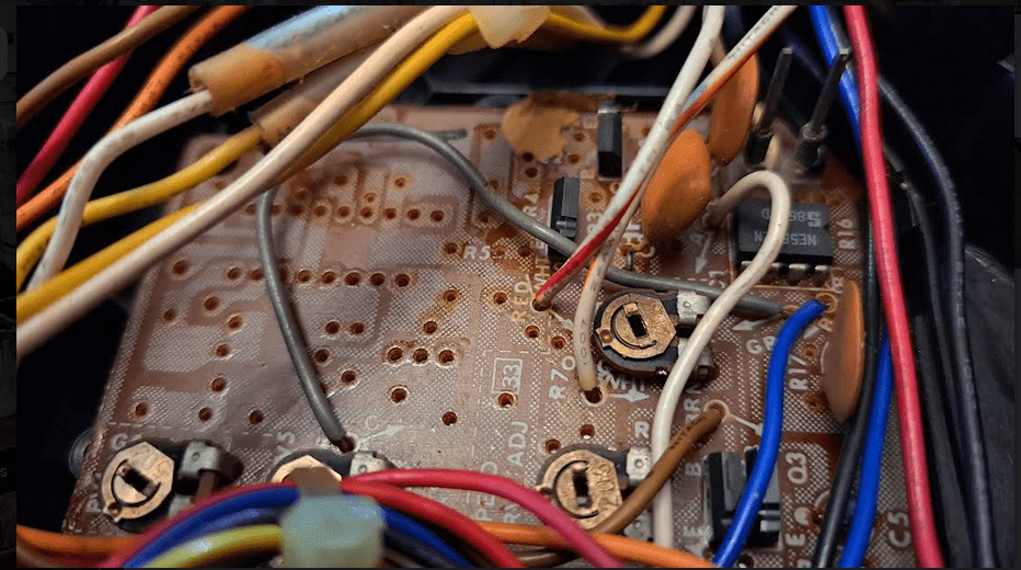

The next step is to clean out the contacts for the R7 etc with contact cleaner and try again.

I gave quick look on schematics. Motor drive has two amps with hall-sensors (for brushless comutation). If one of these are faulty motor won't have starting torque, but it will rotate if you spin it by hand (just like AC motor without starting capacitor). I'am not sure about speed issue, but if motor tries to lock with one pole missing it will result in double rpm, 66 instead of 33.
If you know how, try to check trim-pots RV4 to RV7, transistors Q6 to Q9, IC2 and surrounding circuit for proper DC and AC voltages. Also motor coils for continuity.

IC's are nothing special. Just two op-amps inside. So, they should be replaceable with something generic/similar.
But before making any conclusions, whole board should be inspected, starting by measuring the voltages as shown in schematics.

Old electrolytic caps loose their properties over time, especially after longer storage. Those on critical positions should be replaced as pre-caution:
C4, C5 (signal path)
C9, C10 (IC1 and IC2 voltage supply)
C11 (servo amp supply)
I think main board is repairable, but some more expertise is needed.
I doubt there's a simple way to convert to different motor. From pictures, motor looks ok. What you found inside is split-washer, not c-clip. I don't think it belongs to the motor. Maybe someone before tamperd with it.
I can't see well on picture, but shaft that goes inside bronze sleeve should have a steel ball on top. Make sure its not lost.
Carefully cleam the bearing and put few drops of fine oil (for sewing machines for eg.) If it spins smoothly, quietly and without side play than there's no reason to replace the motor.
You have really taken a lot of trouble to look up stuff here, I have pdf manual I downloaded, so that may come in useful to the repair shop. Worth pursuing.
I had a look at the bearing, with its steel ball at the bottom. This arrangement, simple, and widely used, always raises questions in my mind. There was some grease/oil on the bearing, I did not dare to touch any of it, and there was some stuff at the bottom of the barrel(!). It does spin without any noise, last time I tried.
