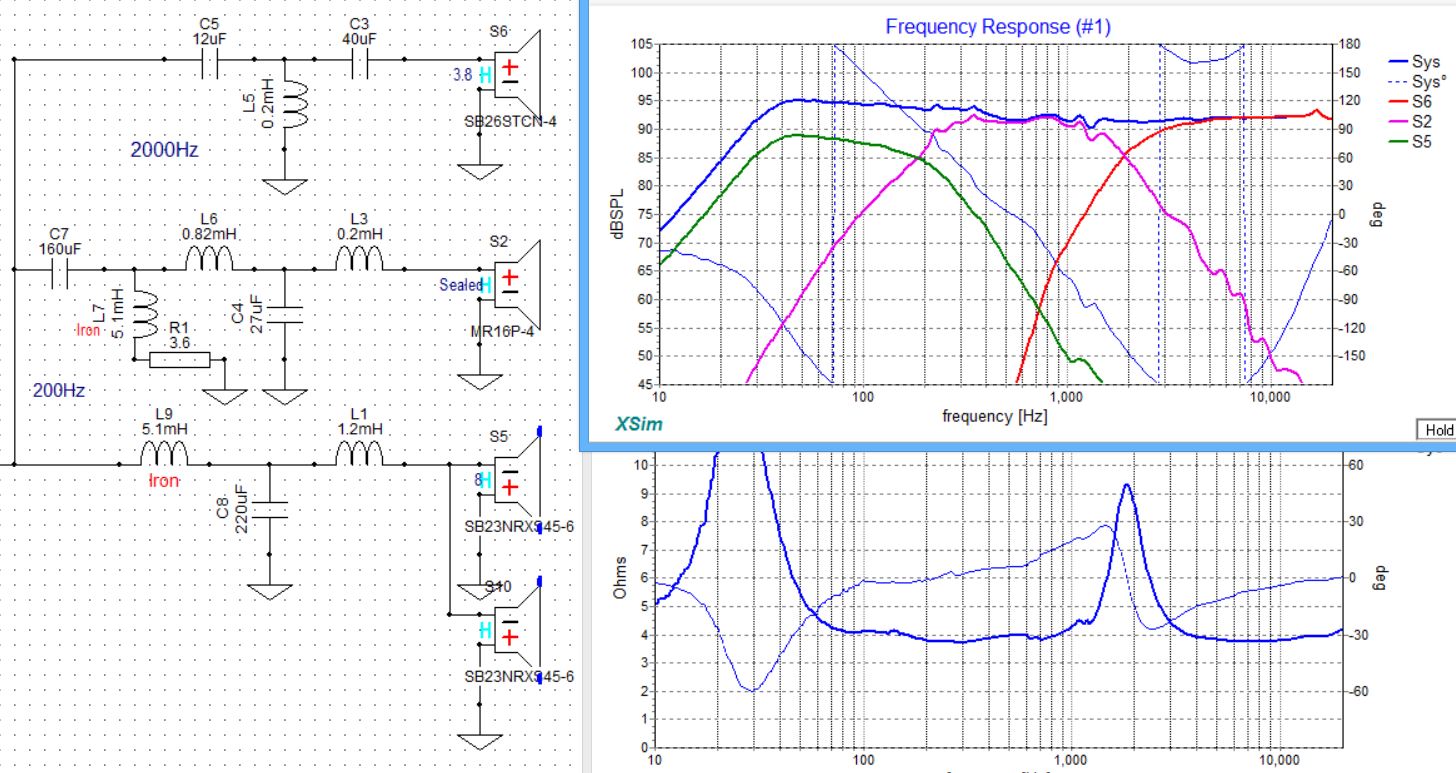

I wacked together a simulation for a similar TM-WW design using high-value SB_Acoustics / Satori drivers.
About $470/speaker for:
--two 8" woofers SB23NRXS45-8 ported in 4cuft
--Satori MR16P-4 SEALED midrange
--SB26STCN-4 tweeter(small diameter for short C-to-C)
--standard grade crossover parts
--Zmin = 3.8 ohms
Someone in the cheap seats might want to work with these parts
