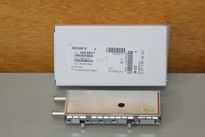

Hello to all fellow members and friends. Sony ST-SA5ES tuner came to my hands with poor sensitivity issue and after a re-alignment seems to corrected but still signal strength reports low levels. Looking around front-end circuit, I realized that IF level is too low and not clean 10.7 MHz wave. Unfortunately, SONY doesn't provide schematics of this Front End can. Is anybody from you faced same problem or has this schematic in order to investigate deeper? The P/N is 1-693-289-11. Also it is not available any more in known market places. Maybe someone of you has this available for purchasing.

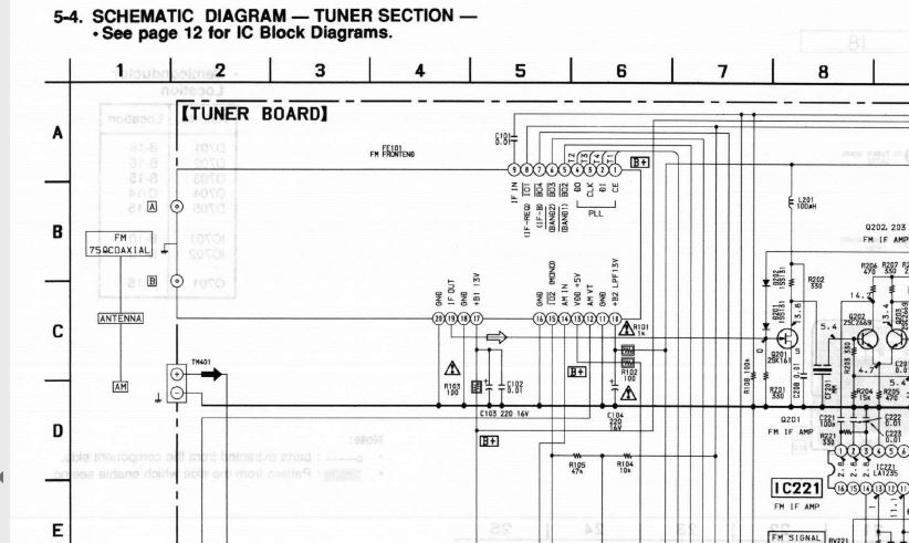

Thanks a lot for all they interested. I do have an account at hifiengine.com and I have both versions of schematics. But my units is NOT the ver 1.1 one. This is the reason I am looking for more info about Front End Tuner can. See attached photo.

Yes, schematics for my model version shows the front end as a line box only. No details of electronic circuit inside. And because of this I am looking for someone that had this sensitivity problem before.
