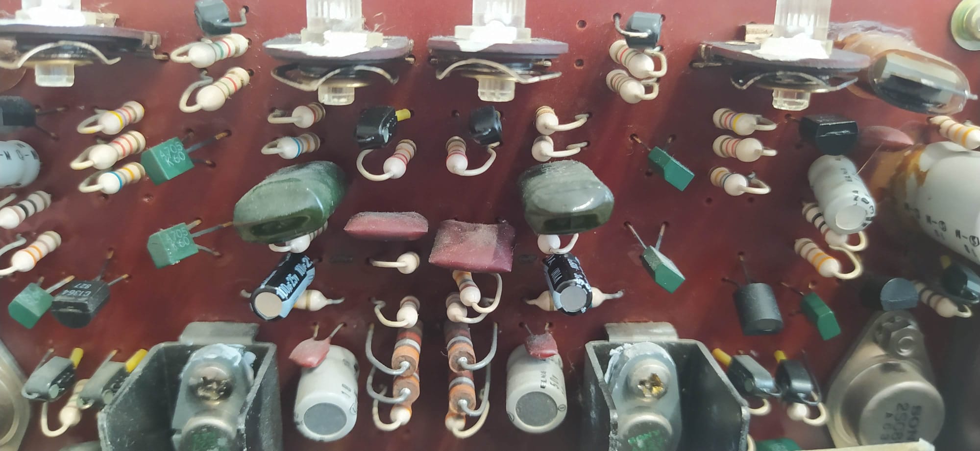

This amp is put together very tightly, so work was a bit difficult at times. It is tedious to unscrew a lot of stuff in order to access some parts: if you want to get to the output devices, you need to unscrew a horizontal bar on the upper side of the four individual heatsinks and unscrew each of them from below (two screws). Then you'll find that all the outputs are soldered into the sockets... Three (SONY 2SD88) of four were shot; the fourth (and intact) one was a SONY TX-183S. So somebody already had tried something. Obviously this transistor type (to my knowledge e.g. found in the SONY TA-3200F) seems to be more rugged. All 4 substituted with MJ15024.

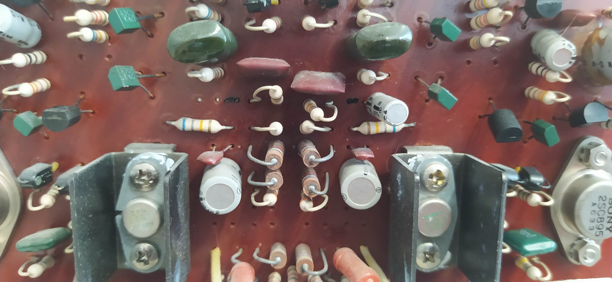

Various resistors in both channels in various places were burned. Some small transistors had visibly exploded. The two unobtainable SONY drivers in each channel had miraculously withstood the damage. After pulling the outputs, replacing the burnt resistors, and a lot of testing of the main amp on a DBT (impossible to do this without) and comparing voltages, five other transistors were substituted.
The emitter resistors of one channel were open, which was invisible, so it took me a while to understand that this was why I could not get bias voltage there. After the repairs there was still intermittent distortion in the left channel, which went away when I poked at the bias pot. This also took some time; I found a nearly invisible broken trace close to the solder joint.
After the repair (better get that done first), I started the recap with mostly Panasonic FC which I like a lot. Slightly enhanced capacitance where possible: I went up from 220uF to 330uF (higher voltage) in the emitter feedback caps of the phono and pre amp, and from 470 to 680uF in the main amp for a lower f3. WIMA films for low value coupling and feedback caps.
As the power supply is intensely regulated (it is nearly the same circuit as the 6200F, missing one transistor, but for the rest very similar), I did not up the capacitances very much (for fear of making the transistors smoke). I put in 1800uF/35V FCs instead of 1000uF/10V at C807/808 in the power supply. The main filters will be those blue United Chemicon cans with 50mm diameter and 10000uF/100V which fit exactly in the space of the old ones. C904 will be substituted by a KEMET 1000uF/200V, which will also exactly fit the clamp (25mm).
I put in new dial lamps (8V fuse type). To access them the faceplate needs to be unscrewed, then you can also recap the pre amp which is fixed to the bass/treble pots. The stereo lamp is not fixed yet (stereo works), and I'll unscrew the dial glass again in order to clean the sides from old lacquer and put on new glass stain; the light is very dim and not very green. Maybe I'll then also change the Mylar input cap of the preamp into a bigger polypropylene which I left out for the moment. I'll also change the 4 pots in the main amp to new ones and will substitute the input cap C701/751 from a 0.22 green Mylar to a 0.47 WIMA MKP4, which I also very much like. So still some work ahead indeed.

PS The photo of the restored power amp board I posted above shows two 4,7uF/50V WIMA film caps for C702/752. So you see where they sit. I changed those to 470uF/25V Panasonic FC afterwards.

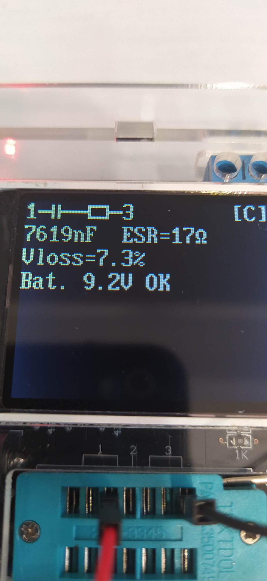

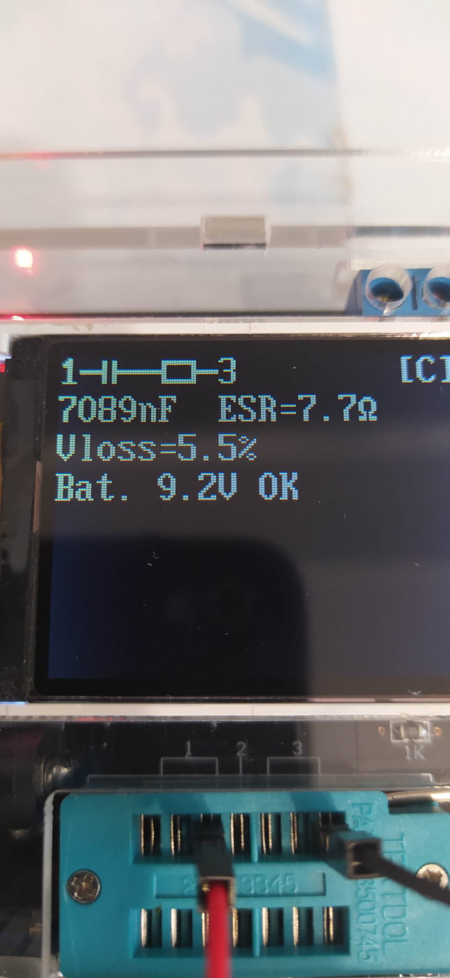

I don't have a microphone to measure RMAA. Maybe I'll buy one sometime. I currently need a desktop R2R ladder dac. I'm saving money for that. I measured these two capacitors and the result is in the photo. ESR? I replaced them with 100uF, 25V Nichicon. I only had these at home. The sound hasn't changed, it's still weird. I suggest my friend buy a set of capacitors and I will replace them all for him. Thanks again to all of you for your valuable advice. I will keep you posted on further developments.
RMAA (software) uses soundcard, you do not need a microphone.I don't have a microphone to measure RMAA.

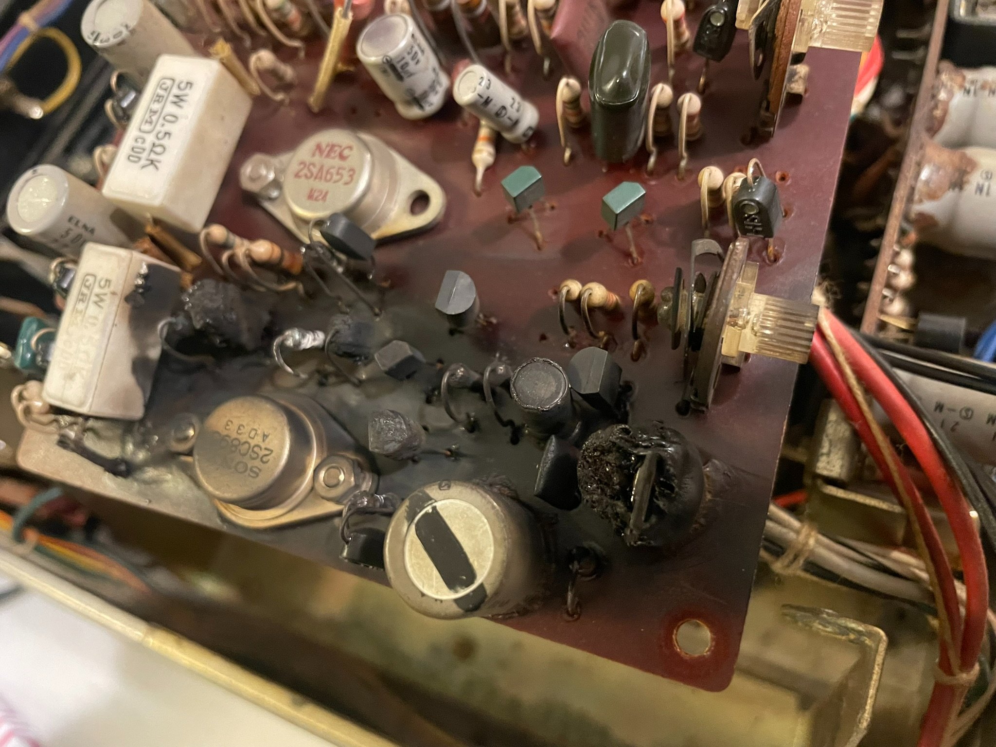

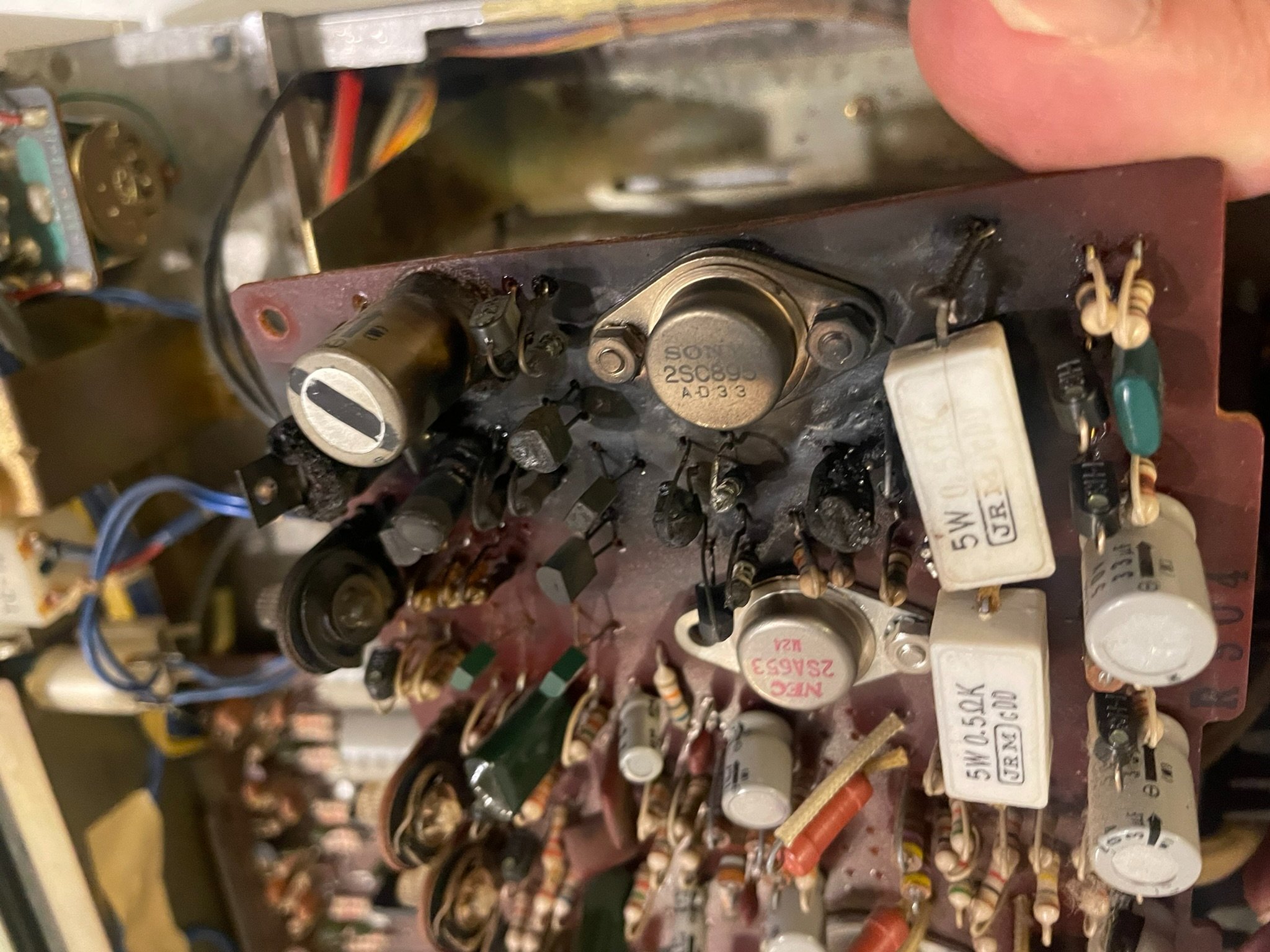

A couple of days ago, I received a SONY STR-6065 as a gift.

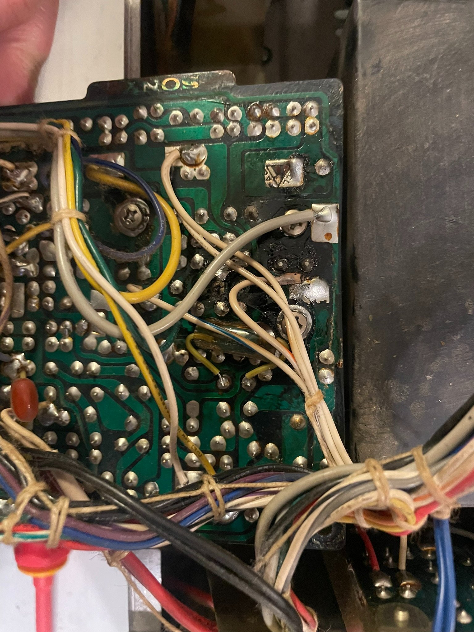

After opening the unit, I discovered that some components on the amplifier board were burnt. I didn't check the output transistors so far, but I'm pretty sure that they are defective, too.
Would you consider repairing this unit, or is it a hopeless case?

Hi Martin, what a wildfire that must have been. It‘s not hopeless at all, only much work eventually. I‘ll chime back in later.

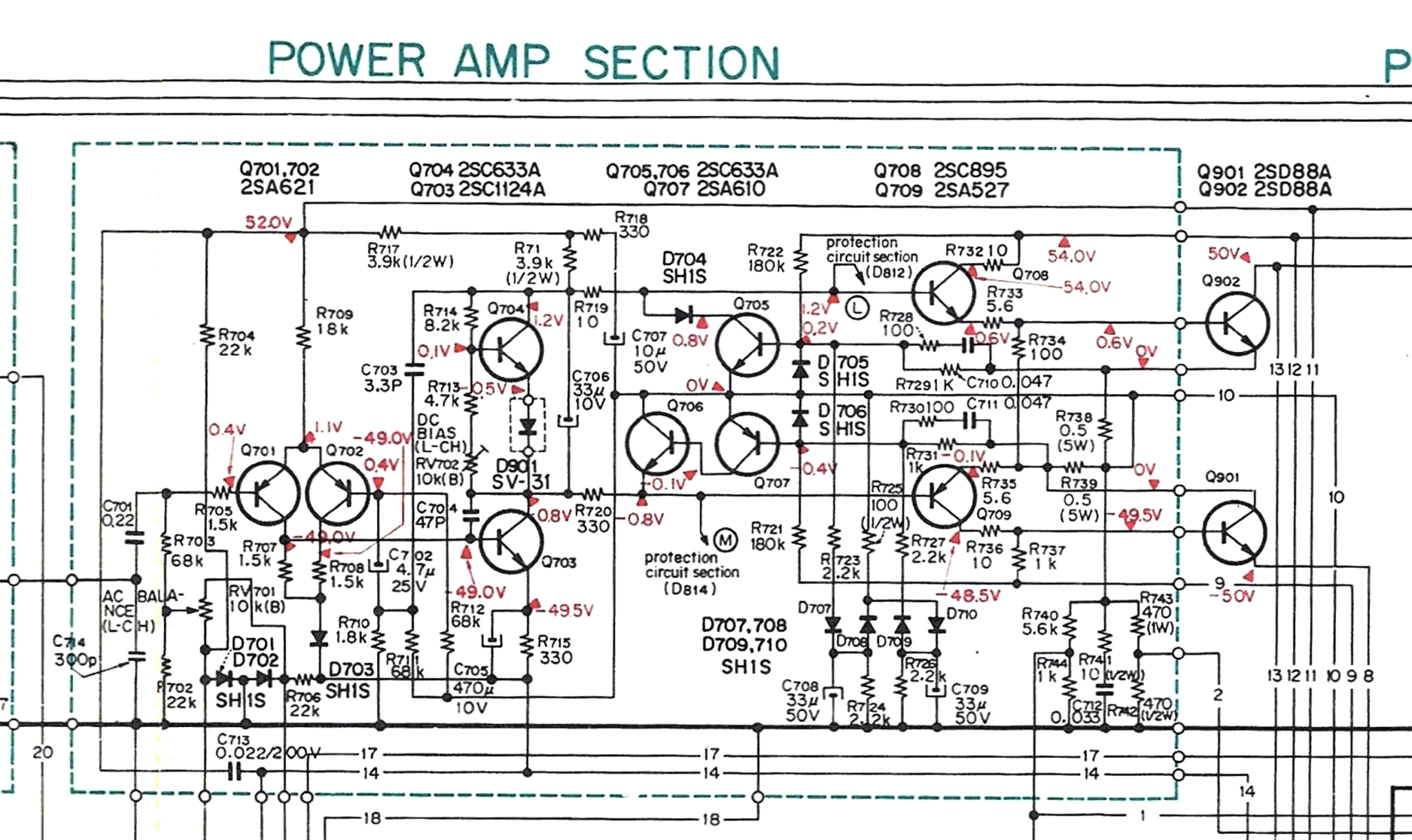

I've been following some posts on the SONY STR-6065 and there appears to be a common understanding that the output transistors 2SD88 can be replaced with MJ15024. As far as I have understood, the diode SH-1S can be substituted with 1N4004. But so far, I don't really know what to do with the 2SC895.
Thank you for your most appreciated help in advance.
By the way, do you have a service manual that contains pages 45 and 46 (power supply) as the copy I downloaded from Hifi Engine is incomplete.
