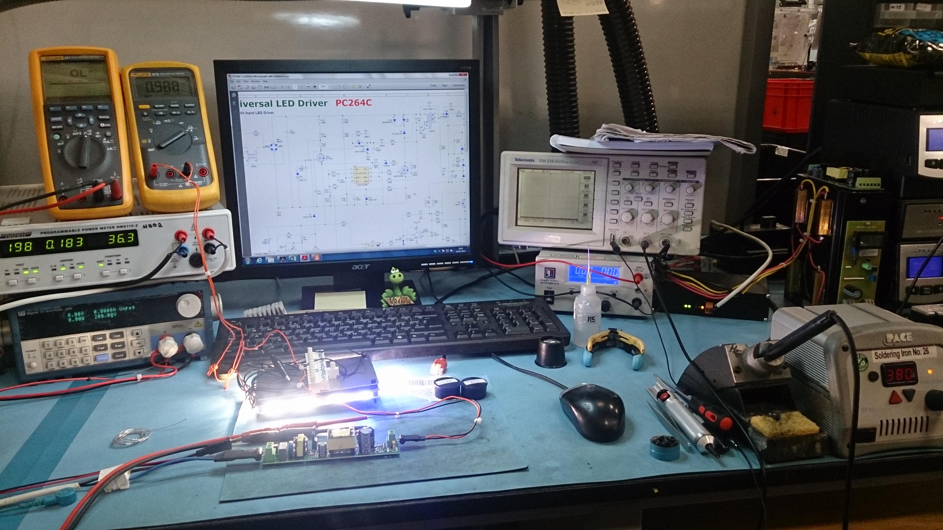

And this is my setup I have for diagnosing
I could ask for my lab guys at work for help, but they always seem to have the attitude of we are better than a tech.

That is part of my work setup, home setup is a meter and soldering iron.
