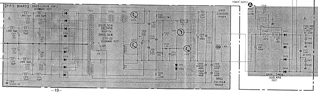

Hi All,
This is my first post. I have some very basic – perhaps inadequate - trouble shooting skills, so please be patient.
As a matter of course, I have replaced all the electrolytic capacitors C906, C911,C912, C913,914, C915,C916,C917,C918 but there is still no output from this supply. Voltage across coil L901 measures 330v DC (320V DC)
All resistors R901,902,903,904,905,906 measures ok out of circuit and Transistors Q901,902,903,and 904 measures ok in circuit.
It seems that the oscillator has started but oscillation cannot be maintained. The final voltage across C and E of Q902 is 14.3mv (40V) and C and E of Q901 is 0.665V (31V)
The voltages in parenthesis are reference voltages from the Sony TA-AX4 which uses a almost similar power supply.
The value of the installed R906 is 30 Ohms and not 22 Ohms as indicated in the circuit diagram, I do not know if this will cause the problem.
The amplifier did power up intermittently, approximately 1 time out of 100 power ups. During the time that it powered up normally, all the voltages in the power supply measures correctly.
Thanks for reading and any help appreciated.

As I was the owner of an Authorised Sony Service Centre for almost 30years, Sony did not recommend repairs for this type of power supply as there is a serious safety issue involved with repairing these unless highly qualified to do so. There was no technical backup and a replacement item was recommended. That was many years ago so I doubt there is any working stock left.
All I can suggest is check capacitors and the feedback loop Q902/2 etc. Mind your fingers as the capacitor (C419) stays charged with a lethal voltage, for some time!
I recommend pulling and testing all semis out of circuit. If I recall, high voltage transistors of this era were not so good, and a common cause of failure.
Power Supply Repaired
Thanks to those who replied and sorry for the late response as I was waiting for parts from farnel.
For those who are interested, two film capacitors (C907 and C908) were replaced and the power supply can now maintain oscillation 😀

Simple, I came across this site and learned that the two capacitors were responsible for the oscillation of the power supply:
Free Translation and Professional Translation Services from SDL
Since both of them were .33uf, there were basis for comparison and I found that one of them were faulty using the capacitance range of my trusty sanwa analogue meter😀
Regards
