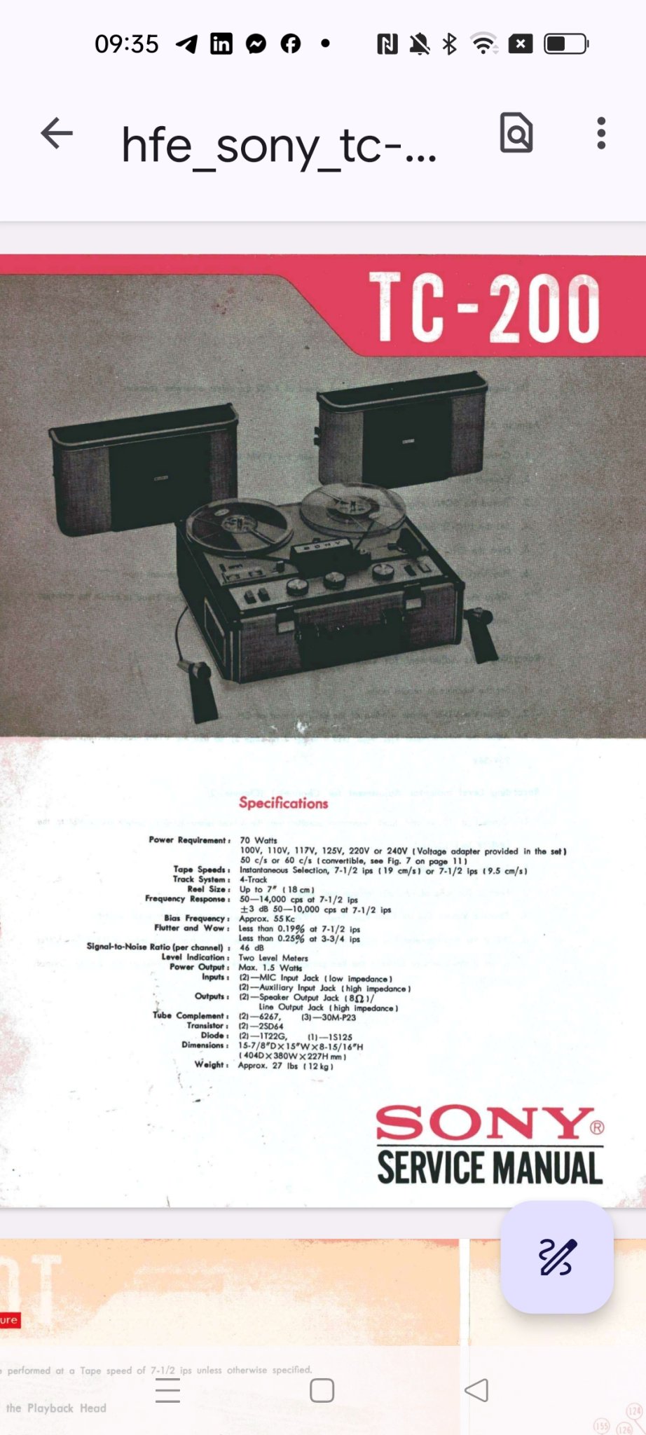

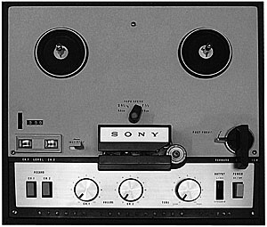

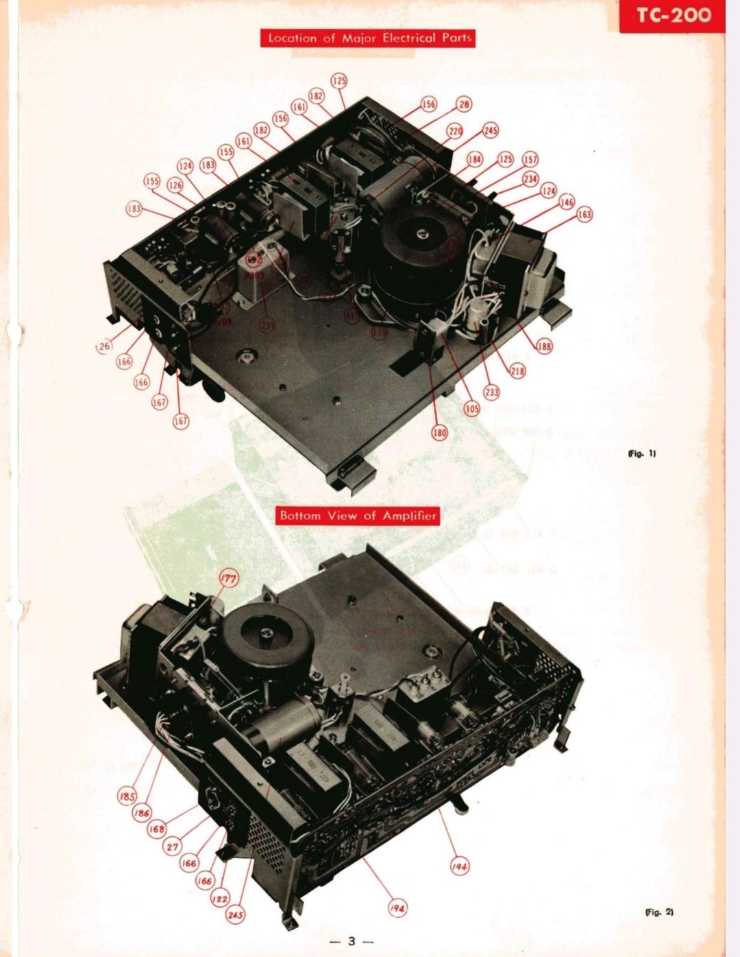

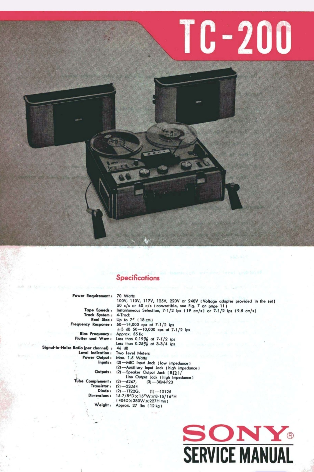

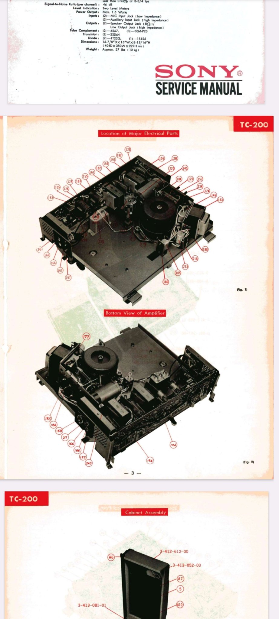

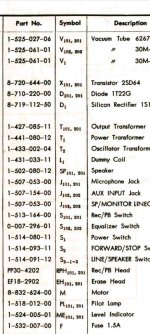

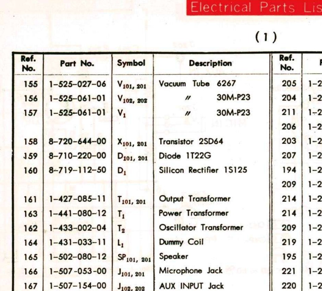

I have a Sony TC-200 R2R that I want to use the power supply and output transformers for a valve amp build.
Specifications
Track system: 4-track, 2-channel, stereo/monaural system
Reel size: up to 7 inch reel
Tape speeds: 3 3⁄4 7 1⁄2 ips
Wow and flutter: 0.19% (7 1⁄2 ips)
Frequency response: 50Hz to 14kHz (7 1⁄2 ips)
Signal to Noise Ratio: 46dB
Output power: 1.5 watts
Semiconductors: 2 x 2SD64, 2 x 1T22G, 1 x 1S125
Valve complement: 2 x 6267, 3 x 30M-P23
Dimensions: 404 x 380 x 227mm
Weight: 12kg
Year: 1968
People often use the TC-500.

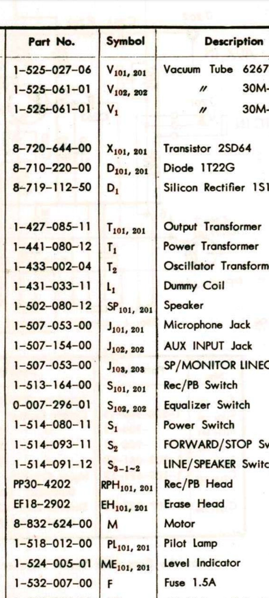

The power supply part number is 1441-080-12
The output transformers part number is 1427-085-11
I am hoping that the opts are as good as the TC500
The speaker part number is 1502-080-12
Are the speakers the same as the TC-500 and worth using?
I was wondering about building an RH84 or Zen etc.
Has anyone used the transformers and power supply for a build?
There is further info here on hifi engine
https://www.hifiengine.com/manual_library/sony/tc-200.shtml

You could build something using the stock tubes, as described in the AK thread, but the transformers are not suitable for the designs you're considering.I was wondering about building an RH84 or Zen etc.
The tubes used are equivalent to the 30A5. According to the data sheet, they typically run with only 100v on the plate and OTs with a 2.4k primary and produce ~2w. Typical SE EL84 / 6BQ5 designs run ~300v on the plate and OTs with a 5k primary. Also, the stock PT heats the tubes with 30v and the EL84 runs on 6.3v.

As I mentioned earlier, presumably the OTs are designed to work with the stock output tubes so their primary impedance should be ~2.4k since that's the load specified in the tube data sheet. You could use them with other tubes that work with a similar load.
But the OTs are also designed to be used with tubes that only put out ~2.1w max (@11% distortion) so they won't be suitable for tubes that put out much more power than the stock ones. Any alternative tube that might work will require you to use a different power transformer and will only make the project more expensive.
Your best bet is to use the tubes it's designed for as was done successfully in the link in Post #2 above. Then you can also use the stock power transformer. There's no reason why you can't build something decent using what you already have.
