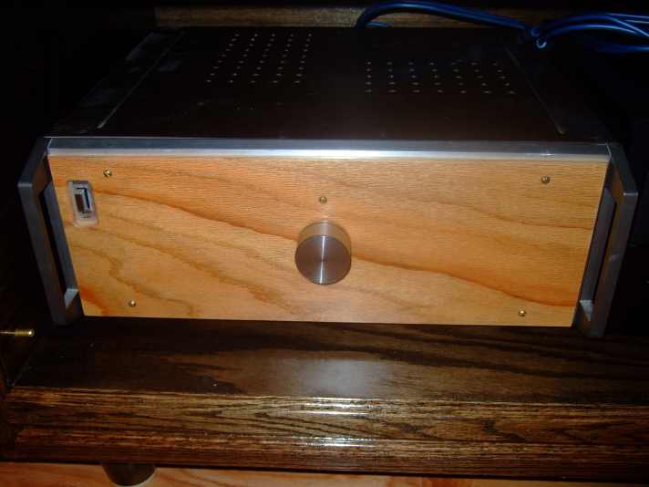

I humbly recommend those transformers. I used them in a RH84 amp. More than a few times I'd tried to sell the amp just to fund other projects and every time it wouldn't happen I was sort of relieved. I keep putting it back into use simply because it sounds great. Pictured here: Rotel RCD-955AX ---> RH84 ---> Yamaha NS344. In the end I'll probably just keep it for myself...
EZ81 rectifier, 6P14P-EV output tubes, Hammond 193C choke.
