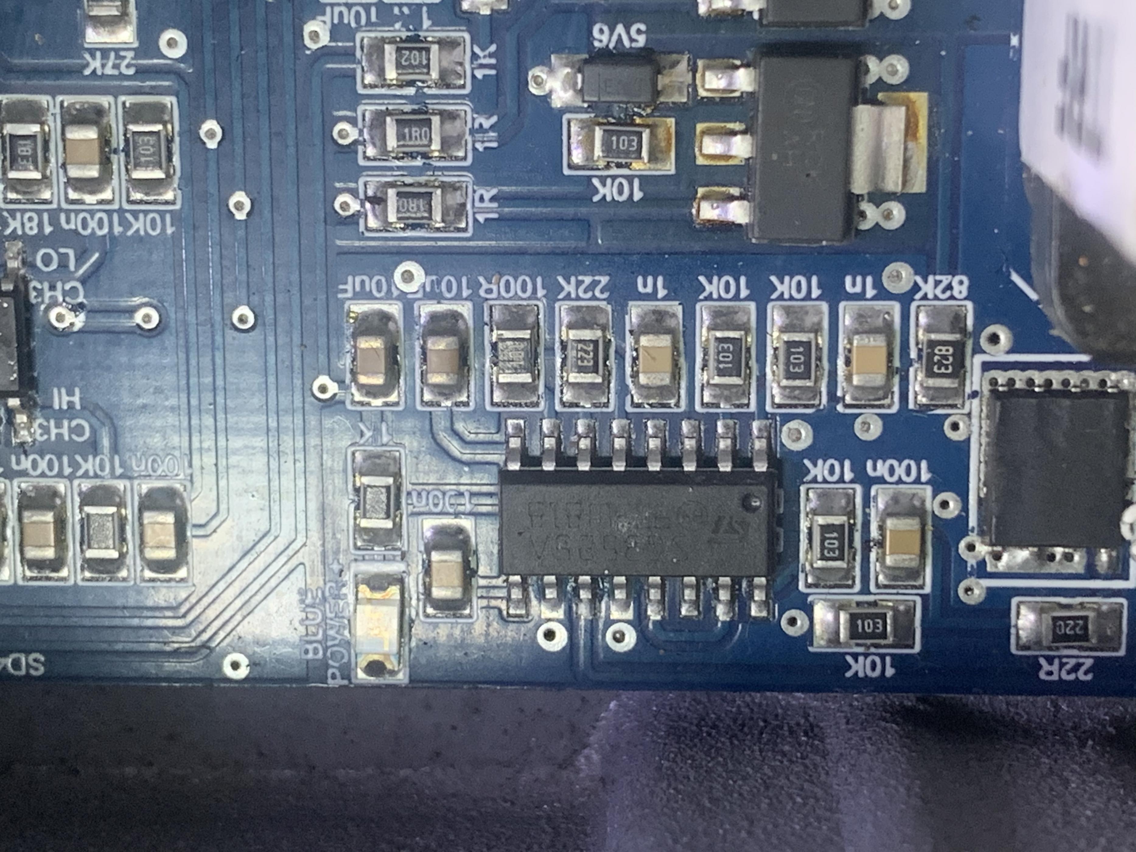

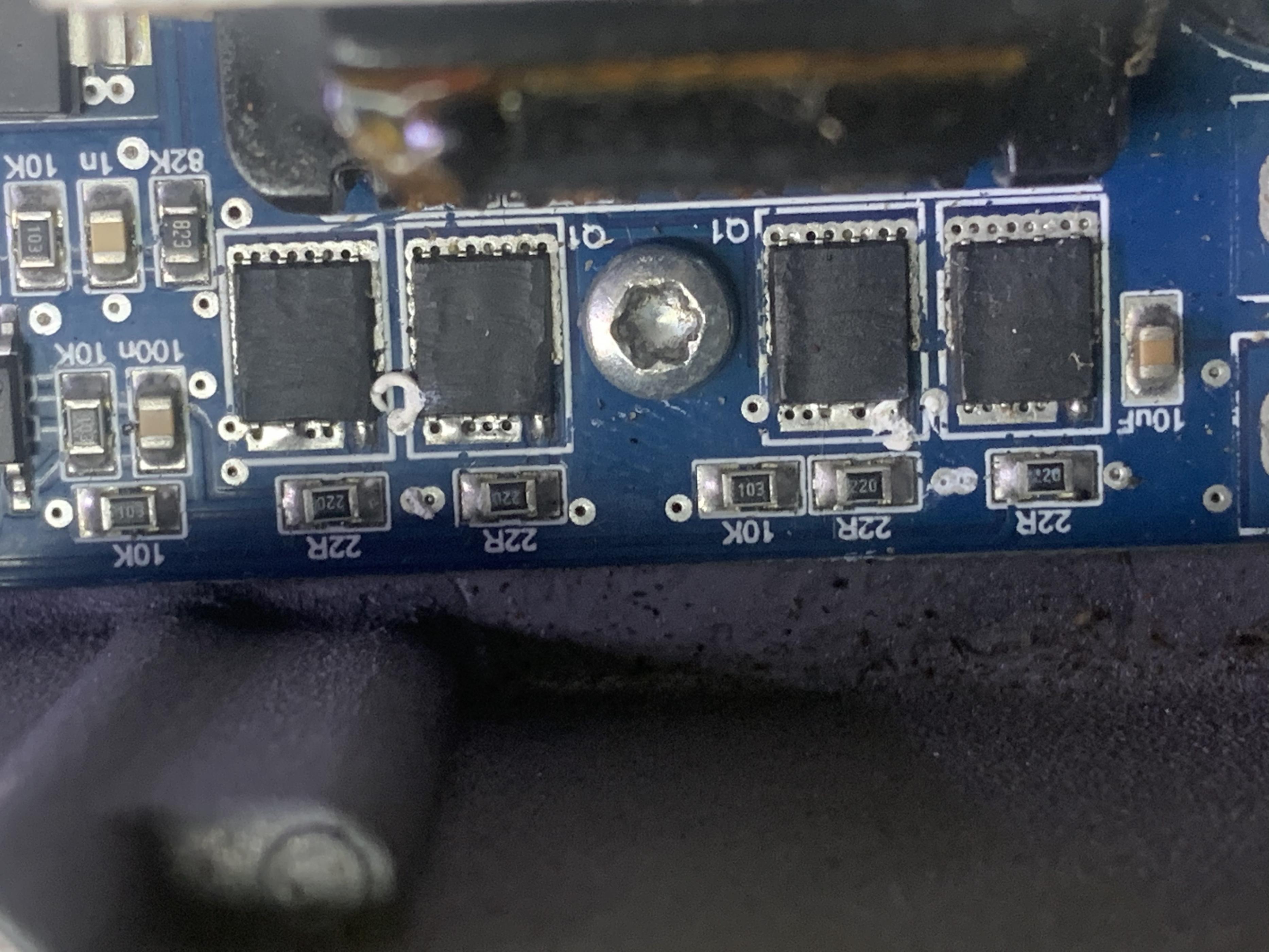

Someone has a reference to the TDSON-8 encapsulation mosfets in the power supply section of a 4-channel sound digital 800.4d evo amplifier, they are scratched.

You got a pic of the FETs in question?
I don’t know what they are, but I repaired one recently, luckily the PS was intact. I did take some notes, and I belive I can prolly add four TO-220 FETs to the sink adjacent to it and get it going again. The one I worked on had a pwm sg3525.
