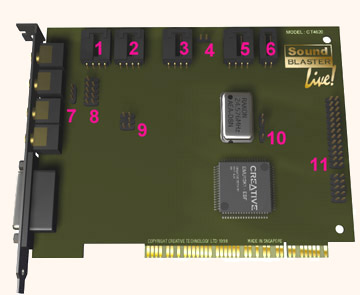

I've installed an old SoundBlaster Live! Pro sound card into my system and was wondering if there was a way to connect it to the front panel thing.
The front panel thing is currently connected to my motherboard's on-board audio thing. (2 rows of 5 pins) Does the SoundBlaster have somewhere I can connect these pins to? I just need Mic and Headphones... it's not necessary but it'd be nice to have access to this from the front of my computer.

Hugo sort of answered your question, but not quite.
I scanned through a couple of manuals on the creative website for the SBLive card, and it didn't quite give enough information. Take a look at your card. Does it have what may be called the MB_PRO connector on it? This would be a set of pins configured in the same 5x2 pattern as the motherboard. If so, I think that's what you want to connect to. Otherwise, you're probably looking at trying to reverse engineer the connector at the back edge of the card.

Most variants of the SBLive have a "MB PRO" connector on them, which should be the same as the connector on your motherboard, that the front panel thing is connecting to currently. It is a 2x5 connector with only 9 pins. It is number 8 on this picture, which I unabashedly ripped from Live! Center (your card may have a different layout:

Thanks a ton guys.
The MB_PRO connector is what I'm looking for.
However, it seems I don't have the Pro version, or something. I have the SoundBlaster Live! 5.1 This doesn't appear to have the connector, so i guess I'm just SOL. 🙁
